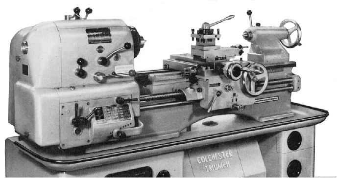

Above - a 1950s Triumph

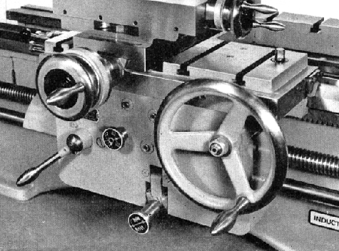

Continued: Double walled but open at the bottom, the apron was unable to run its gears in an oil bath; the power feed controls followed standard Colchester practice of the day being concentrated into a single lever that slid along the lower edge of the apron and was then lifted into one of two slots to engage either power sliding or surfacing. raising the lever automatically locked the engagement, whilst stopping the feed merely required the lever to be pressed downwards; unfortunately, the heavier the cut being taken, the greater the load on the mechanism and the more massive the effort required to disengage it. However, at least it was a positive action and did not require a knob to be unscrewed in order to release a clutch. Although not fitted to the first machines, most Triumphs had a cleverly-designed safety over-load ball-bearing "clutch" built into the powershaft feed to protect the apron gears; the leadscrew drive could be disengaged by a sliding gear and was only intended to be used for screwcutting. Lathes with a gap bed (as usually specified for the home market) had their carriage traverse handwheel on the right side of the apron and leadscrew clasp nuts on the left and were fitted with T-slotted saddle arms whilst on straight-bed versions (often listed in handbooks and sales catalogues as "Dominion" models) these locations were reversed and the saddle arms left flat. The last development of the Mk. 1 (before the advent of the completely different Triumph 2000) was updated in line with the Student and Master models in having a completely redesigned and much improved apron: for the first time the bottom of the assembly was enclosed, allowing the gears to run in an oil bath (although not all models had the sight-glass level indicator showing that this feature was utilised) and the selection and engagement of feeds was separated with a push-pull knob, that protruded from the middle of the front face, being to used to select the required feed with the engagement by lifting a lever at the bottom of the apron. The engagement lever had a threaded barrel (often found jammed tight) which could be screwed in and out to alter the "overload" point at which the drive automatically disengaged to protect the apron gears. By using a positive stop on the bed, and arranging for the feed to be "just held in", this formed a useful automatic disengage device by which means repeated runs could be made up to a shoulder. The "safety" apron continued to be used on the Mk. 2. Unlike early versions of the Student and Master, the Triumph's No. 3 Morse taper (later No. 4) tailstock barrel was locked not by that pet hate of the author, a slit in the casting closed down by the action of a screw thread but with a proper "split-clamp" that acted directly on the barrel at a point just before it emerged from the casting - a system that continues to work well no matter worn the components become. Although the early catalogues contained no mention of an option for dual inch and millimeter-engraved barrels some machines were so fitted and mixtures of inch, millimeter and dual-marked barrels have been found on dual English/metric and English-threading versions, presumably because that is what the original customers ordered. Later machines have dual-engraved barrels as standard with hardening on the outside and in the Morse taper - the latter also being fitted with a tang knockout slot. An option was also available for dual-marked English/metric micrometer dials to be fitted to the compound slide rest feed screws and, although the earliest catalogues from the 1950s omit any mention of them, their cover pictures shows a machine so equipped. The dual dials were beautifully made, with a sliding cover to reveal the inch or mm scales and particularly clear markings on a satin-chrome background. A version of the Triumph was sold in the USA and Canada as the "Clausing-Colchester 15-inch" this lathe had an English-threads-only gearbox but a hardened bed as standard, straight or gap, with a choice of 30" or 48" inches between centres and, on the Mk. 2 versions, an oil-bath apron version of the single-lever "Safety" apron..
In this picture the distinctive arch of the bed is clearly visible - as is the short cover over the changewheels showing that this is an early lathe with the motor bolted to the back of the bed. Later versions, with the motor inside the cabinet on a hinged plate, had a shorter chip tray that allowed the gear cover to extend downwards and pick up a mounting stud on the end face of the stand.

The apron was double walled but open at the bottom, so precluding any chance of the gears being run in oil; the power feed controls followed standard Colchester practice of the day being concentrated into a single lever that slid along the lower edge of the apron and was lifted into one of two slots to engage either power sliding or surfacing. Lifting the lever automatically locked the engagement whilst stopping the feed merely required the lever to be pressed downwards; unfortunately, the heavier the load on the feed the greater the effort required to disengage it, but at least it was a positive action and did not require a knob to be unscrewed in order to release a clutch.

"Safety" apron as fitted to the last of the original geared-head Triumph lathes. The push/pull knob to select either power sliding or surfacing was in centre of the apron's front face and the engagement lever, which could be adjusted by turning its handle to vary the load under which the feed would automatically disengage, in the middle of the apron's bottom edge. Interestingly, the two pictures left and above are the only ones known to show a "black dial" toolroom-specification
