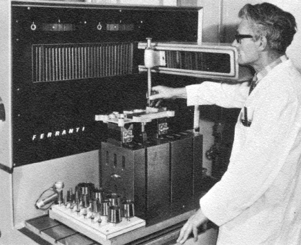

A Ferranti visual tester being used to check inner plates for flatness of a sample from a production batch of screwcutting gearboxes

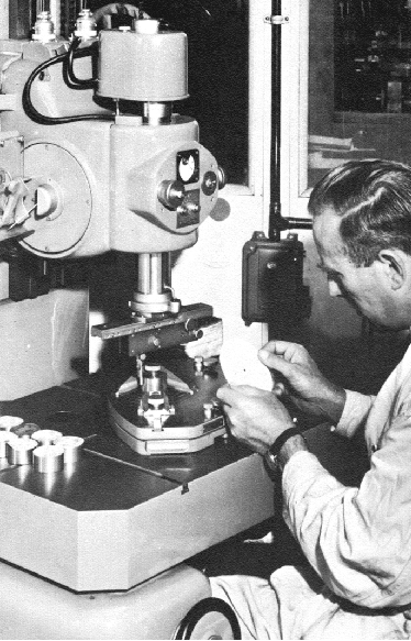

Inspecting the roundness of a Mascot spindle with a tester that produced a vertical linear read-out.
The Rank Talyrond roundness tester in action and a sample of the read-out chart.
