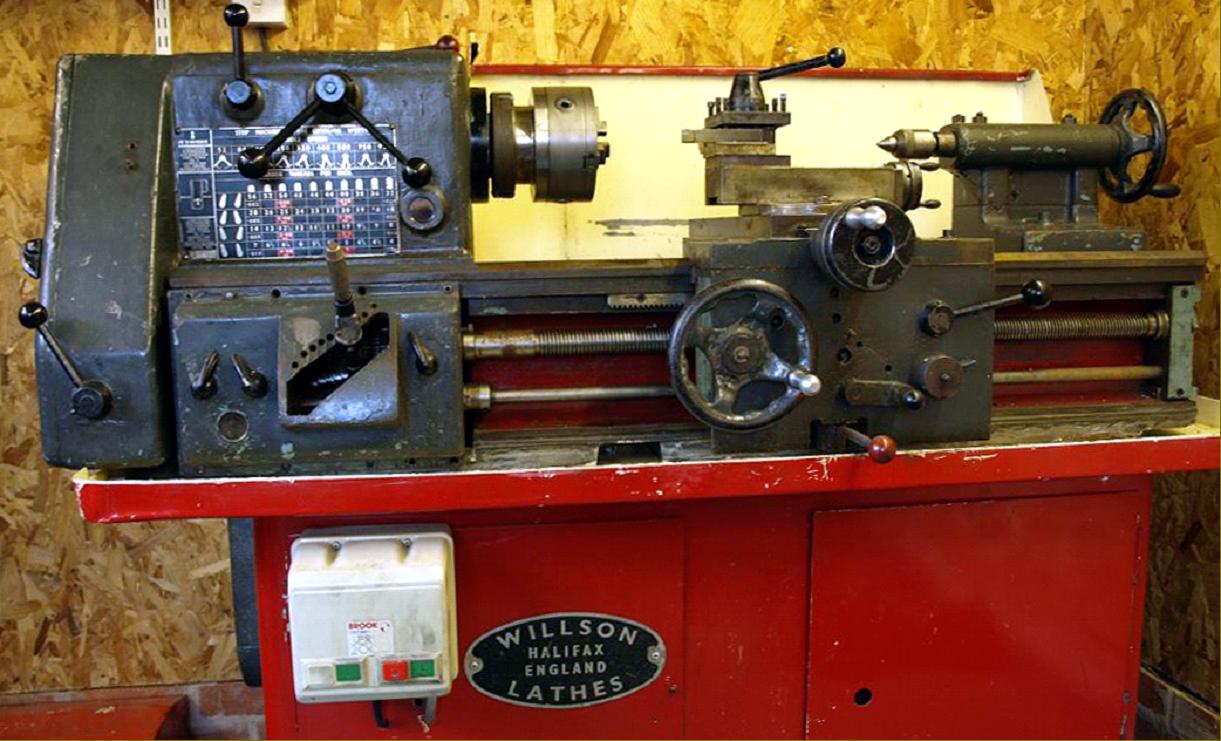

A rare Willson Capstan Slant-Bed with a bed-mounted capstan unit and fitted as standard with a 2-speed motor that gave speeds of 9, 39, 78, 715 and 1430 rpm.. A 1.5-inch diameter capacity lever-action collet closer was mounted on the headstock spindle nose. The capstan unit had a maximum stroke of 7-inches and its turret accepted tooling with 1.25-inch diameter shanks.

Late-model Slant-bed with a sector-shaped over the spindle-speed levers and a modified screwcutting gearbox.
