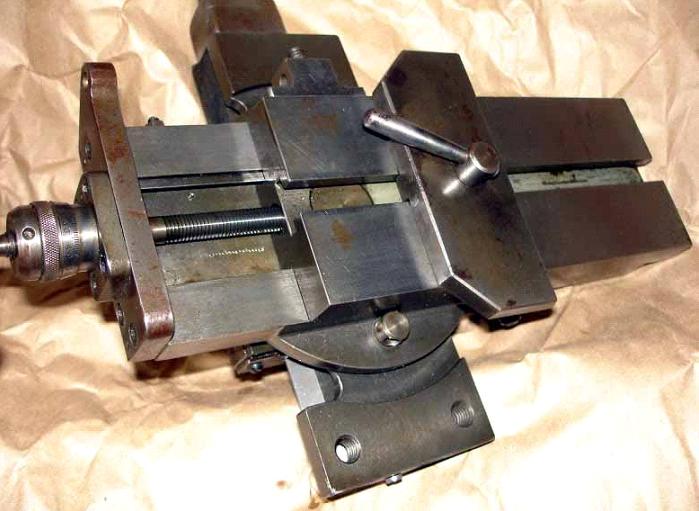

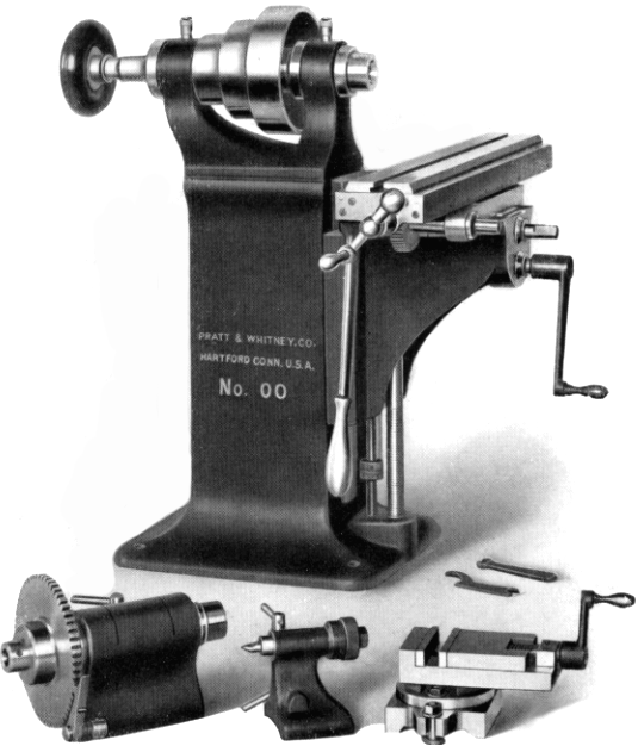

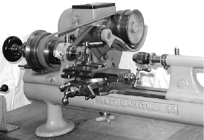

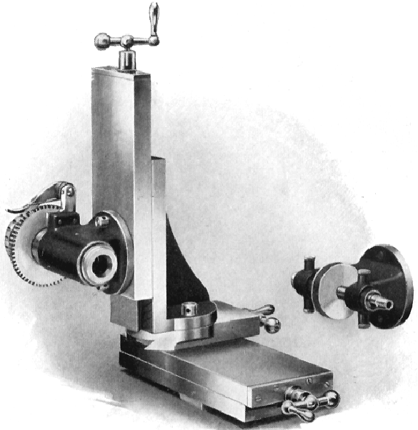

Unusual in that, instead of being adapted to fit the standard slide rest, the Pratt & Whitney swivelling vertical milling attachment was complete with its own compound slide unit - and thus could be used on lathes fitted with were only equipped with the simpler types of hand-tool rest.
The slide carried an indexing unit, of the same collet fitting as the headstock, designed to hold small components whilst milling cutters, diamond laps or grinding wheels, held it the headstock spindle, were applied to them.
A separate high-speed cutter head, driven by an extra pulley on the countershaft and designed to allow work held in the headstock spindle to be machined, was provided as standard.

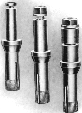

Arbors for use in the milling slide indexing head.

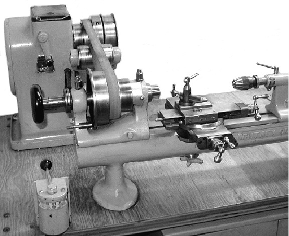

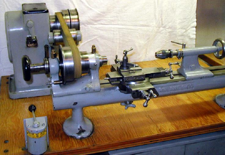

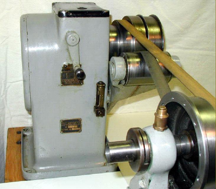

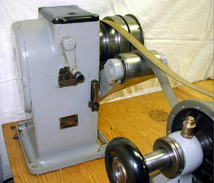

Another view, showing the two-speed gear selector on the front of the gearbox housing

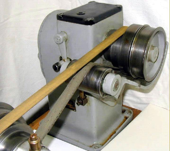

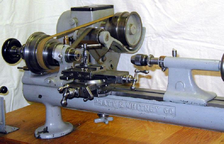

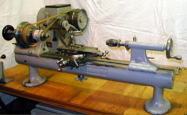

A Pratt & Whitney No. 3 with the maker's beautifully-constructed countershaft holding a built-in 2-speed gearbox - similar in some ways to the system used on the Swiss Simonet precision lathe.
If there is one thing that flat belts like, it's plenty of "wrap" onto the pulleys -  which was exactly what the wide, heavy-duty tensioning  system provided on the installation above.
Pratt & Whitney No. 3 Lathe Combined countershaft gearbox drive unit

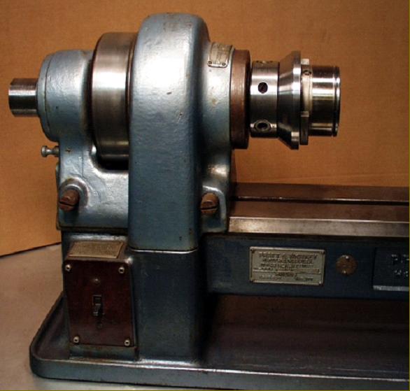

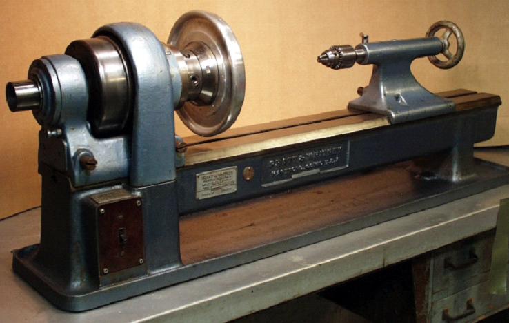

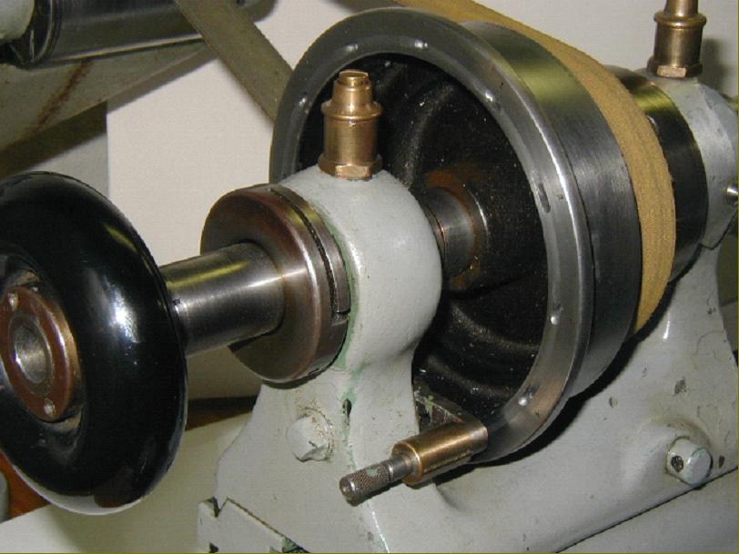

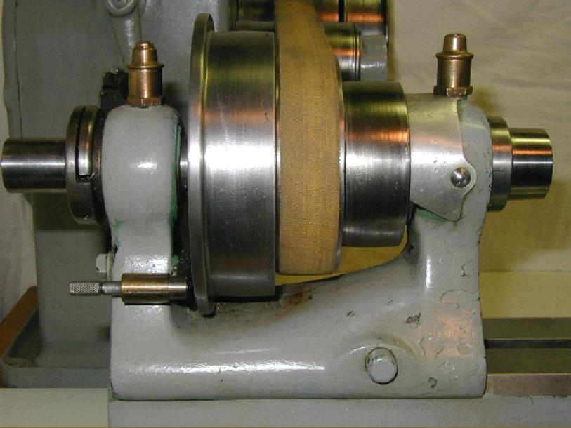

Surprisingly, instead of a double row of 32 and 60 holes, the indexing arrangement on the headstock pulley is confined to a single circle of just 12 holes.

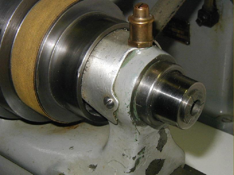

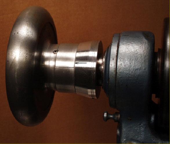

The headstock spindle on this model was not threaded, and accepted only collets.

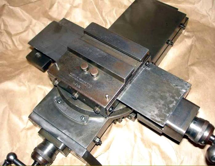

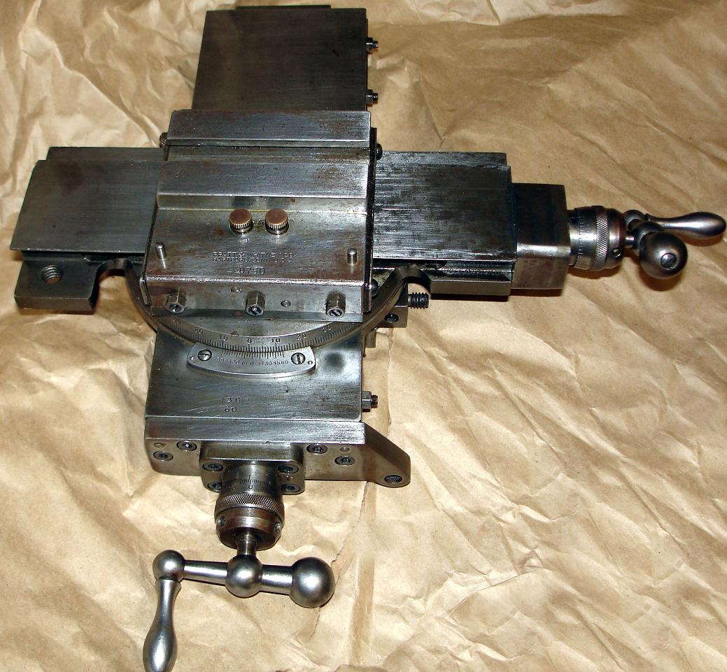

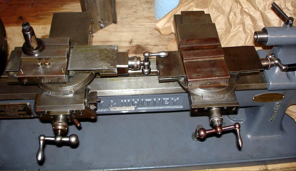

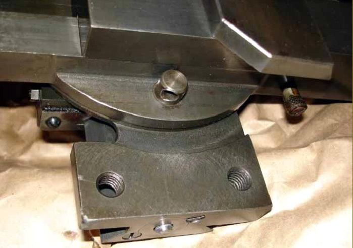

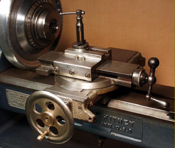

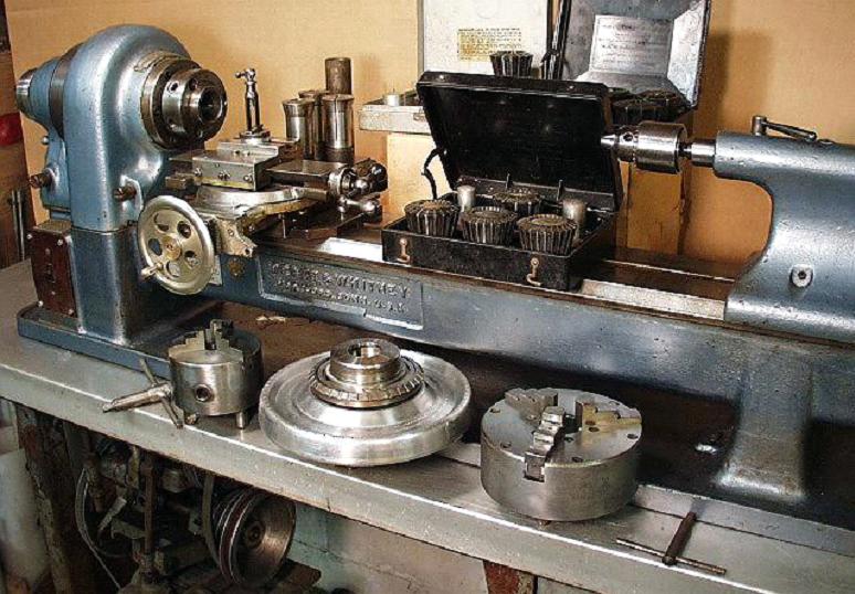

Early and later Pratt & Whitney compound slide rests. That on the left is from a 3c and on the right from the older No. 3. While both follow the same basic design, that used on the 3C has a slightly longer travel on the top slide, and usefully more on the cross. Other refinements include a better oiling system, larger micrometer dials, ball bearings thrust races and travel stops for the cross movement

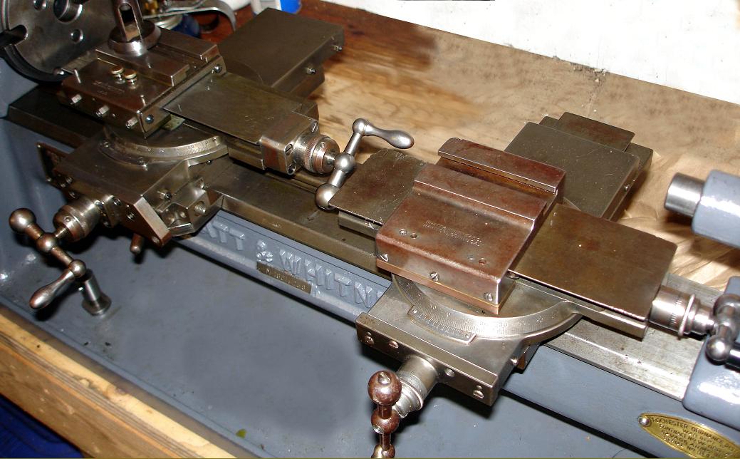

Above and below: a late-type compound slide assembly from a 3C
