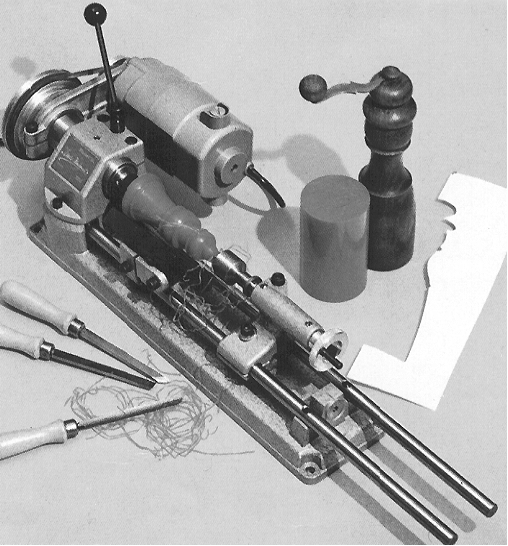

Part Long-bed wood turning kit with turning tools, drive centre (Part 1205) and extra-long bed rails (Part 1395). Although not very clear from the picture the T-rest being used is the fully-adjustable 4.75-inch long Part 1202.  A completely different 2-inch long triangular rest, Part 1201, was also offered. Described by the makers as a "simple rest" it had its front edge on centre height and was non-adjustable.

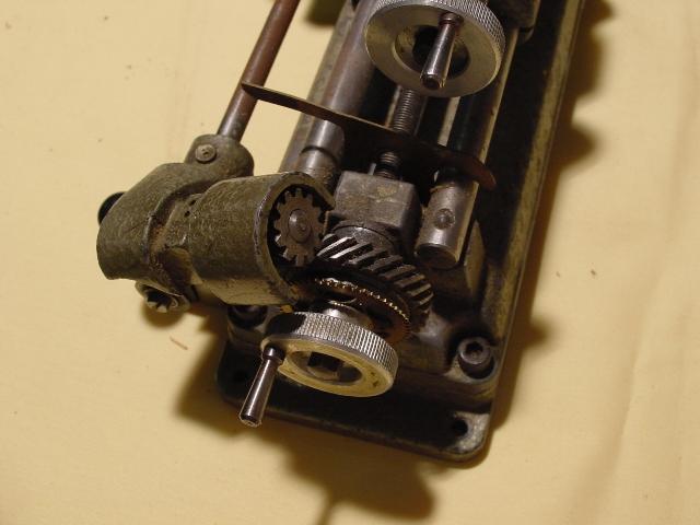

Here the little Unimat is being stretched to the limits of its strength and capacity - aided by a belt-driven longitudinal-feed attachment. This was a relatively complex accessory - and beautifully made. At the tailstock end of the lathe a worm and wheel mechanism (covered by a flat plate in the picture) provided a further step-down ratio - the ball-ended engagement lever for this unit can be seen protruding forwards in line with the tailstock.
Tailstock end of the well-made power-feed unit

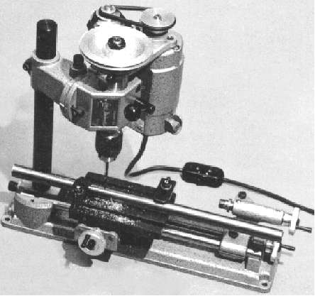

Here the milling table is being used to clamp a long, round bar whilst the vertical attachment is used as a high-speed drill.

This illustration shows the vertical milling and drilling attachment in position. The headstock and motor drive assembly are removed from the lathe and fastened to the end of a solid steel bar. The bar is then located into and locked in the spigot hole left by the headstock. To provide a vertical feed, the headstock spindle assembly is arranged to slide in and out of the headstock casting, return being by a large coil spring..
