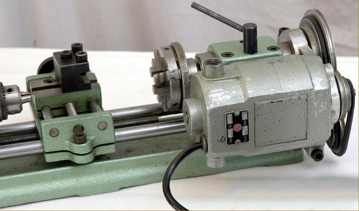

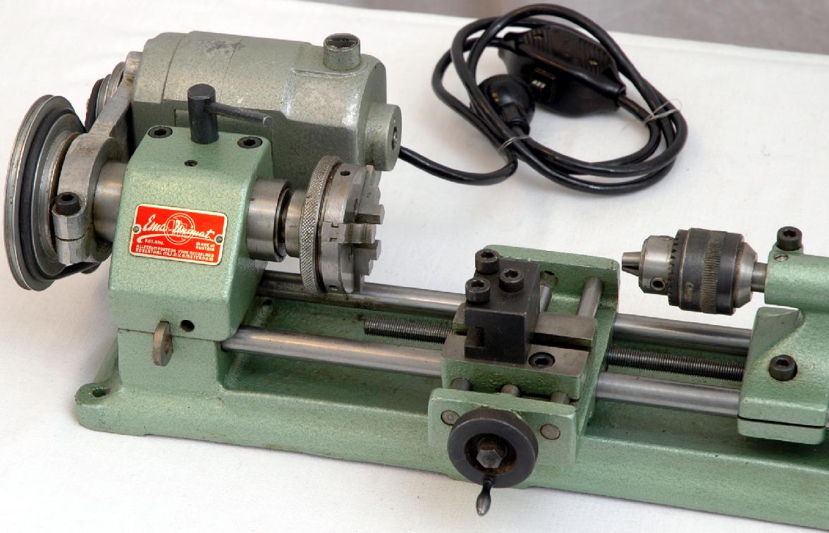

This version was the first to incorporate a means of aligning the headstock with the bed bars. Upon first assembly the base casting and headstock were jigged and a small vertical slot cut across the junction of their front faces. When the faces were correctly aligned it was possible to insert into the slot a small "setting piece" - a disc washer given by the handbook as being 0.748" in diameter.
Unimats of this age were given a more robust carriage assembly with the whole of the casting, including the front and back walls through which the way bars passed, noticeably thickened.
Note the repair to the tailstock - a weak point on these lathes where the to lock the spindle a slit in the casting is closed down by a set-screw
