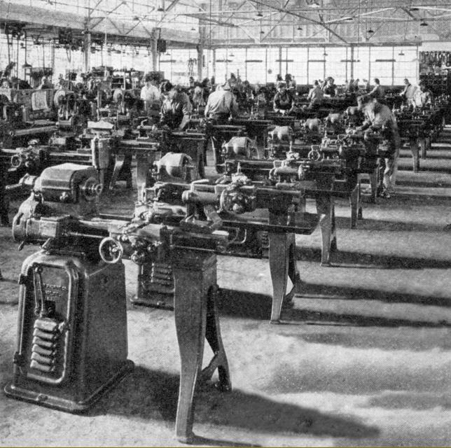

Circa 1943-1944 final assembly and checking
1943-1944. Possibly the station at which beds were fitted to cabinet stand and their alignment checked
Finished 12-inch lathes ready for dispatch
