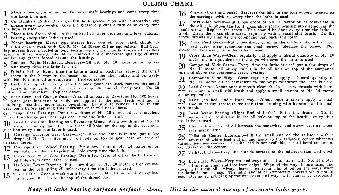

If the lever mark has disappeared, or not present, the level should, almost certainly, be half-way up any sight glass. If unsure, use enough oil to half-submerge the lowest gear in the housing - this will give enough "oil fling" to lubricate everything without overheating through excessive churning.

Unless specifically recommended by the maker for a particular part avoid using grease on any part of the machine - it will attract chippings and turnings like a magnet and do little good. What appear to be a  grease nipple on a machine tool is invariable intended for oil - the exception being headstock spindles running in ball or roller bearings where, generally, grease is used.

A typical oiling chart for a bench lathe
