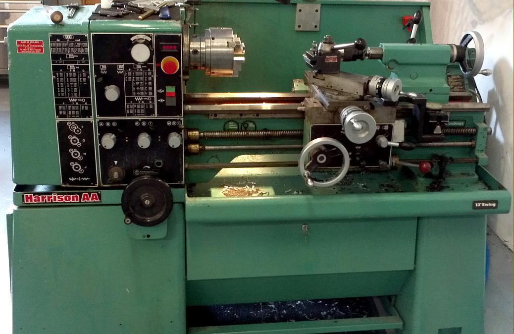

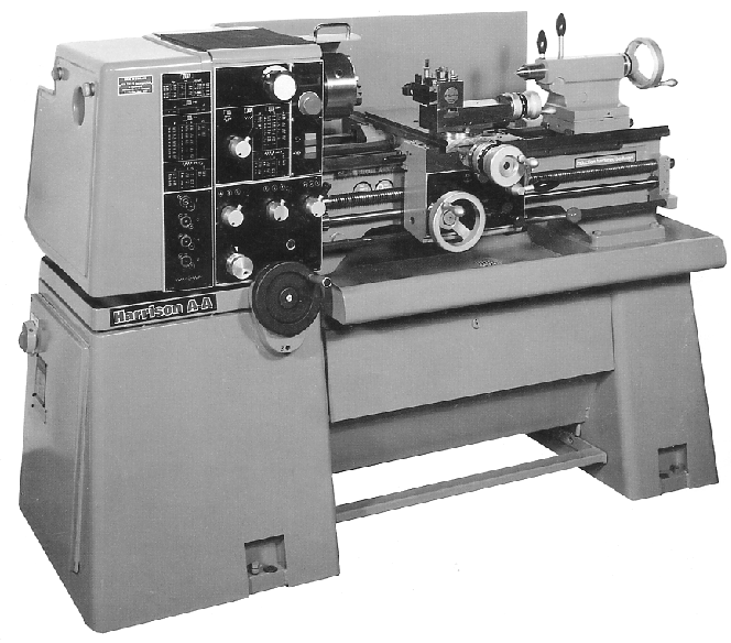

With a 330 mm (13") swing and admitting 635 mm (25") between centres, the Harrison VS330TR was a small, very well specified toolroom-quality lathe constructed to International Precision Lathe Standards ISO R1708 and BS 4656 (UK) and DIN 8605 (Germany). For export markets it was also listed as the Model AA, and replaced the previous variable-speed drive Harrison lathe, a re-badged Colchester Chipmaster. The VS330's main feature was a quiet-running mechanical variable-speed drive unit that, in combination with gears and an "inverted chain" drive in the headstock, gave three separate overlapping speed ranges which equated to: 35 to 180 rpm, 180 rpm to 500 rpm and 500 to 3000 rpm. A 2.2 kW (3 hp) 1000 rpm totally-enclosed, fan-cooled motor was bolted, in the usual Harrison fashion, to an adjustable plate fastened to the back of the bed behind the headstock with (in a very compact arrangement) one variable-speed drive pulley fitted to the motor's shaft and the other to the input shaft of the headstock. The 110-volt electrical-control equipment was neatly built into a single compartment on the left-hand end of the stand, access being through a door protected by a mechanically interlocked isolator switch. The lathe was not fitted with a clutch, but relied instead upon direct on-line starting through forward and reverse contactors with an 'emergency stop' available though both a button mounted on the headstock and a full-length foot bar between the cabinet feet; the main spindle stop, start, forward and reverse control was by a safety-gated lever fastened to the right-hand face of the apron and working a long control rod set below and parallel to the leadscrew and powershaft.

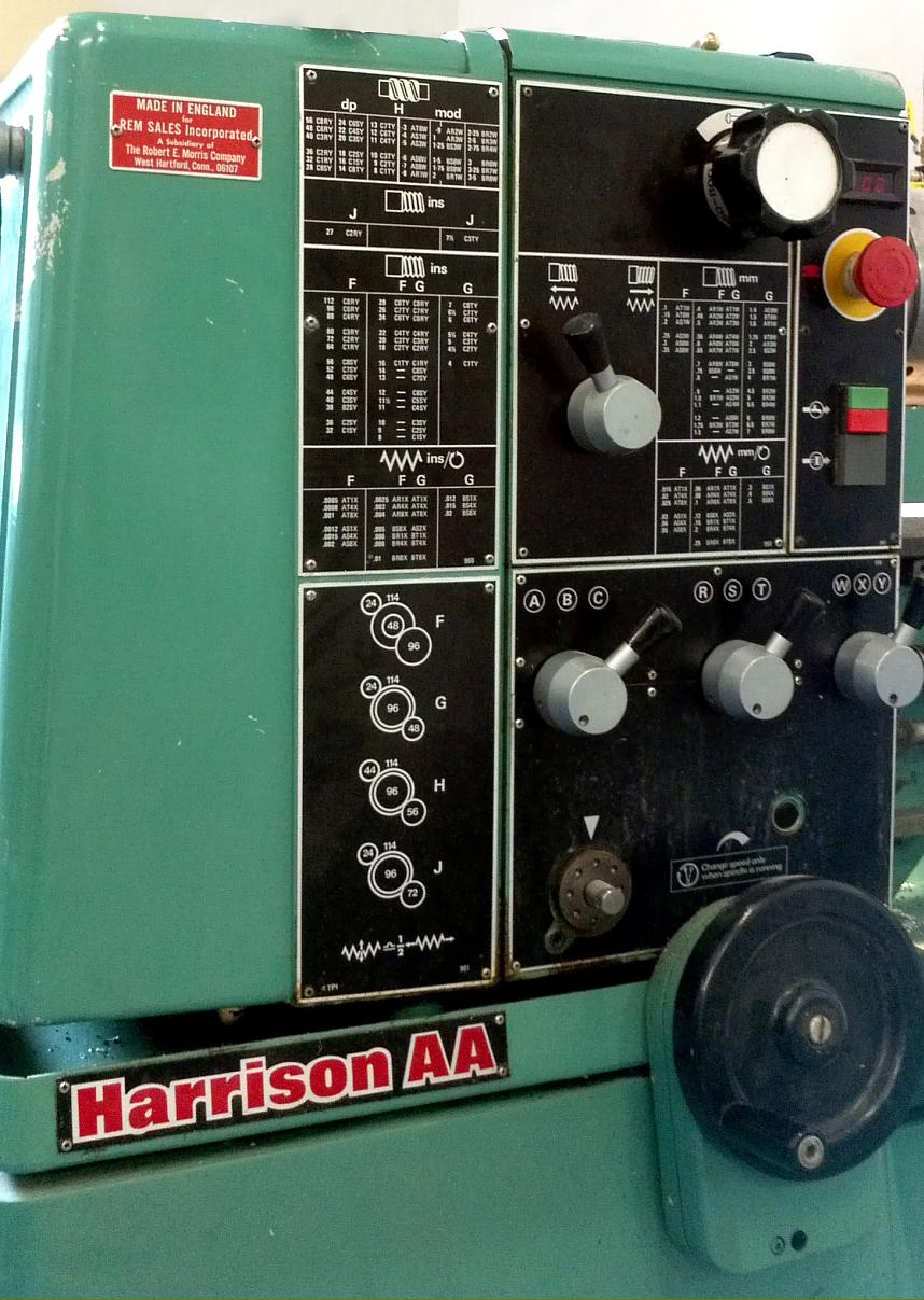

With no gearlevers to set, or belts to move - and hence no mechanical indication of the spindle speed - some form of speed readout was required; unfortunately, instead of being a large, clear unit angled so that the operator could read it without hesitation, this was a to-small, insignificant affair tucked away in the top right hand corner of the headstock's front face. With the speeds divided into three ranges and assisted by the special chain drive the headstock contributed to the unusually quiet running of the machine - the makers claiming a maximum noise level of just 80 DBA.

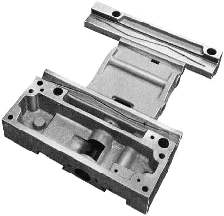

Constructed along traditional Harrison lines, the carriage featured a full-length cross slide and a top slide that swivelled through 360 degrees; both the saddle-to-bed fitting, and the cross slide were fitted with proper taper-key gib strips that allowed very fine control over their free movement and, as standard, the compound slide feed screws were fitted with dual-reading English/metric micrometer dials. The cross-feed screw nut was equipped with the same type of simple but effective "wedge" anti-backlash adjustment employed for many years on all larger Harrison (and Colchester) lathes.
The double-wall, cast-iron apron was of a straightforward but efficient design with a push/pull button to select the power sliding or surfacing feeds (the surfacing feed was one-half the sliding rate) with a separate flick-up-and-down lever (that retained its easy movement even under the heaviest cuts) to engage and disengage them. The hand-traverse handwheel could be disengaged when power feeds were selected and a hand-operated plunger pump drew oil from a sump in the base of the apron and lubricated not only the bearings and gears, but could also the saddle and cross slide ways.

The straight bed (there was no option of a gap) was induction hardened and fastened to a heavy-gauge sheet-metal stand fitted as standard not only with the usual splash back, but (unusually for a modern Harrison) a locking tool cupboard as well.  The machine weighed approximately 1410 lbs (640 kg) and was 73 inches (1845 mm) long and 40 inches (1040 mm) wide, including the very deep splash back that was designed to allow the fitting of a hydraulic copy (tracer) attachment..
The 330 mm (13") swing by 635 mm (25") between centres Harrison AA was a small, very well specified toolroom-quality lathe constructed to International Precision Lathe Standards ISO R1708 and BS 4656 (UK) and DIN 8605 (Germany); it replaced the previous small variable-speed drive Harrison lathe,  the 10-AA, that had been a re-badged Colchester Chipmaster.

With no gearlevers to set, or belts to move - and hence no mechanical indication of the spindle speed - some form of digital speed readout was required; unfortunately, instead of being a large, clear unit angled so that the operator could read it without hesitation, it was a rather tiny, insignificant affair tucked away in the top right hand corner of the headstock's front face.

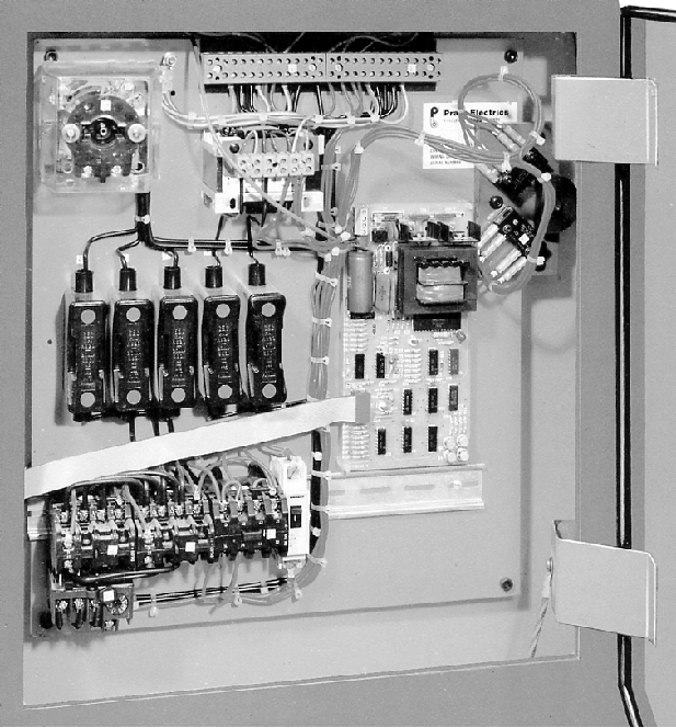

The 110-volt electrical control equipment was neatly built into a single compartment on the left-hand end of the stand, access being through a door protected by a mechanically interlocked isolator switch. The lathe was not fitted with a clutch, but relied instead upon direct on-line starting through forward and reverse contactors with 'emergency stop' available though a button mounted on the headstock and a full-length foot bar between the cabinet feet; the main spindle stop, start, forward and reverse control was by a gated lever fastened to the right-hand face of the apron.
The pumped oil supply from the apron was distributed
to long grooves in the V ways of the saddle.
