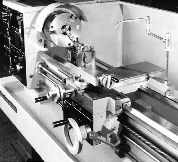

The cross slide was of the full-length type and both it and the top slide (which could be swivelled through 360 degrees) were fitted with taper-type gib strips; the handwheels were of the typical Colchester/Harrison "semi-lever" type with the micrometer dials (dual-reading metric/English units were an optional extra) finished in non-glare satin chrome; the cross feed screw nut could be adjusted to eliminate backlash.
Fitted with a conventional spoked wheel for movement by hand, the apron carried both leadscrew and power-shaft driven feeds; the 32 mm (1.26") diameter leadscrew (of 6 mm pitch or 4 t.p.i) was engaged only for screwcutting (and carried a torque-limiter) whilst the powershaft provided the sliding and surfacing feeds used in normal work. A push/pull button selected the power sliding and surfacing feeds, with engagement by single lever in the middle of the apron.

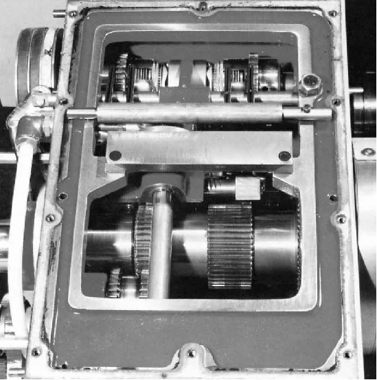

With the end cover removed from a heavy-duty headstock M350 the simple but effective rocking motor mount, quiet-running, non-metallic intermediate changewheels, the V belt drive to the headstock pressure lubrication pump (bottom) and long spindle clutch control rod are all clearly visible.

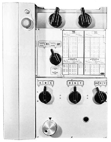

The geared headstock provided 12 speeds in geometrical progression from 40 to 2200 rpm all selected by a cleverly-engineered system from a single dial, centrally positioned at the top of the headstock's front face.
Clearly labelled and logically laid out headstock control panel. Although a centralised low-voltage push-button control "Station" was mounted on the headstock (which controlled the main motor, spindle brake, emergency stop and coolant pump) electrical control of the spindle was intended to be primarily from a lever attached to the right-hand face of the apron, where it fell conveniently to hand and, of course, moved with the carriage as a cut was taken.
The black cylinder in the picture above is the end section of the Matrix forward-reverse clutch fitted to the headstock-input shaft .
