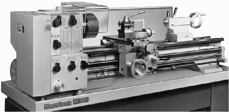

Harrison M300 - circa 1986 model     M300 Photo Essay

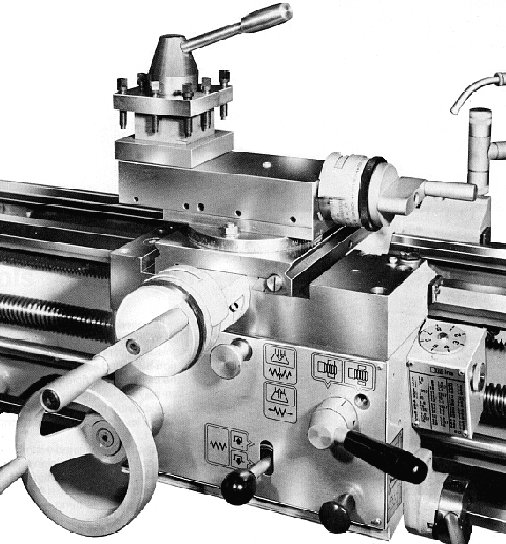

saddle and compound slide rest detail. Centralised lubrication is fitted, activated by the button on the bottom right hand side of the apron. The lathe shown is fitted with the optional dual English and Metric micrometer dials. As is not uncommon, the photographer has put the toolpost in the one position to be avoided when taking the first cut …..
The cross and top slides are identical to those used on the later Colchester 1800, 2000 and 2500 series Student and Master lathes

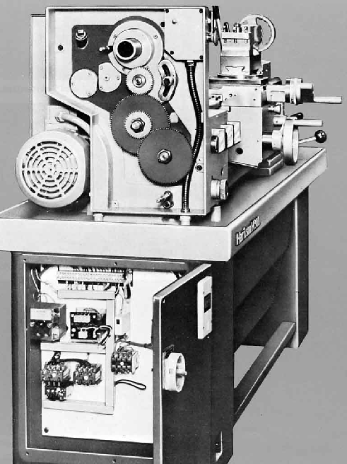

Headstock end of an M300 with the changewheel cover removed and the electrical-control and distribution panel door open.

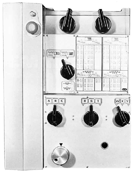

The 38 mm (1.5") bore 5 Morse-taper spindle was fitted with a hardened and ground No. 4 D-1 Camlock nose and ran on Gamet Super-precision bearings; the headstock was lubricated by oil splash. The speed-control levers had a finish that was far too smooth making them difficult to operate with oily hands.
Simple, neatly laid-out and clear screwcutting chart

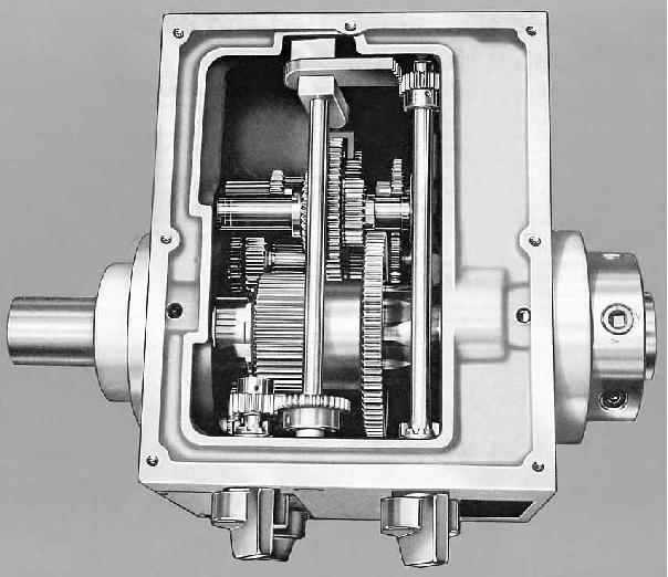

Gears in the screwcutting and feeds' gearbox were all induction hardened and ground with the threading and feed ranges selected by three levers and an 8-position rotary dial. A total of 39 metric, 35 English, 18 Module and 18 Diametrical pitches could be achieved by moving the control levers and either rearranging the standard changewheel set - or employing the extra non-metallic (hence quiet-running) gears that were supplied with the machine in order for it to achieve its full threading range.  The two large cylinders on the end of the shafts protruding through the side of the apron housed the leadscrew and powershaft overload clutches.
