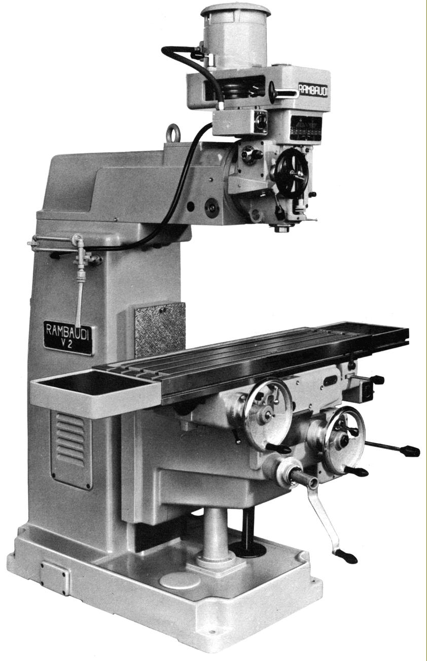

Rambaudi ram-head vertical miller Model V2. The V3 differed only in having a more robust head
Rambaudi V2 with plain, non-rotating ram assembly

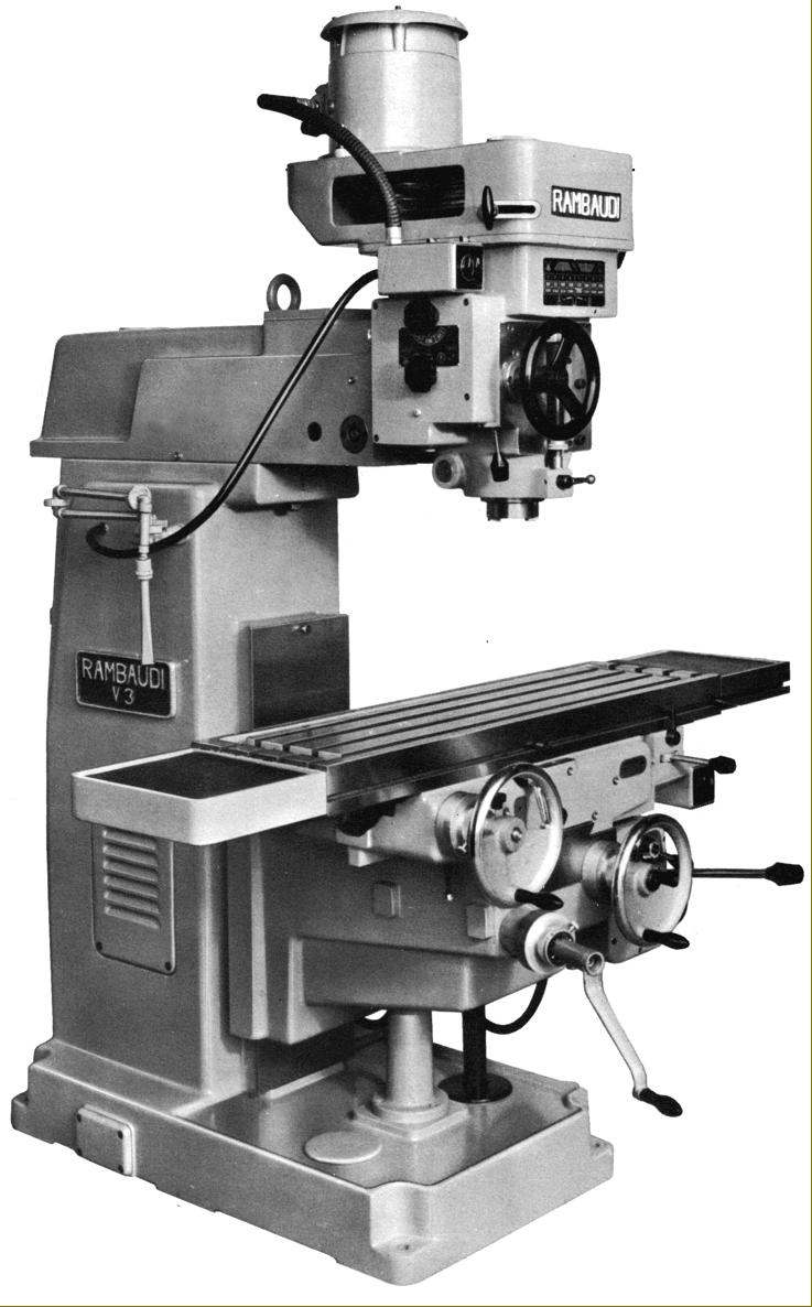

Standard V3 with non-rotating ram

Head as used the early model  Rambaudi V3
