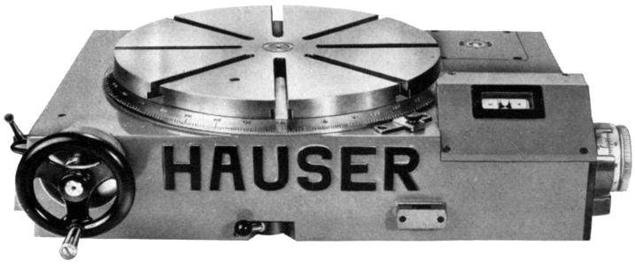

Hauser 300 mm (12") optical-reading rotary table designed to fit machine Types OP-2, 2-SO, 2-SBO, OP-3 and 3-SMO
