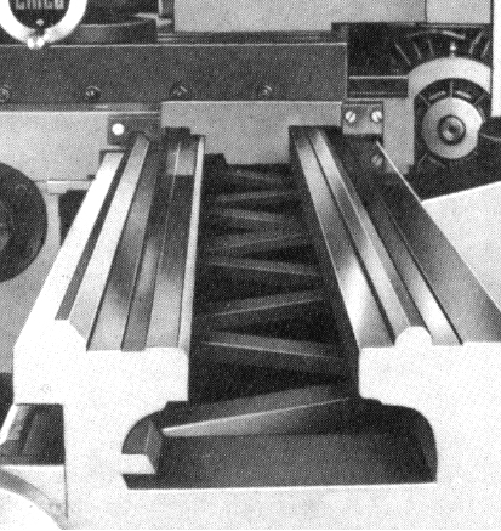

Triangulated bracing between the bed walls
