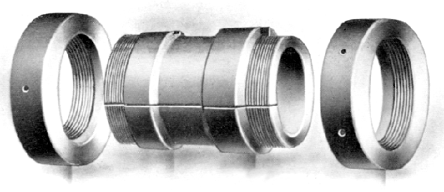

Split along their full length, the two bearings were in bronze and screwed at each end to carry nuts which  provided a means of accurately setting the running clearance.  It is not clear if the bearings were fitted into a tapered housing - in which case only one end would have needed threading - or fitted with slightly tapered threads. The type of back gear assembly available varied with the size of the lathe; the largest machines, of the 36 and 42-inch swing, were fitted with a genuine "triple backgear" (mounted on the front of the headstock) which gave a total reduction in the order of 40 : 1. The 21-inch and 25-inch lathes could be ordered with either a conventional rear-mounted backgear, or a special "quick-change friction backgear" that allowed almost instantaneous changes to be made from the low to high-speed setting and back again..

Bronze headstock bearings
