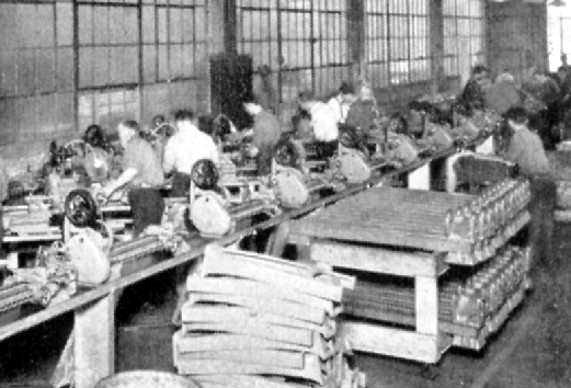

Lathe assembly benches circa 1933. In this picture 9-inch compound drive V-belt drive lathes are being put together, possibly in groups of twenty at a time, at individual work-stations. With manufacture of this model only underway for a year no production line had yet been installed and building lathes required the fetching and carrying of parts and the lifting away of complete units. Each workstation was illuminated by a single bulb.

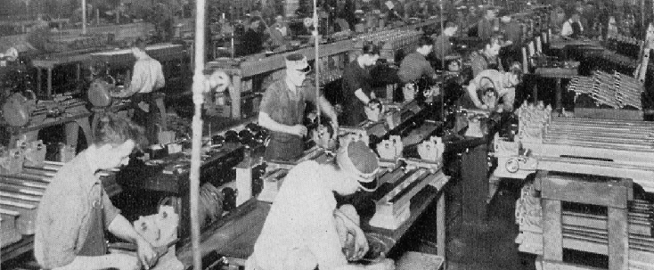

By the time the first 10-inch lathes were in production a simple chain-driven assembly line had been installed. Note the "wall-of-glass" windows, a feature of many factories until the arrival of improved electric lighting.
Another view of the same early 10-inch lathe production line.
By 1936 the factory was a busy place with several production lines as well as stations where individual machines were built up before being attached to their cast-iron stands

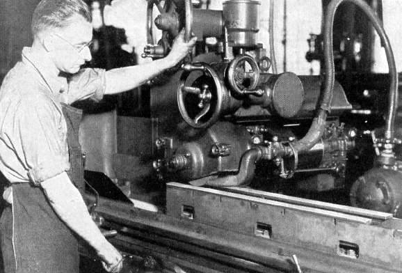

A Norton surface grinder being used to finish the bed-ways of a 9-inch lathe.

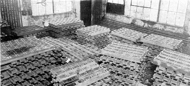

Around one thousand 9-inch lathe beds stored for seasoning before machining

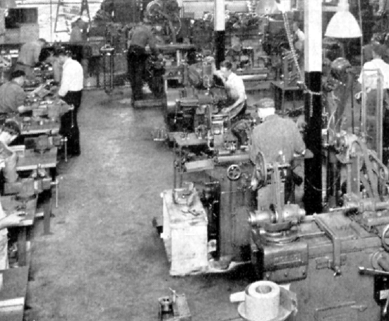

A view captioned by Atlas as the "toolroom" showing tool-and-cutter grinders, universal grinders, shapers, milling machines and hand-fitting benches all rather close to each other.

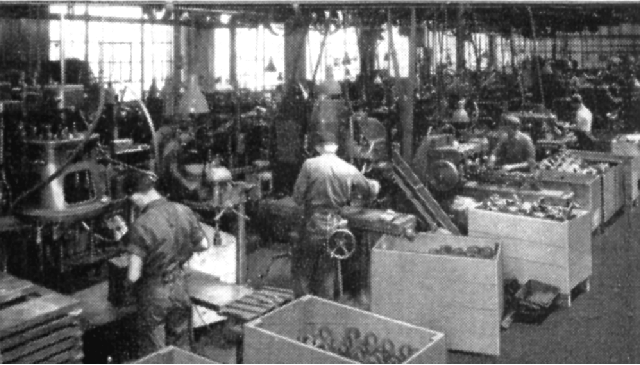

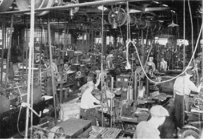

Line shafting and vertical flat belts dominated the main Atlas machine shop where parts for a wide variety of machines were manufactured in-house.
Another section of the machine shop. Although full-depth windows run along the whole length of one wall a single light was also hung over each machine tool.

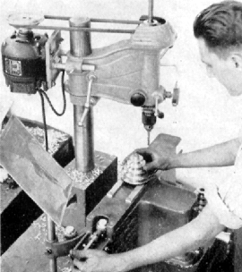

A standard Atlas drill press head fitted to a robust base and used to drill balancing holes in the headstock and countershaft pulleys.
