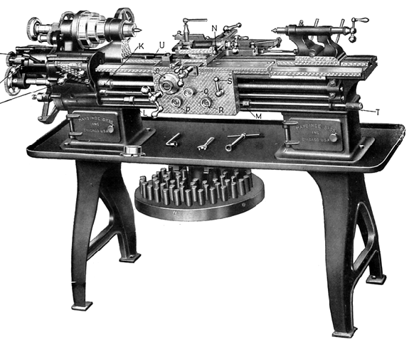

A swing-out, rotating collet tray was fitted as standard. The lever marked "N" in the picture is the top slide quick-withdrawal control

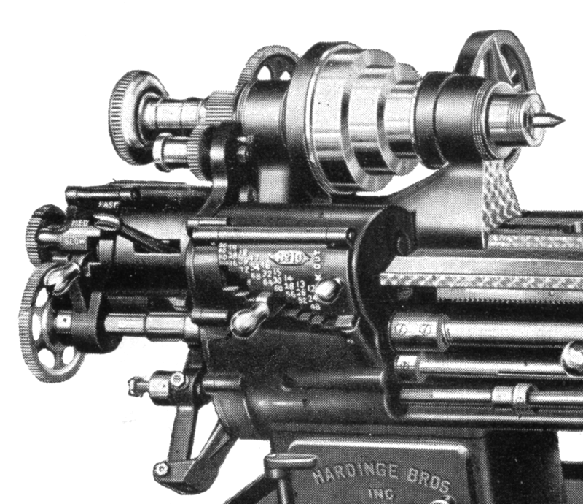

Detail of the headstock and screwcutting & feeds gearbox control levers

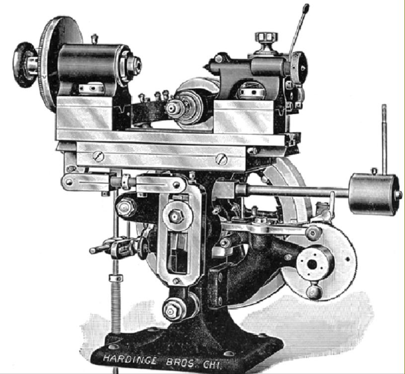

Based on the bed used for the Cataract Quick-Change Swing Precision, the Turret Tool Post Lathe was designed for the precision production of work associated with optical parts - especially lens mountings and other jobs where several operations on delicate materials involving turning, boring, recessing and internal and external threading had to be done on one undisturbed setting. Threading was by a headstock-mounted chasing unit with an independently-adjustable double tool head that allowed internal and external threading to be done on one setting whilst each of the six tools in the cross-slide mounted turret was independently adjustable for "diameters and lengths". The headstock bearings were equipped with oil reservoirs with feed by wicks.

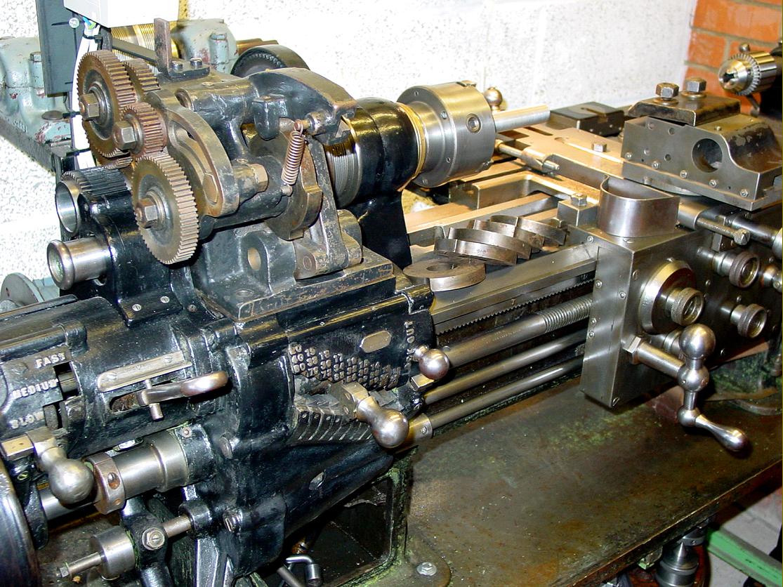

A well-preserved Quick-Change fitted with the rarest accessory of all--a relieving attachment
Another view of the Hardinge Cataract Quick-Change lathe's relieving attachment

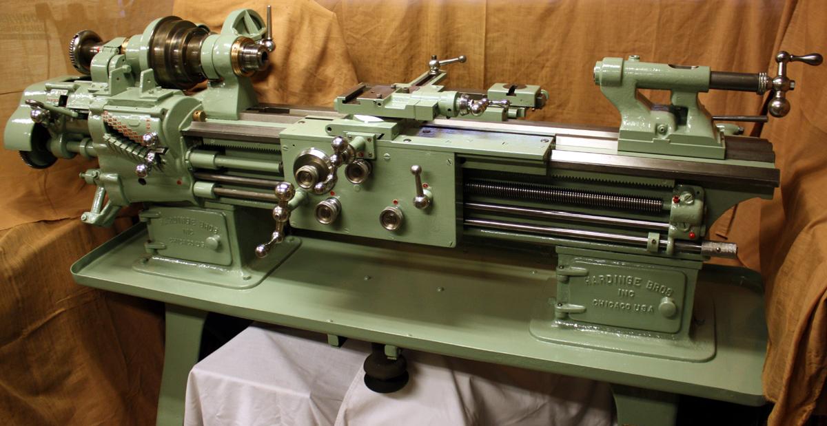

A recently restored Cataract Quick-change Swing Toolroom lathe dated 1917. Note the enormous depth of the bed. This particular example was rebuilt in England during 1950 by the machine-tool makers Cravens. The restoration was comprehensive for, instead of replacing the original and perhaps fragile straight-cut cast-iron backgears with other of the same design (the originals have been known to strip) they were replaced by ones of a helical form - and with those on the spindle in bronze. As part of the re-engineering, the whole inside of the main pulley was modified as well, with the small bronze backgear extended to form a sleeve bearing on which the pulley could turn. Unmodified examples of the lathe do not have the cut-outs in the pulley flange for the retention screws holding the bronze insert in place. The back gear actuation handle (cut down on the example above) would normally have been on the rear back gear lug, not at the front as shown. In addition to the pictures on this page, more of this machine are here

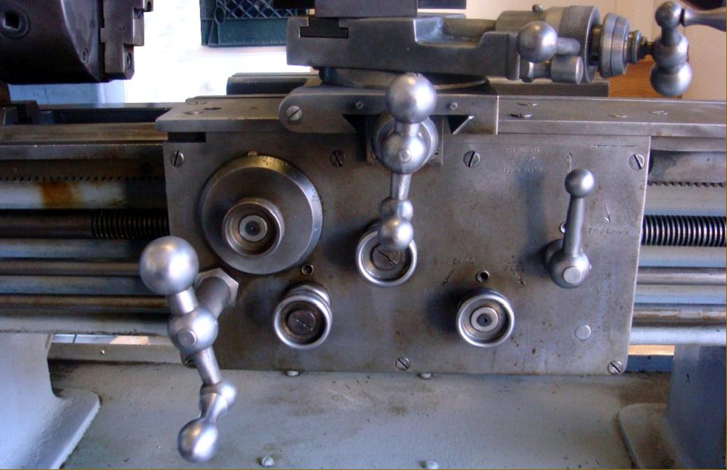

Note, on this example, the very large diameter micrometer dial on the cross-feed screw
