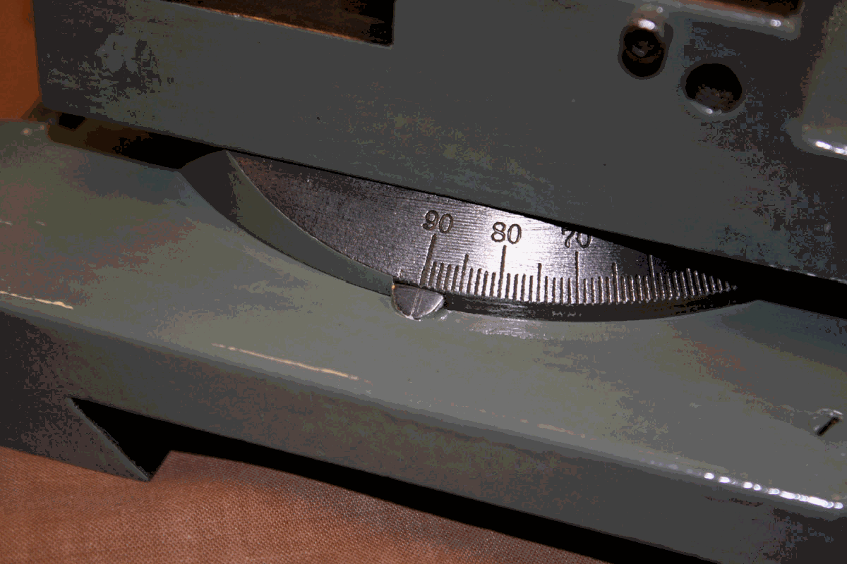

Top slide degree swivel graduations

Whilst the degree marks were punched (or rolled) with a single tool the digits and letters were stamped individually by hand
