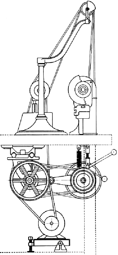

Auxiliary Drive For Toolpost Mounted Attachments
Countershaft drive unit complete with an "overhead" to run toolpost-mounted high-speed grinding and milling spindles.
