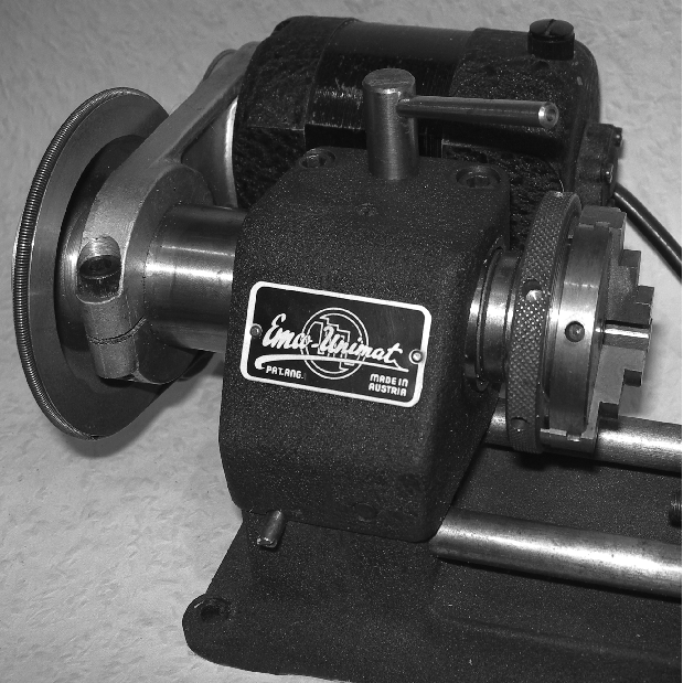

Rare and now highly-prized, this Emco Unimat is of the very first type, and almost certainly manufactured in 1954. Identification points include: crackle-black paint finish; short bed with the rails fitting into holes at the tailstock end; a nut holding the tailstock barrel in place; one-piece tailstock with a marked cantilever to the rear; no carriage lock and narrow drive pulleys with the largest diameter on the spindle to the inside  - though the pulley on the motor in the example above may be non-original. This example, unlike others seen - and probably becase it came from a faulty pattern - it has  flat tops to the front and rear walls of the cross slide casting and a crudely-finished radius where the top and front faces of the headstock meet.

An unusual arrangement of the gear on the very short spindle drive handle. Later types had continuous teeth

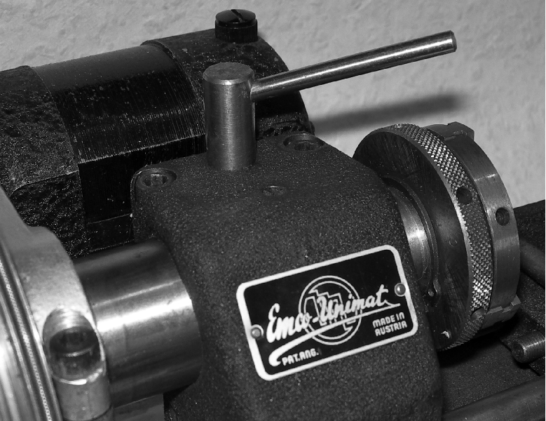

A clear picture of not only the badge but also the texture of the crackle-black paint finish
