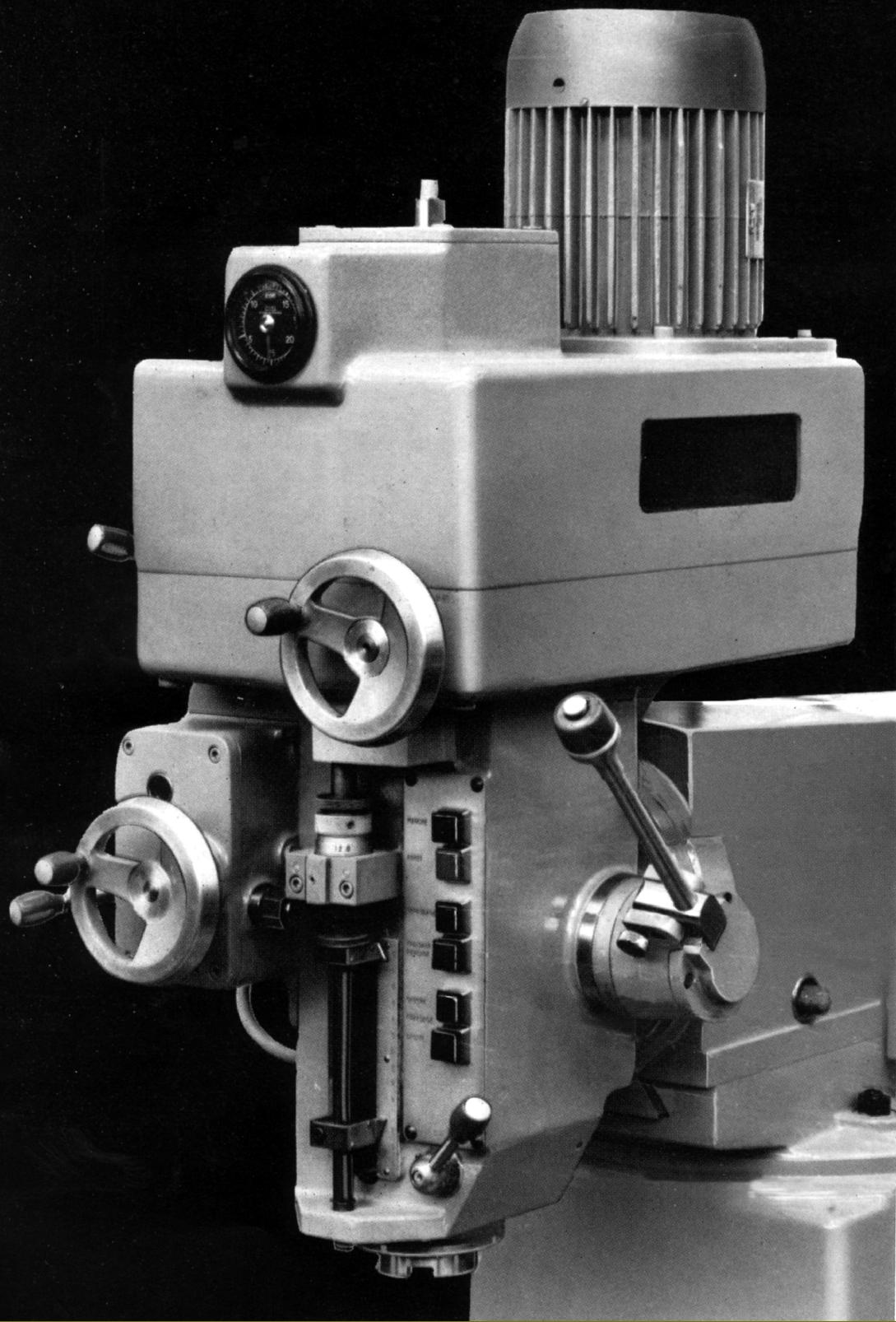

Late-model Toolmaster Model DD vertical head with power down-feed and top-mounted rev counter

The model has a compliment of electrical controls including one for the tapping attachment. Note the button on the end of the quill down-feed handle
Toolmaster DD vertical head - the lower horizontal lever on the left-hand face engaged the power up and down feed the higher one the slow-speed spindle drive

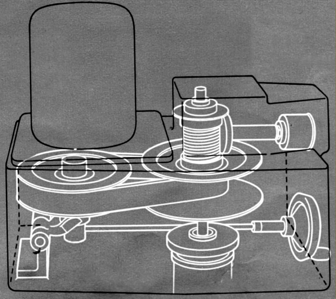

Variable-speed drive by expanding and contracting pulleys. Note the spring-loaded pulley to the right and means of driving the rev counter
