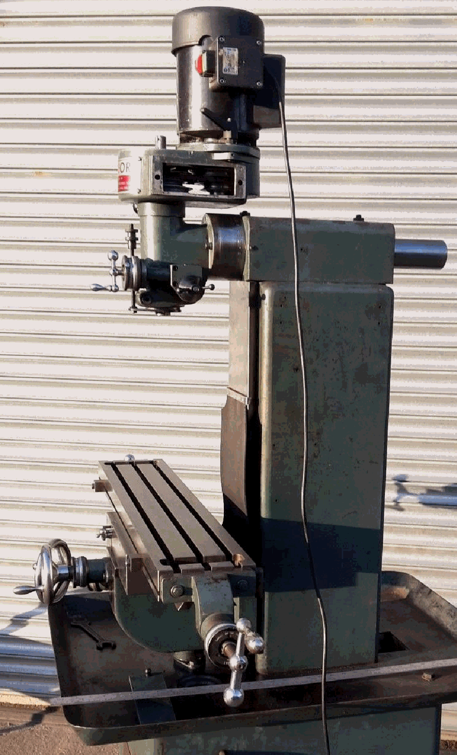

Later Type Tom Senior "Light vertical" with a sheet-steel top cover hiding the ram clamps. The motor is not original.

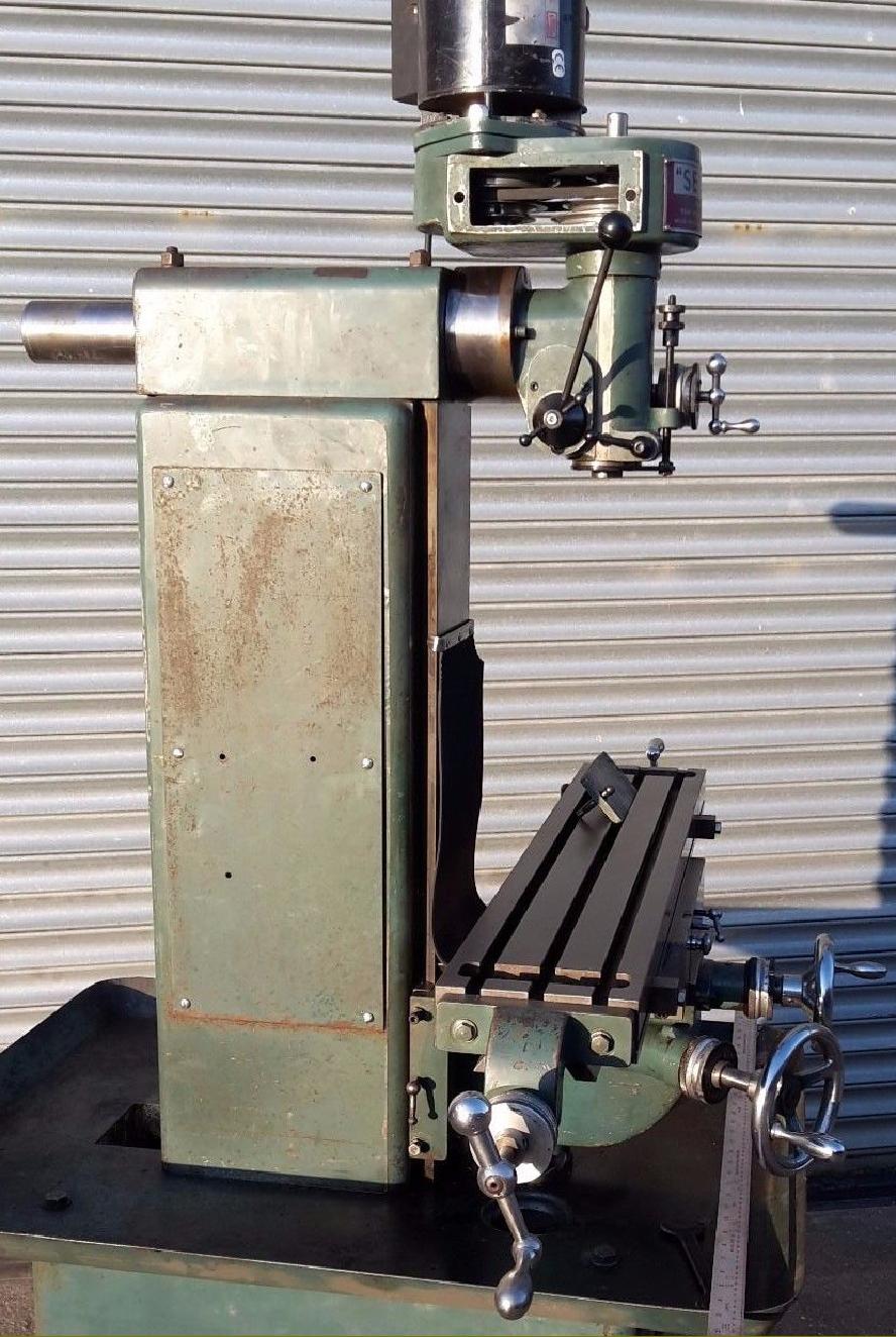

A late-type Light Vertical
