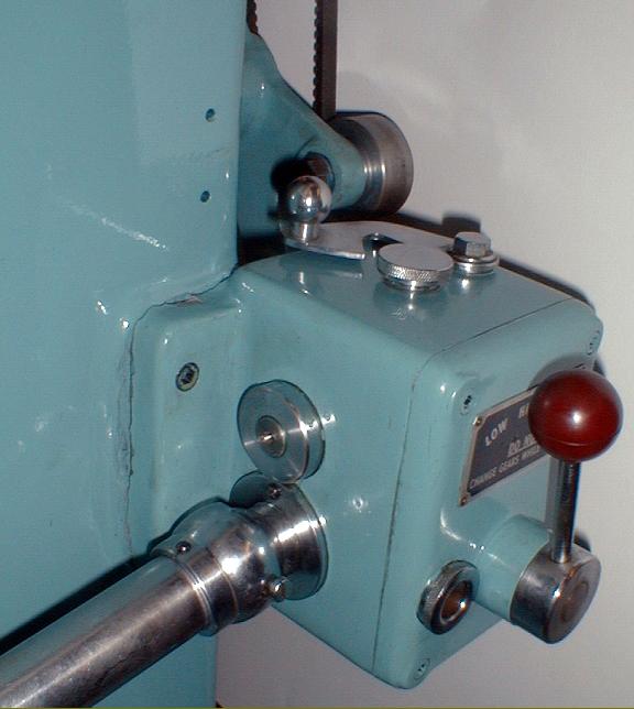

3-speed, oil-bath, table-feed gearbox. The chrome clip on top is used to secure the large cast-aluminium rear cover.

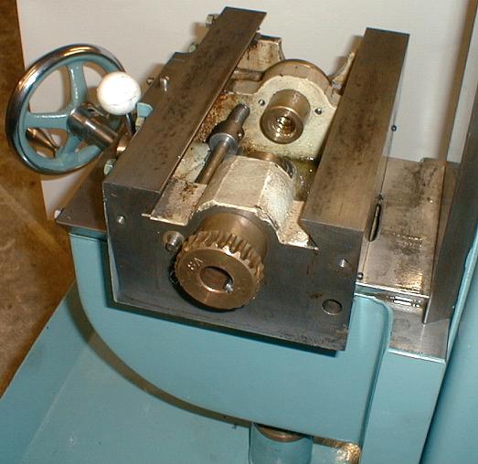

Saddle with table removed - the trip bar for disengaging the power feeds lies along the left-hand side; its end protrudes through the wall of the saddle by the bronze power-feed gear.

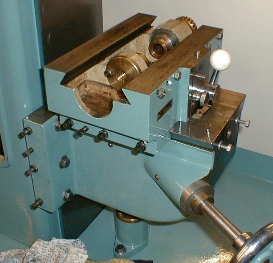

Saddle with table removed showing the large bronze drive nut and power-feed gear and shaft.
The knee-elevating screw passed through a large bronze nut and mounted a crown wheel to engage with the pinion on the end of the knee-drive screw.
The knee and saddle assembly - complete with heavy, cast, chrome-plated handles and satin-chrome micrometer dials.
