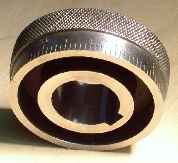

Cross and top slides screws turned with an exceptional smoothness and it might have been expected that the unit contained a ball-thrust bearing. It didn't. The effect was produced only by the precise fit and superb surface finishes of the components

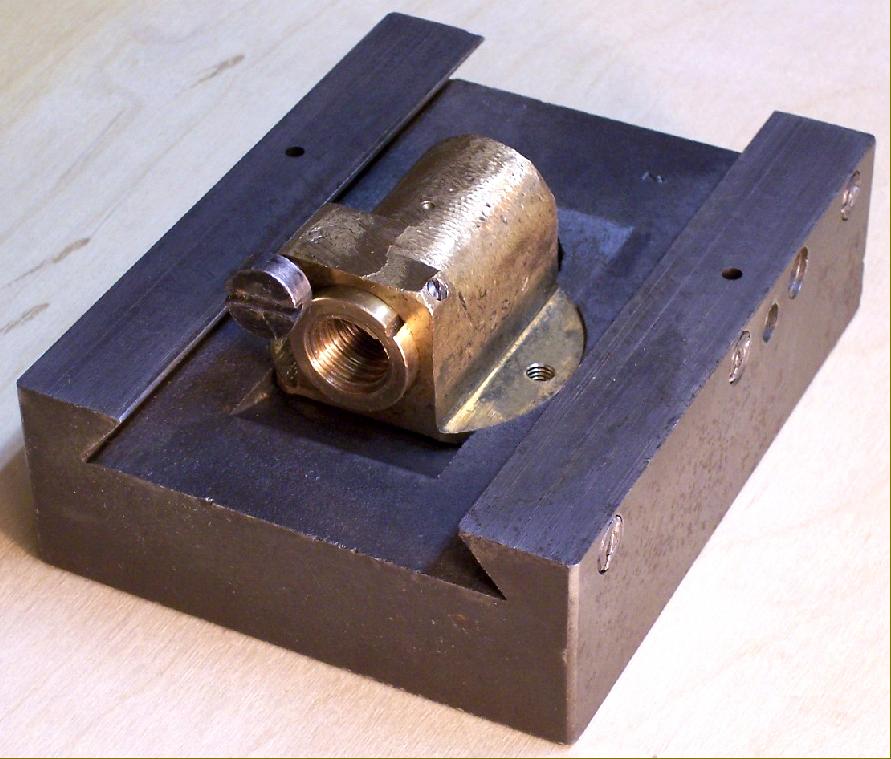

The "two-part" slide-feed bronze nut where one half of the thread was cut into a cylinder that could be adjusted backwards and forwards within the main nut to eliminate backlash
Both cross and top-slide screws were 2 mm pitch with, on export versions, a rather pointless label engraved with graduated to 0.000787 ". Even a very experienced British engineer, brought up on imperial measurements and completely familiar with them, would have found it difficult to visualise 0.000787 ". On the other hand, if the dial had been left with metric graduations where the small divisions represented 0.02 mm and the larger ones 0.1 mm (engraved 0, 05, 15, etc.) a single division of 0.02 mm would have been easy, it being just a gnat's whisker under a thou. At least Robling were being honest for some German lathes exported to "inch" countries are known to have retained metric feed -screws and nuts on the compound slide - but fitted with dials engraved with imperial graduations.
