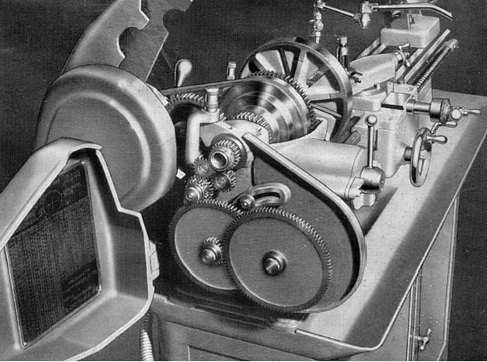

Screwcutting was by fully-guarded changewheels (there was no gearbox option), of which the unusually large standard set of twenty-two gears set was able to generate pitches from 2.5 to 95 t.p.i. The tumble-reverse mechanism was unusual in being mounted behind the spindle, its spring-loaded operating lever positioned vertically above and to the left of the end headstock bearing.

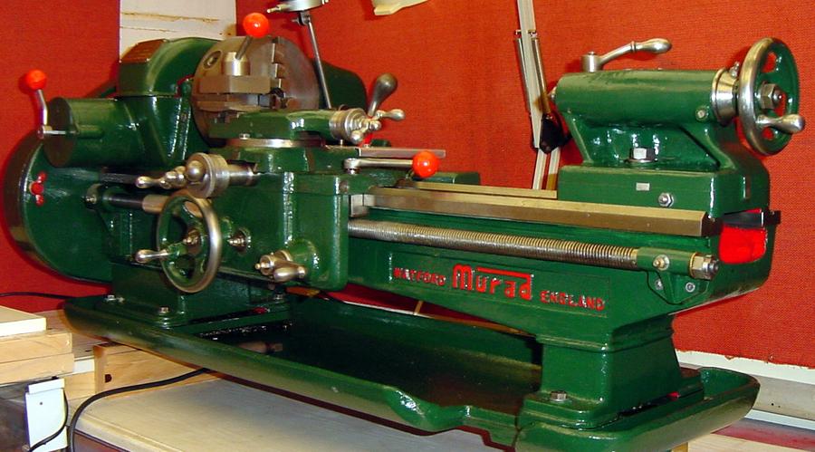

Murad Antarctica "Alpha" Precision 4" x 21" circa
Murad Antarctica "Gamma" Precision 4" x 21" of the early 1950s on a cast-iron cabinet stand.
The Murad Antarctica "Beta" benefited from the effect of being bolted to a heavy and very rigid, distortion-resistant "three-foot" cast-iron tray.
End view of the Antarctica showing the unusual position of the tumble reverse mechanism.
Component parts of the headstock assembly
The Alpha and Beta were both designed for bench mounting, but with the latter benefiting from the effect of being bolted to a heavy, very rigid, distortion-resistant "three-foot" cast-iron tray.
This early example of the Murad Antarctica lathe has six spindle speeds from 39 to 870 rpm. This was later increased to 12 by the usual expedient of using a double-size pulley on the motor shaft together with matching larger pulleys on the countershaft. Each model had its own speed range, arranged (on later models) as follows: 39 to 1300 rpm for the Alpha, 39 to 2000 rpm for the Beta and a very useful 39 to 2520 rpm for the Gamma.
The double-walled apron and generously-long saddle were both heavily constructed (and increased in size on later models). All shafts in the apron were supported in double bearings and the hand-feed action driven through triple reduction gears running in an oil bath. The top and cross-slide feed screws were of Acme form and carried spring-loaded, zeroing micrometer dials.
The cross-feed screw was arranged to that its slide could be brought well forward of the apron's front face
Screwcutting was by fully-guarded changewheels (there was no gearbox option) of which a generous set of 22 gears set was able to generate threads from 2.5 to 95 t.p.i. The tumble-reverse mechanism was unusual in being mounted behind the spindle with the spring-loaded operating lever positioned vertically above and to the left of the end headstock bearing.
The countershaft, mounted integrally with the lathe and pivoted on an extension to the rear of the headstock-end bed foot, was fitted (like many other lathes) with a neat and highly effective "over-centre" adjustable belt-tensioning arm. This example is an early model, with six speeds, but on later machines this was increased to 12 by the usual expedient of using a double-size pulley on the motor shaft together with matching (larger) pulleys on the countershaft. Each model had its own speed range, arranged (on later models) as follows: 39 to 1300 rpm for the Alpha, 39 to 2000 rpm for the Beta and a very useful 39 to 2520 rpm for the Gamma.
Catalogue illustration of the countershaft - but omitting the over-centre tensioning lever. Note the backgear engagement lever: instead of a spring-loaded plunger to locate the engaged and disengaged positions, a cheaper swing-over type, held by a friction screw was used on this example.
Catalogue picture of the actual lathe sent to Antarctica.
The later and rather different tailstock from a Murad Beta
