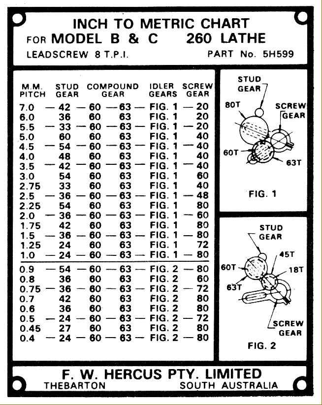

Hercus Model 260-B and 260-C lathes with an 8 t.p.i leadscrew and changewheels for screwcutting need the following gear set to generate a full range of metric pitches: 18, 20, 24, 27, 33, 36, 40, 42, 48, 54, 60, 63, 72, 80 and a 60/63 combination gear..
