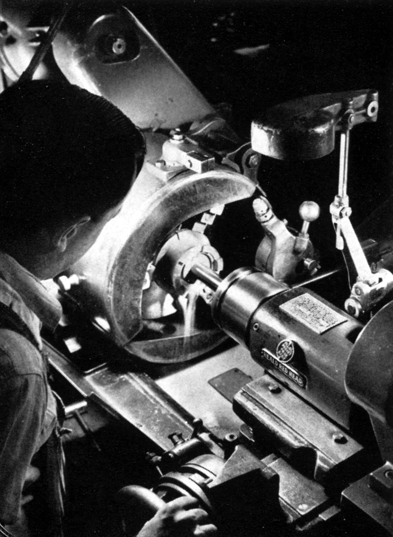

Grinding the bore of the multi-tooth clutch used in some Hendey lathe headstocks

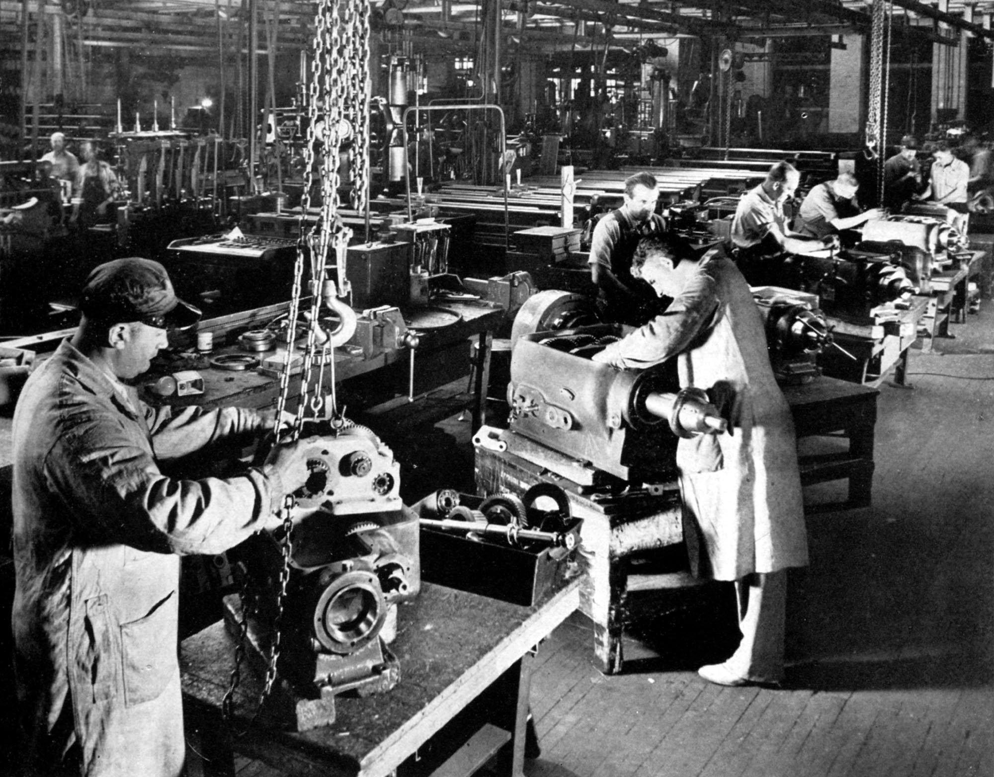

Lathe headstocks in the assembly area. In the foreground, handing from a chain block, is a "cradle", a sub-assembly containing the speed-change gears and a sleeve pinion that drove the main spindle though a multi-tooth clutch. At the second bench the cradle has been bolted into place and the main spindle can be seen partially inserted.

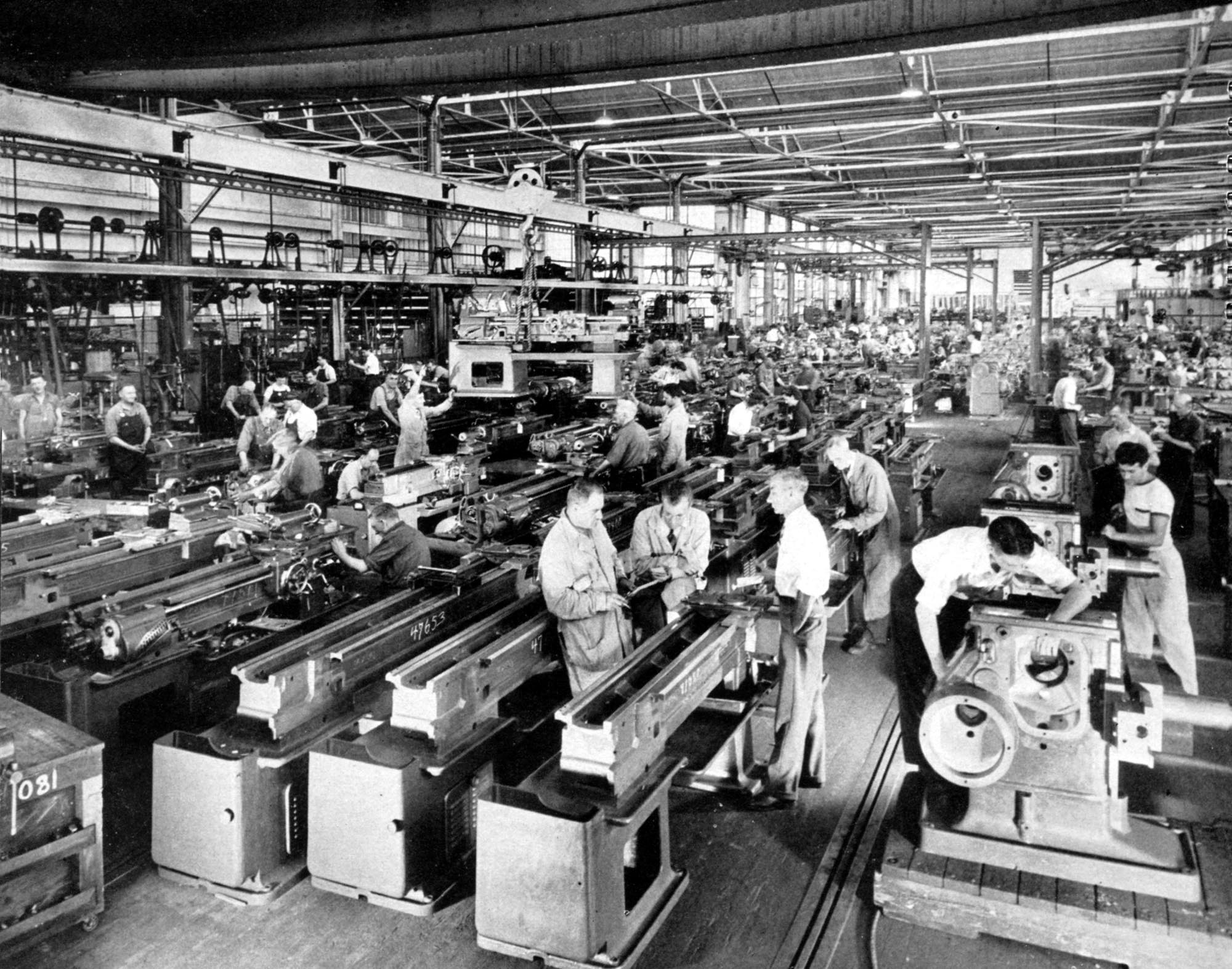

A view down the assembly floor looking towards an American flag on far wall. In the immediate foreground are lathe beds fitted to their cast-iron pedestals as delivered from the sub-assembly department ready drilled to accept headstocks and carriages.
A view down the assembly floor from the American-flag end. At this stage the lathes are nearly complete.
