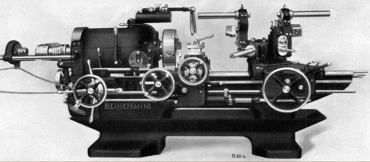

Heinemann turret lathe Type R-40 and R-50 with a horizontal turret and an all-geared headstock. The maximum diameter of bar that could be passed though the headstock spindle was, respectively, 40 and 52 mm, the centre heights 170 and 200 mm and the maximum distance between spindle nose and turret 170 and 200 mm. On all versions of the R-40, R-50 and R-60 the bed ways were chilled, ground and fitted with protective covers and the turret, on the R-50 and R-60, equipped with power feed. The headstock contained hardened gears mounted on shafts running in ball bearings.
Heinemann turret lathe Type R-60. The maximum diameter of bar that could be passed though the headstock spindle was  60 mm, the centre height 225 mm the maximum distance between spindle nose and turret 1100 mm
