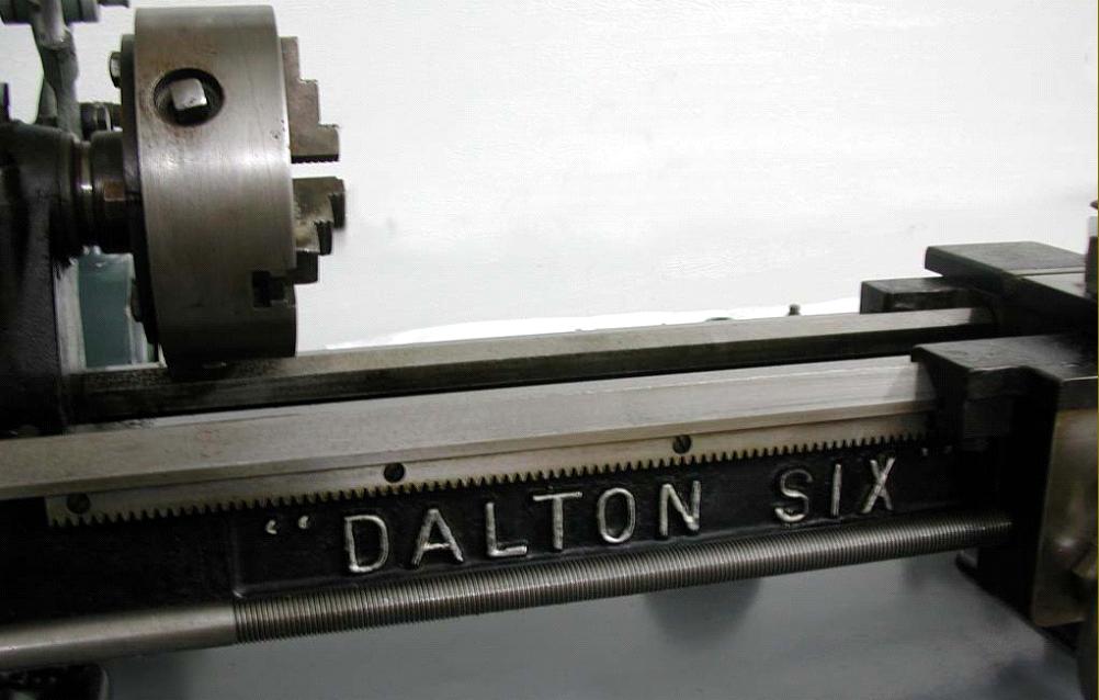

Dalton "Six" Type B-4. Although converted to V-belt drive with a more modern
countershaft this splendid example of a Dalton Six still retains much of its original appearance
