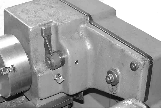

The identical Atlas version showing the neat and secure (if slow to remove and replace) changewheel and headstock drive-belt cover.
