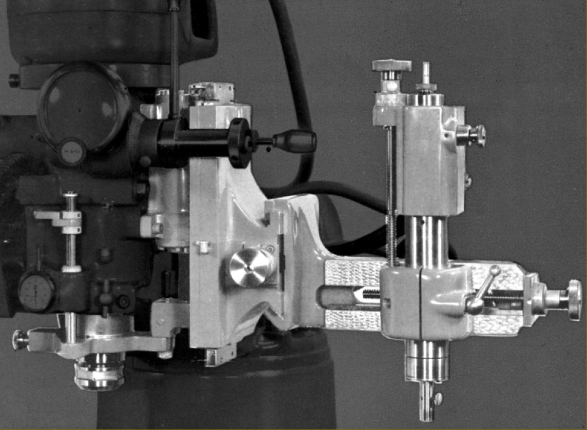

Tracer head with automatic depth control. The main cutter-carrying quill assembly was similar to that on the Toolmaster, but to its right was mounted a swing-away unit that carried a stylus able to travel over the part to be copied. The vertical movements of the stylus were transmitted by hydraulic power to the quill - that responded by instantly following the same path and allowing the cutter to carve out a replica shape. The stylus head was carried on three slides, to permit longitudinal, transverse and vertical adjustments, with micrometer dials provided on each axis for precise setting up.

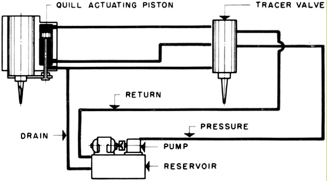

Hydraulic diagram for the quill feed
