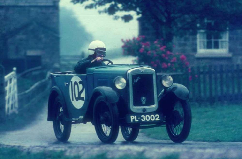

Inexpensive motor sport, stripped down for the Harewood hillclimb. I shared the car with my great friend Mike Costigan and one of us was faster by 0.010 seconds - but I honestly cannot member who. Mike was my rally navigator and I didn't realize how fearless he was until, for one all-night VSCC Measham night rally on snow-covered road, he was unavailable. A member who raced an Alvis volunteered to take his place, but just a few miles in, shouted "God! This is terrifying!", and threw up over the side. "Shall I slow down?" I asked, and to his absolute credit cried, "No! No! Keep going, there's nothing left!"

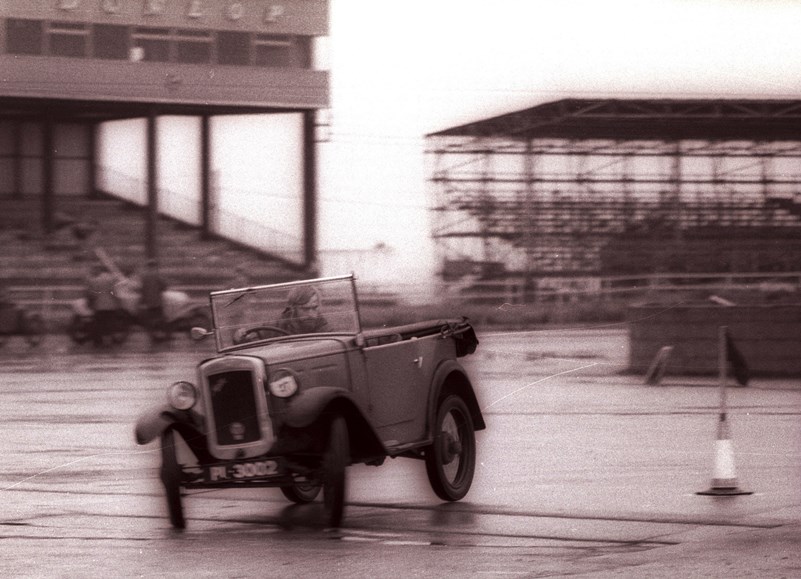

With the steering lock of a taxi, courtesy of careful filing of the steering
arm stops and cruel use of the gearbox, driving tests were always great fun

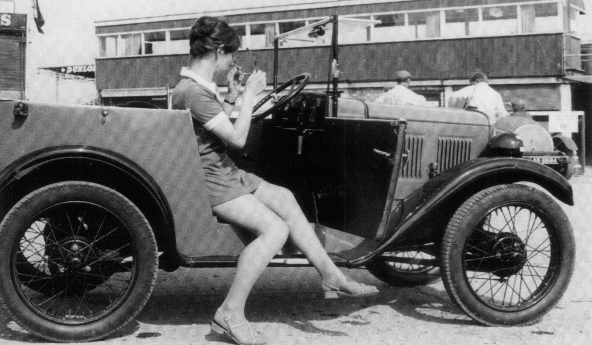

The writer's wife relaxing at Silverstone, 1970

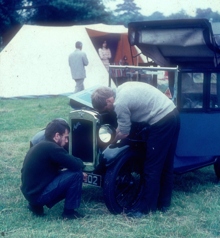

Preparing the PL3002 for judging at Beaulieu, helped by fellow VSCC competitor (and brilliant engineer) David Wortley

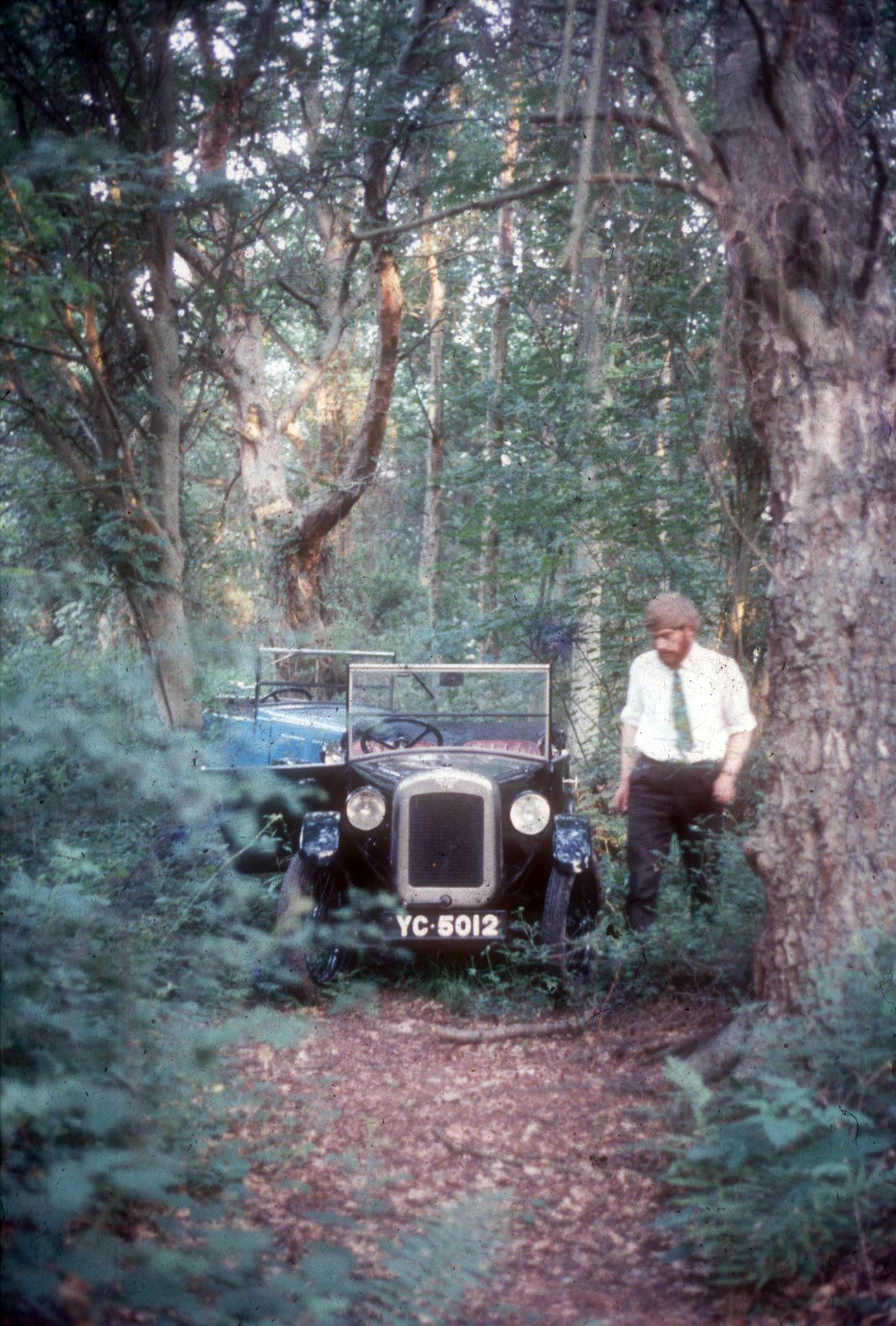

Doing silly things in the New Forest during a Beaulieu Austin 7 weekend. Yes, in 1968 we always wore ties, even when relaxing….

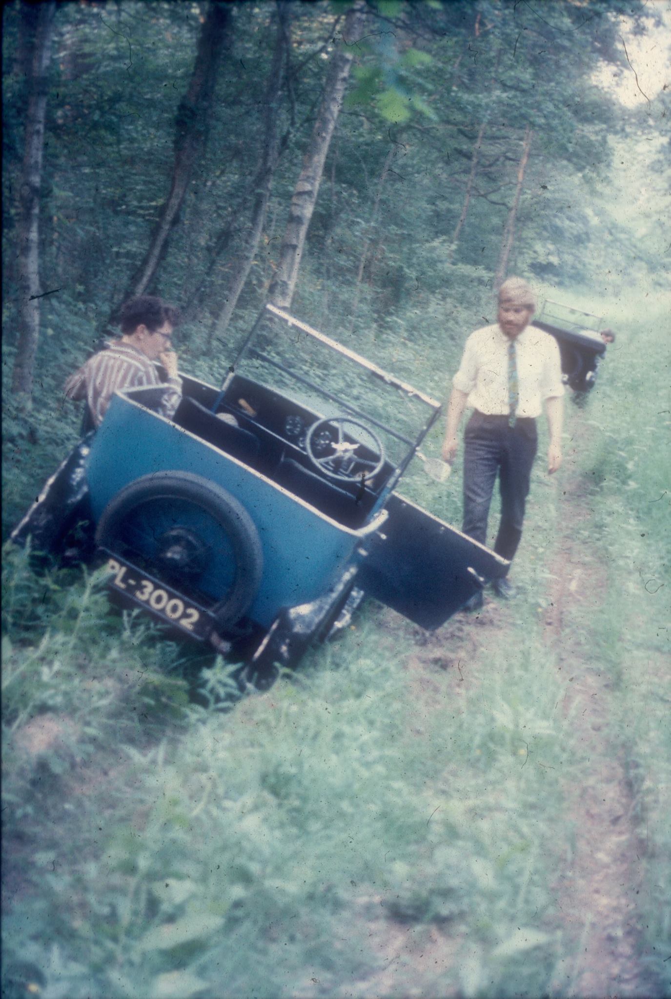

Helping David Wortley to navigate an overgrown New Forest Track - and still wearing a tie, of course. David's Chummy was another long-term owned car - 51 years - and for much of that time used for the daily commute for work as well as VSCC events and Austin 7 socials.

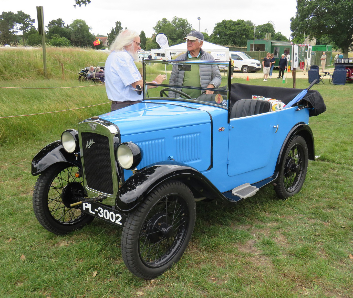

Beaulieu 2024. Rebuilt for the third time, PL3002 is now used for holidays, social runs, shopping and giving the grandchildren the chance to drive a vintage car

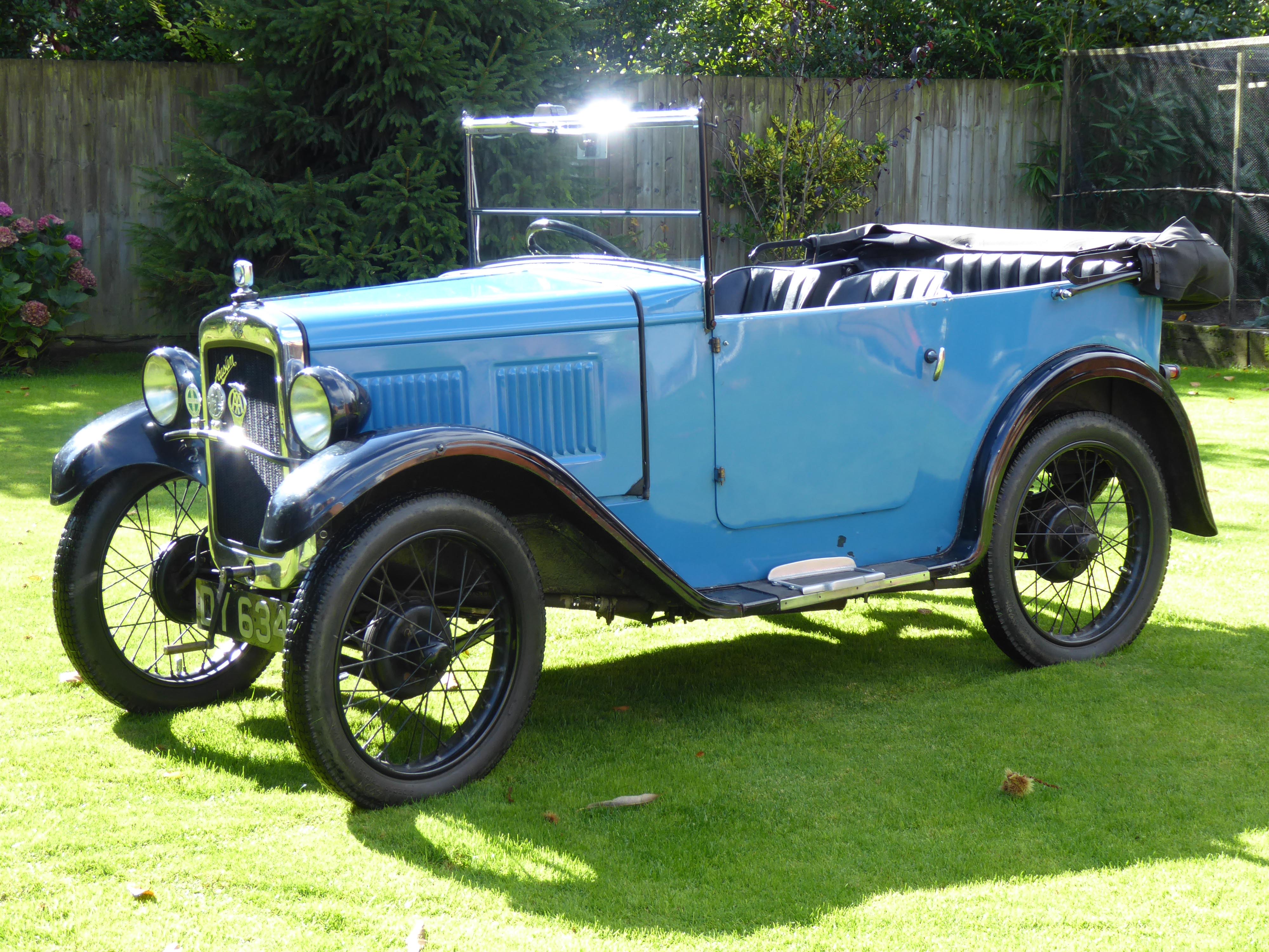

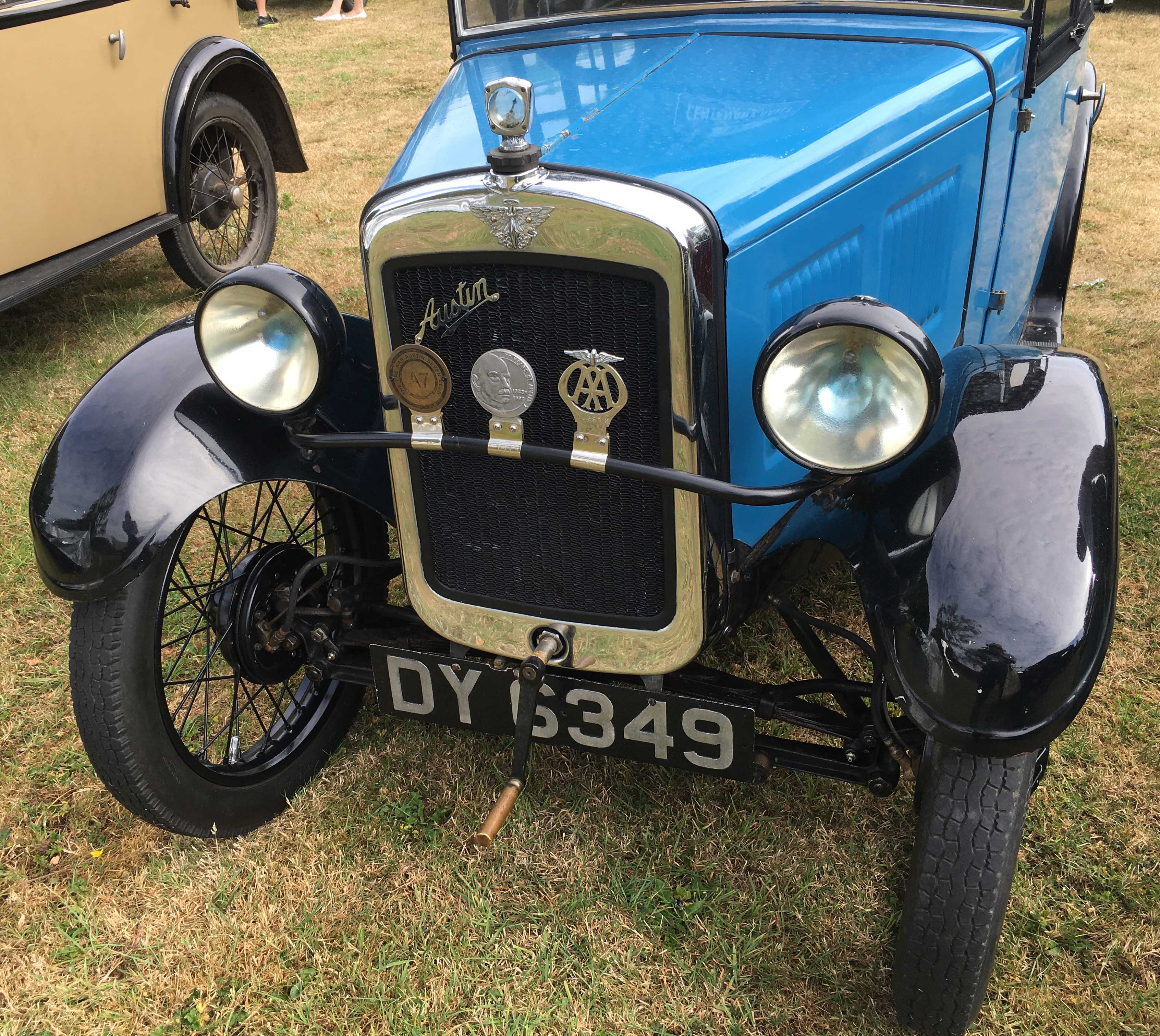

Another AF registration DY 6349 and car number B2/1384, the next down the line after PL3002.

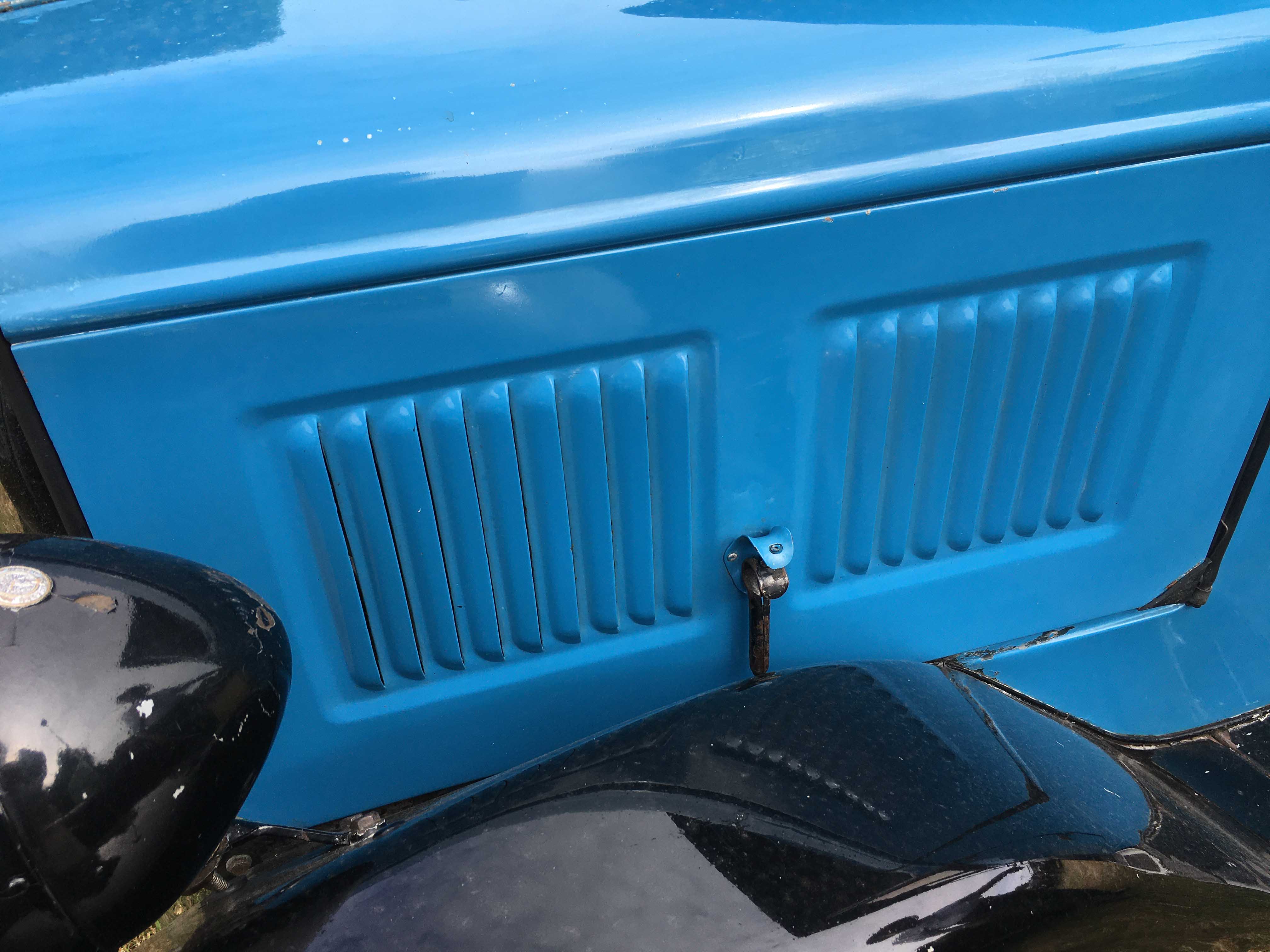

The same very rare "two-panel-pressing" bonnet-side louvers on DY 6349

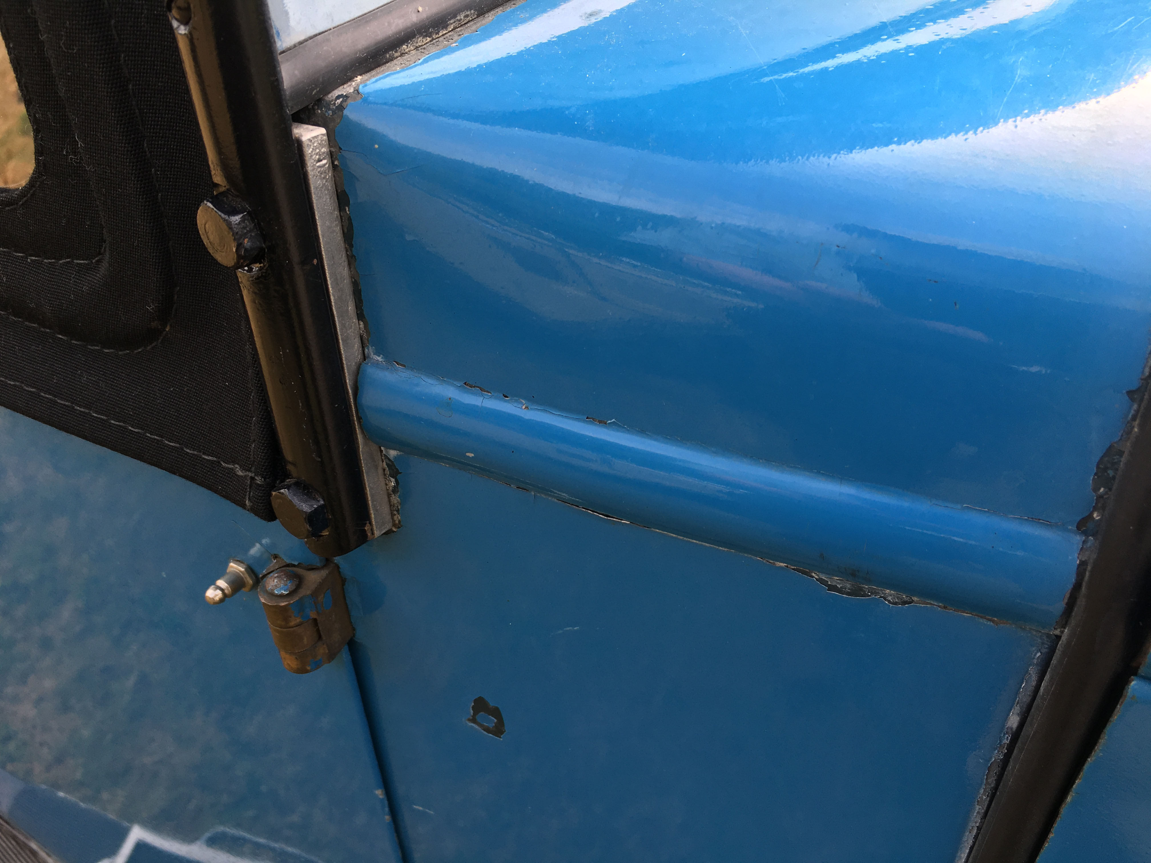

While the later steel-bodied, but very similar-looking AG has a scuttle with a line pressed into it, the AF made do with a section of curved aluminum pined on. Note the wedge-shaped distance piece that was installed between the body and each of the windscreen uprights on DY 6349. My car also had these, but after the roll-over body build, they were not needed

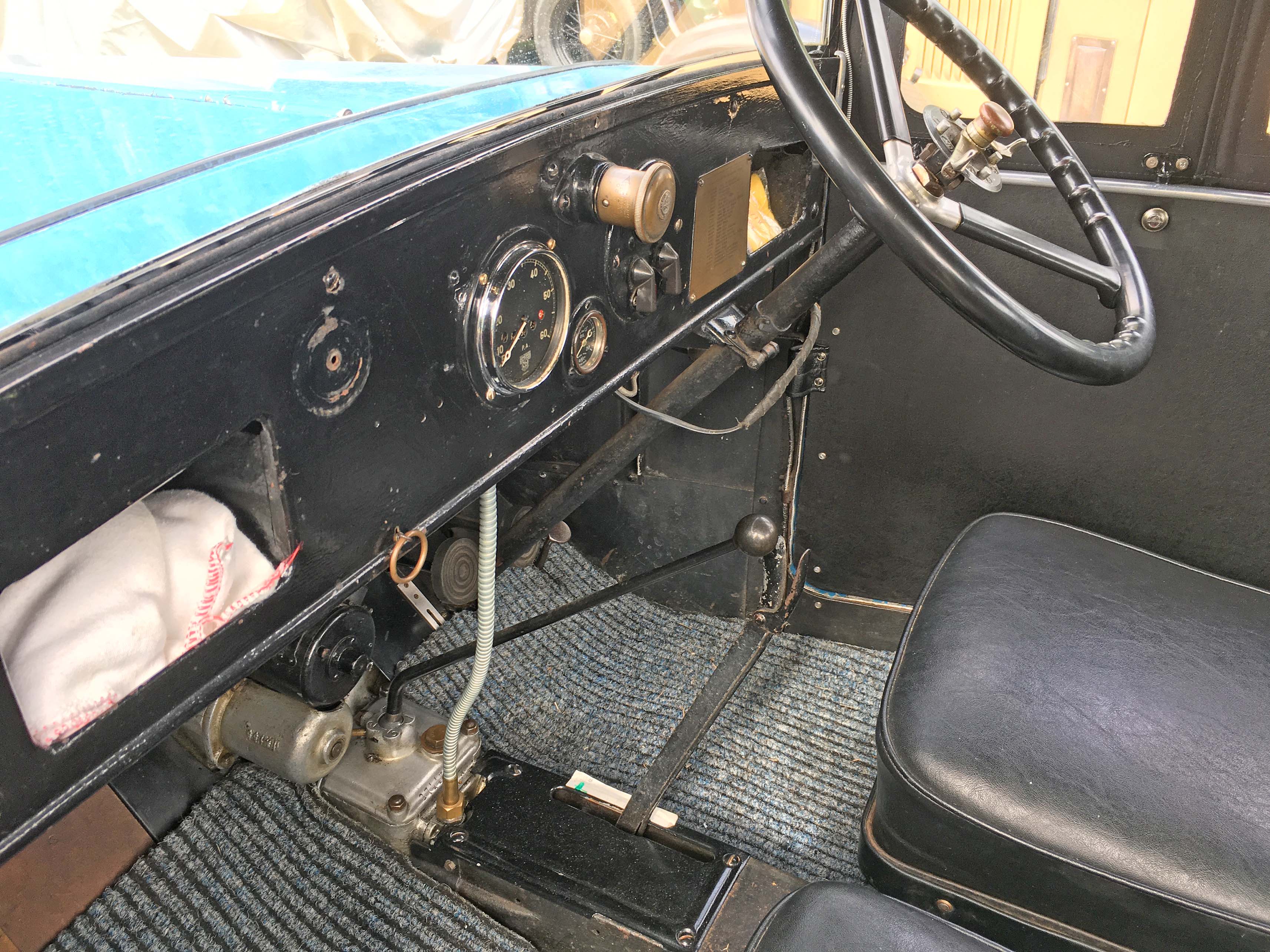

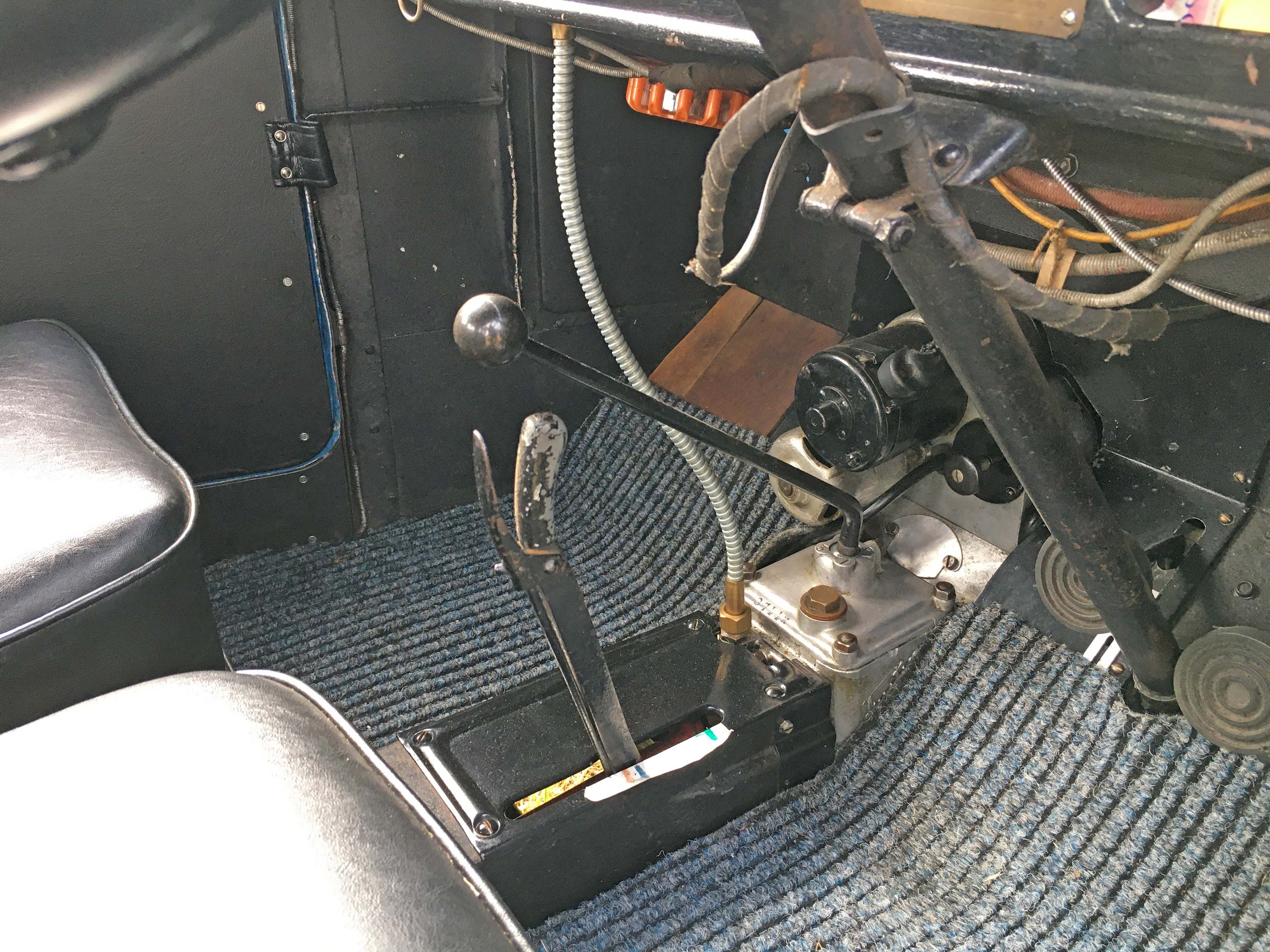

The cockpit of DY 6349. The wrong starter motor is fitted - and earlier 'bacon-slicer' type - with a modified cover bolted to the floor around it. Two interesting detail common to this car, and mine: no scuttle ventilators are fitted and the flange along the top edge of the dashboard the usual four holding screws. The flange clips over a metal bar that's drilled and tapped to accept the screws but, while the flange is tapped, the dashboard was not drilled to take the screws. Might these cars have been a Friday afternoon, "Let's just get 'em out," job?
