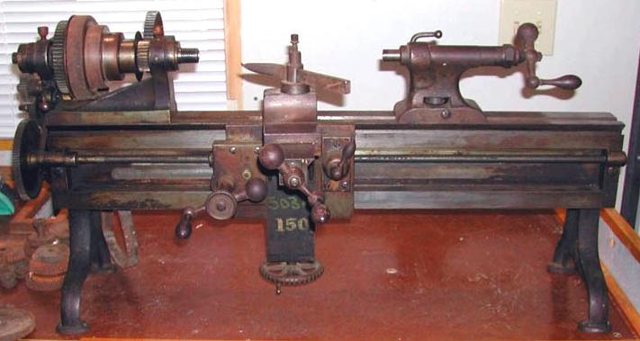

Looking uncannily like a Rivett "8-inch Precision" …….
The rare Ballou lathe with a handwheel beneath the carriage to elevate the slide rest
A "special" American Watch Tool Co. Precision bench lathe built with a very short bed and of the type often adapted for production jobs during the lathe 19th and early 20th centuries.
