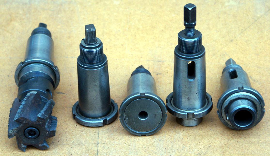

THIEL 158S vertical head spindle fitted with a Thiel No. 5 Morse taper to No. 2 Morse taper adapter with an internal thread to hold the fitting in place
An assortment of  "THIEL" Morse taper 5 adapters (MT 1  to MT 4) some with draw bolts and others with tang sockets for retention of the fittings
Socket of the  Thiel 158 horizontal spindle

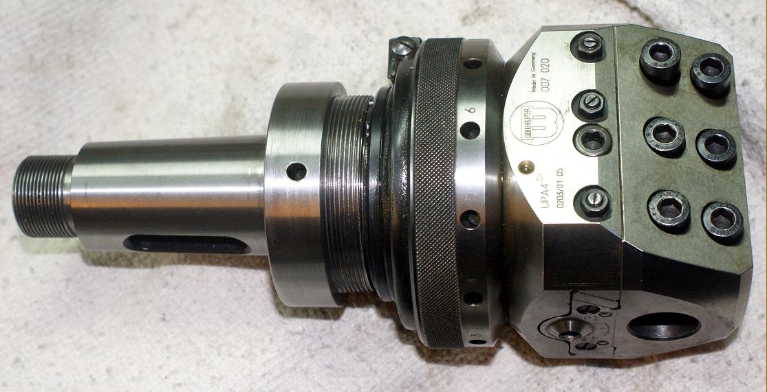

Boring head with its sleeve adaptetr
