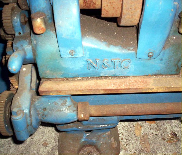

Four other mysterious examples are the NSTC (shown below), this apparently being an American-made example but about which nothing is known; the (presumably) French-made UFP; a version discovered in South Africa without any branding and sufficiently different to all the other clones to be recognised as a unique model and, most remarkable of all, a geared-head version of the South Bend 9-inch (also pictured below) - which may or may not be a "UFP"

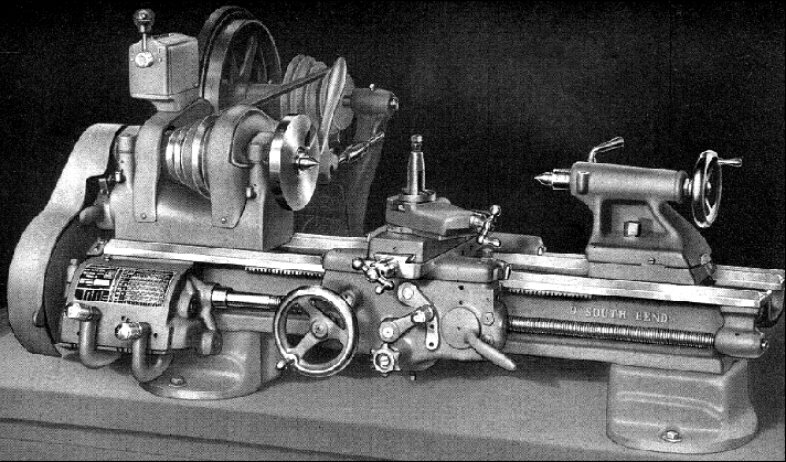

American-manufactured Model A South Bend with screwcutting gearbox and power cross feed.

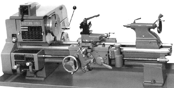

Hercus is an Australian built version of the South Bend 9 inch "Workshop" lathe; the machines were in production, as the 200 Series, with a 10" swing and able to pass 26 mm (1") through the spindle bore, until 2001. As may be seen, although the styling has been largely "squared off", the tailstock and top slide were still definitively, and charmingly, South Bend in appearance. The most significant changes were the neat, built-on 16-speed countershaft unit and the enclosure of  it, and the changewheels, to modern safety standards.
Production of Hercus machine tools began in the 1940s and it instructive to note that the firm's founder, Mr. F.W. Hercus, wrote to the British press in 1954 (but without revealing that he was a machine-tool manufacturer) outlining the Australian Customs' requirements for immigrants bringing their own model-engineering tools with them. He also pointed out that, whilst it took sixteen weeks' work  in England, at £7 per week, to buy a Model C South Bend, in Australia an "equally good" copy  could be bought with just ten weeks' wages. More Hercus information can be found HERE

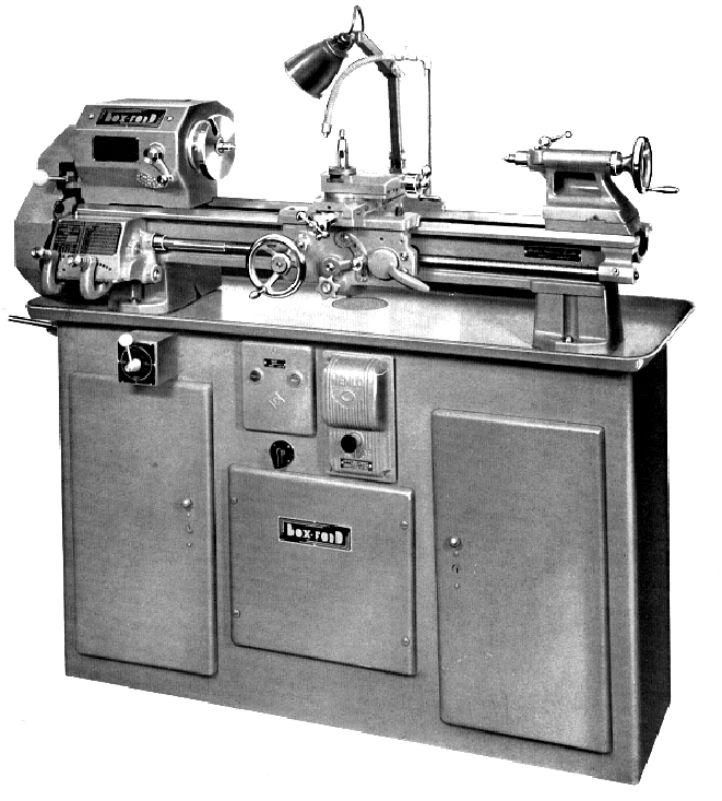

English Boxford Model AUD Mk. 1 on an underdrive stand.

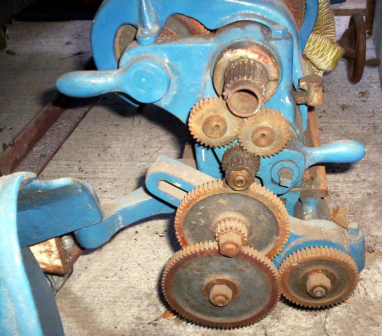

The mysterious NSTC
