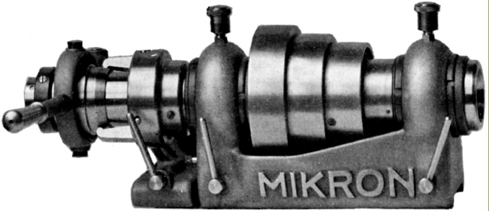

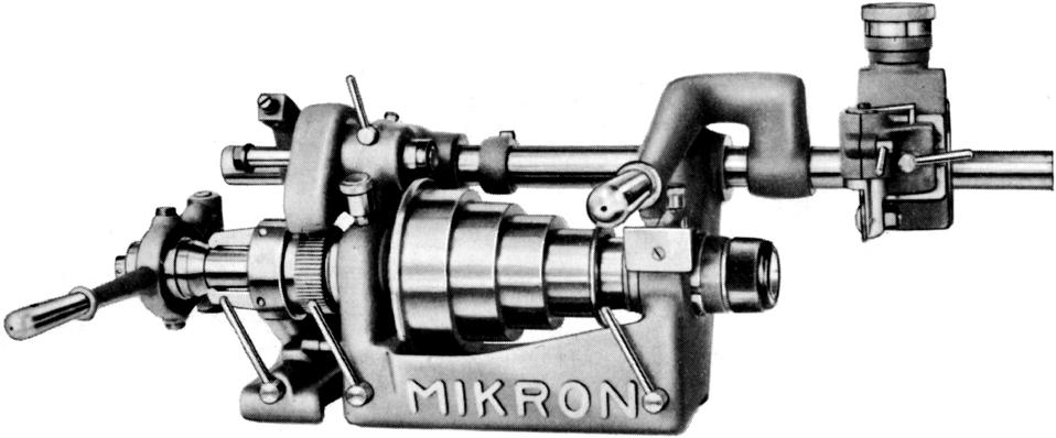

Reversed in comparison with a conventional lathe the 4-step headstock pulley of the ordinary headstocks sat with its largest diameter to the left (allowing the front bearing to be surrounded by a greater mass of metal) with drive by a 30 mm wide flat belt. The cone diameters were 61, 79, 97 and 115 mm - and the general speed range ran from 200 to 2000 r.p.m - though this was, of course, greatly affected by the type of drive system and motor employed. The end flange of the largest pulley was provided with two circles of indexing holes - 60 and 8 - with the latter made larger in diameter to allow for their use as a spindle lock. A very similar unit, headstock 8B, was fitted for heavy-duty work with double-cone bearings and another, the 2C, supplied with a backplate, centre holder and centre permanently mounted

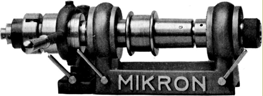

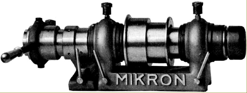

Headstock No. 9 - a very rare version built with a 3 : 1 ratio epicyclic reduction gear inside (a model that can be identified by the small locking-pin lever below the left hand bearing)

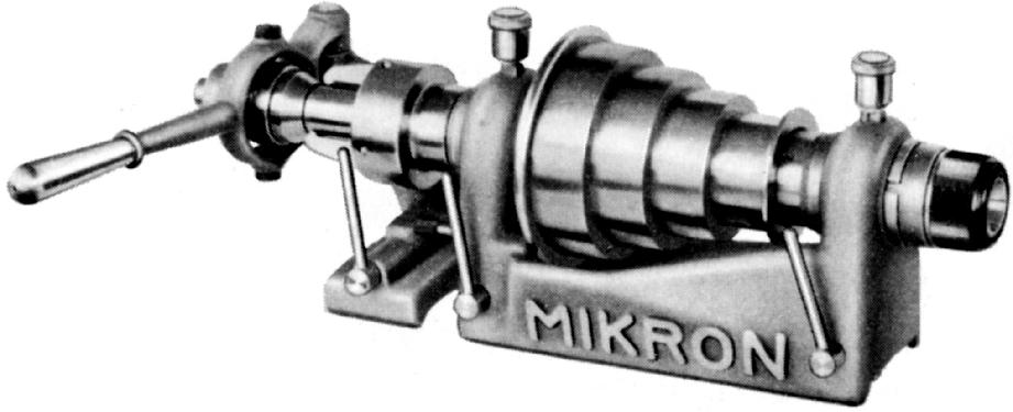

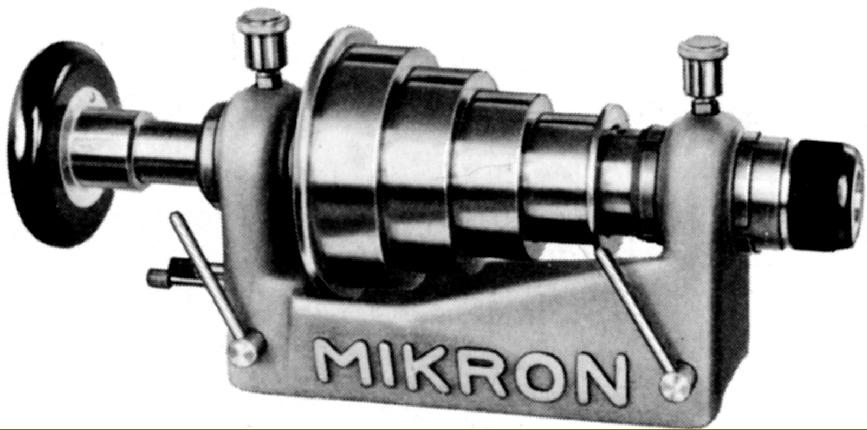

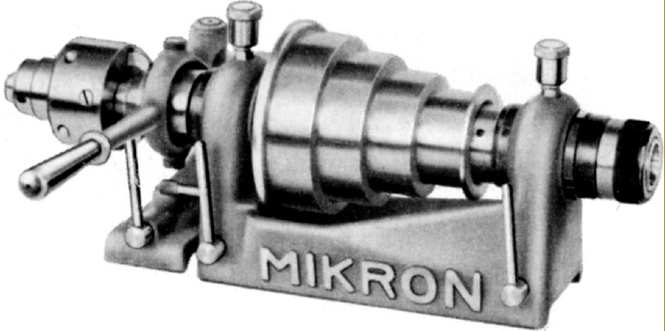

Headstock No. 10 - the No. 8 headstock was equipped with a quick-action, lever-operated collet closer

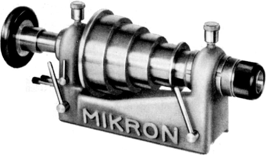

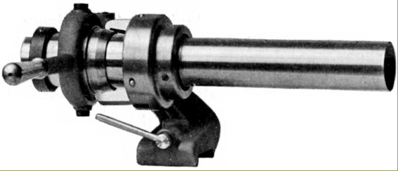

Headstock No. 11. An interesting assembly with a lever-action collet closer that that moved over the collet and pressed it inwards instead of pulling - the aim being to increase consistency of positioning by maintaining the relative position of the collet to the spindle regardless of slight variations in stock diameter. This arrangement was intended for consistently of tolerances in a production environment, better ultimate accuracy being afforded by the conventional pull-type closer

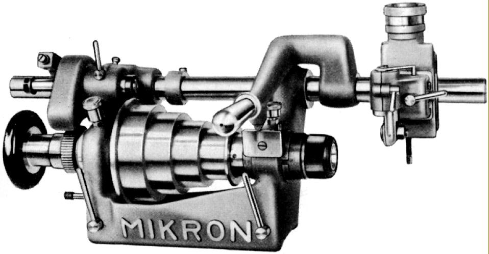

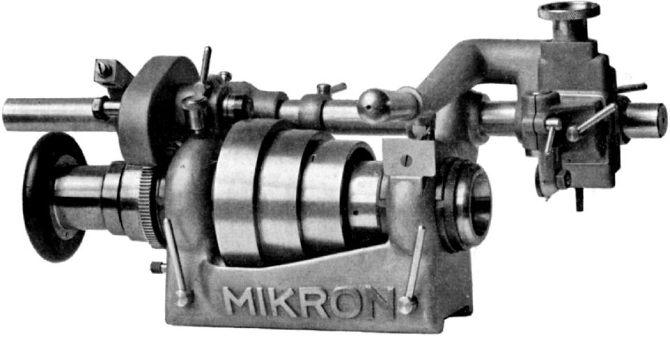

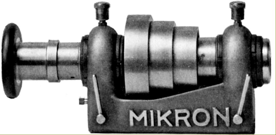

Headstock No. 12 fitted with a robust, permanently-mounted thread-chasing apparatus (No. 12) designed for cutting the fine threads used on microscopes and telescope bodies. 35 mm long hobs were employed and arranged via gearing so that the ratio between the pitch of the hob and the work was 2 to 1. (i.e. the pitch of the thread-generating screw was twice that of the work produced)

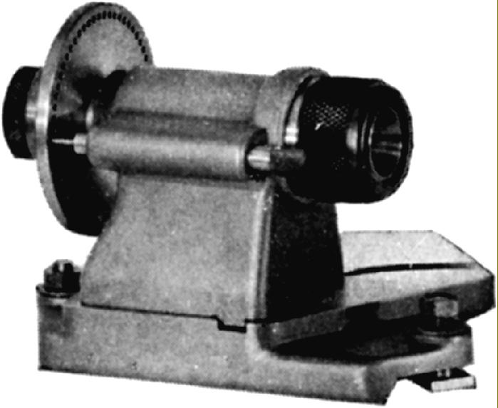

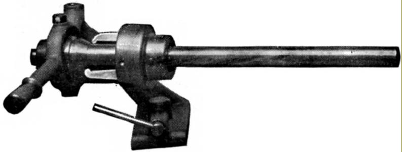

Headstock No. 16. This was for slotting work only (see accessories Nos. 36 and 37) and was mounted on a swivel base able to be turned 45° in each direction from zero. The nose was bored to accept collets of 14.5 or 16 mm capacity and provided with a thread to mount the usual accessories
No. 88 lever-operated collet draw-in attachment. The lever was 250 mm long and worked through a toggle ratio of 4 : 1. The toggle closing collar, sleeve and thrusts pads are hardened and ground
No. 89 lever-operated draw-in attachment. The lever was 285 mm long and worked through a toggle ratio of 4 : 1. The toggle closing collar, sleeve and thrusts pads are hardened and ground

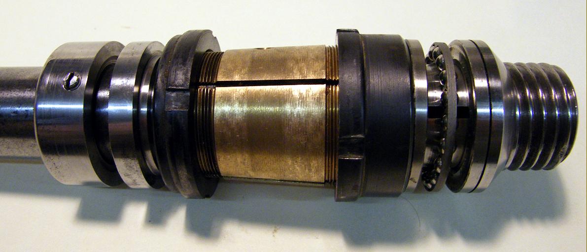

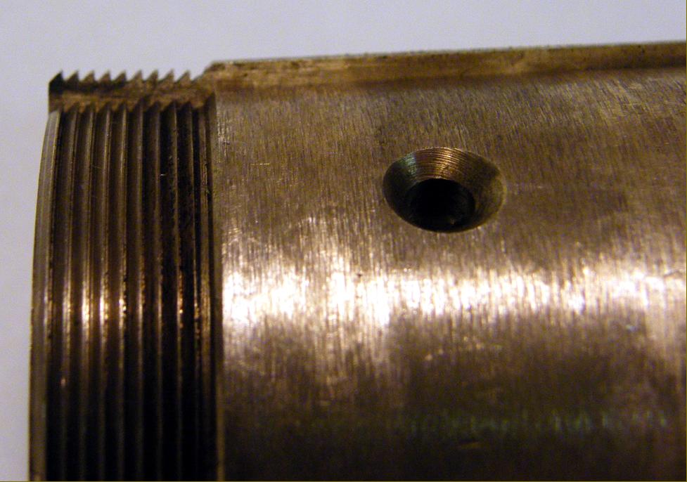

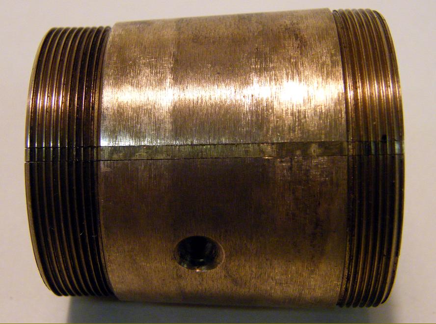

Typical Mikron spindle and front bearing assembly. Note the cone-shaped bearing with buttressed threads - designed to be drawn into the tapered seats of the headstock casting - and the front-mounted end-thrust absorbing ball race
Close-up shot of the bearing's buttressed threads

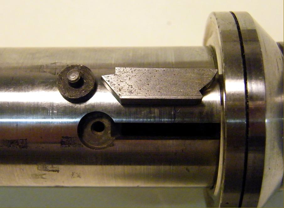

Ingenious, beautifully-made easily-removable key

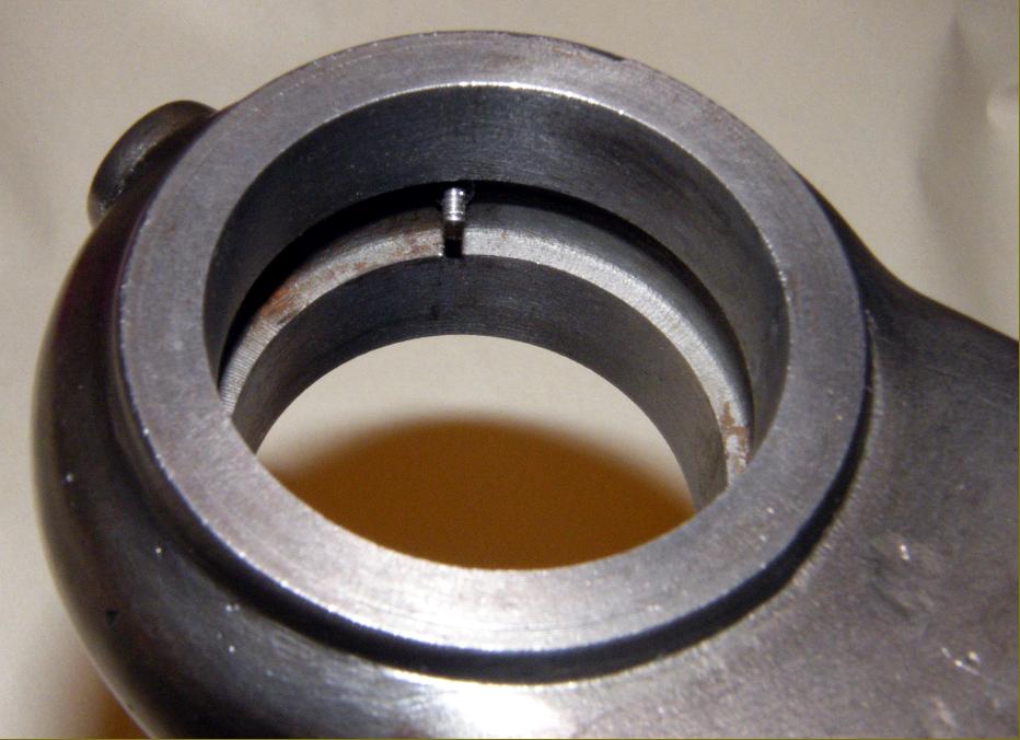

Tapered bearing seat in the headstock casting
