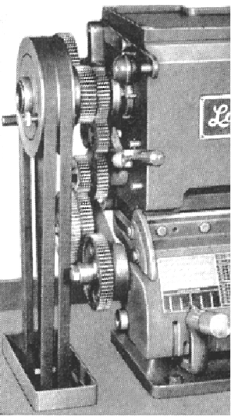

The standard underdrive system used three belt runs to transmit power to the headstock spindle. The first, from the motor, was arranged in a South Bend-like manner with a double-step V pulley on the motor transmitting power via a V belt to a flat pulley on the first countershaft. A standard V belt and pulley arrangement then provided a choice of 4 (rather close) ratios to an upper countershaft - and from there a double V belt took the drive to a pulley on the left-hand end of the headstock spindle.
Twin V belt drive belts to overhung headstock-drive pulley.

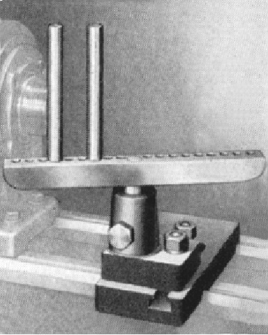

Metal Spinning Attachment to fit the 10", 11" and 12" lathes. The rest was 10" long and fitted to a special plate which clamped directly to the lathe bed.

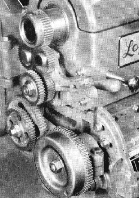

Automatic Gear-train Safety Attachment Designed to fit any Logan lathe with a screwcutting gearbox the unit consisted of a ratchet-like device contained within a drum-like extension to the large gearwheel fastened to the gearbox input shaft. In the event of a ham-fisted operator running the cutting tool violently into the workpiece (or chuck) - or just a build up of loads within the gearbox when generating threads, the overload protection instantly disconnected the drive to the carriage and announced its operation by a clicking noise. The unit would reset itself when the excessive strain was removed from the gear train.
