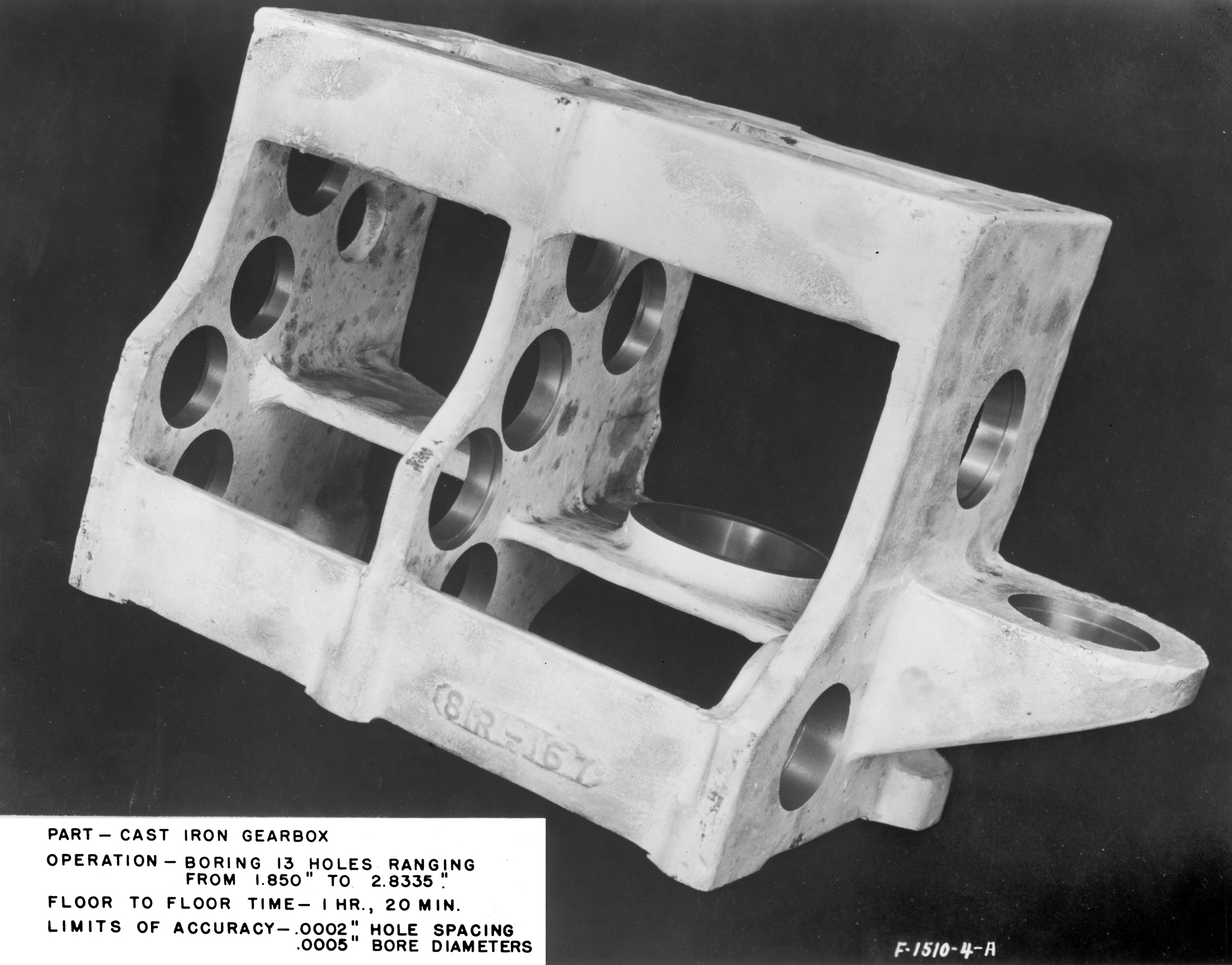

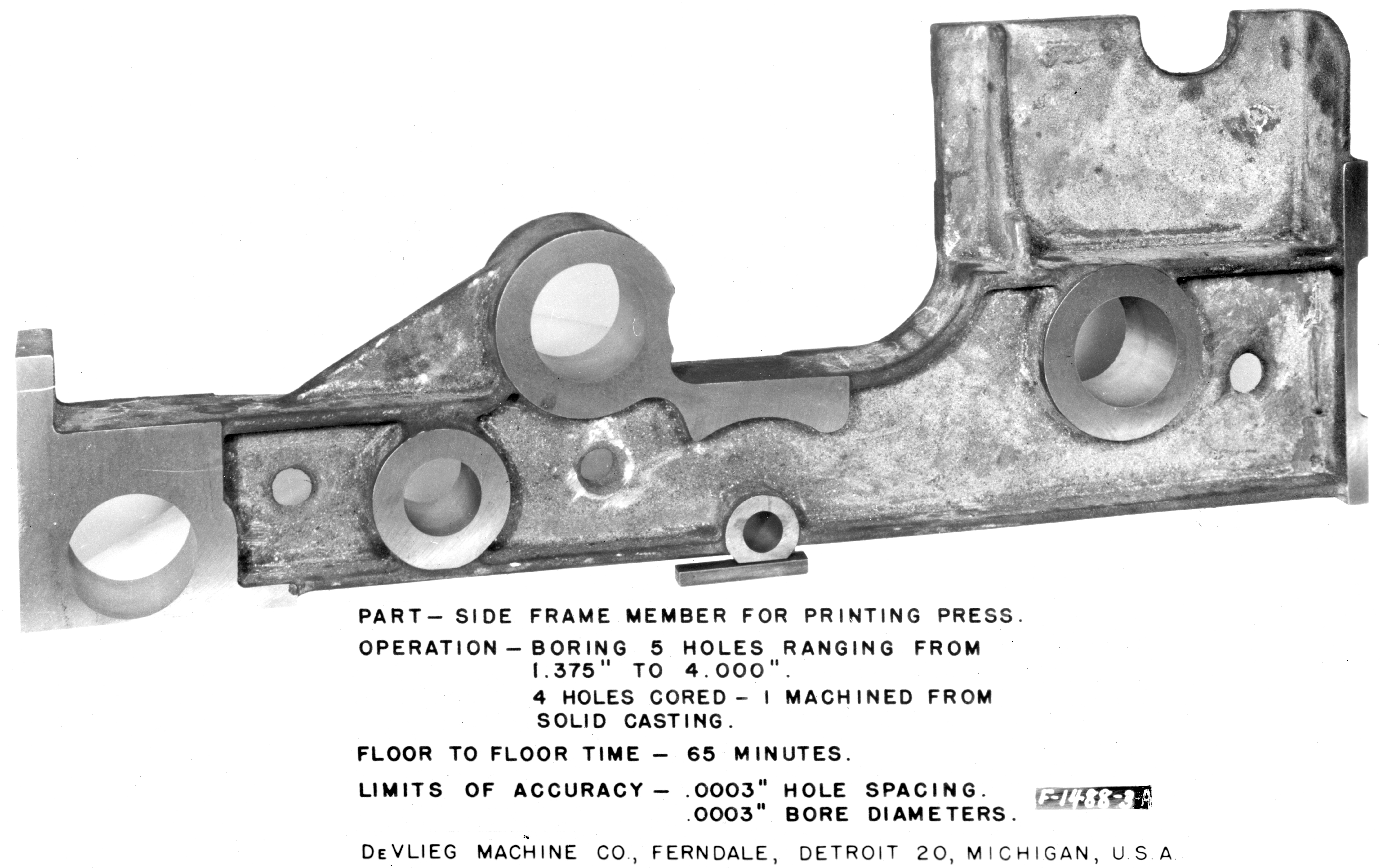

A set of the maker's publicity photographs that show various machining operations on a Jigmil. Most of the pictures appear to have been taken during the 1940s, the machines featured lacking the later pre-selector spindle speed controls and automatic tool retention and release. Being publicity pictures, the accompanying fails to mention (of course) any previous or subsequent machining operations that were needed to finish the job...
