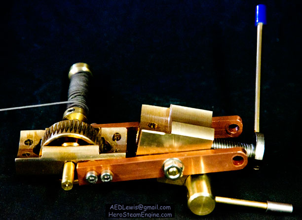

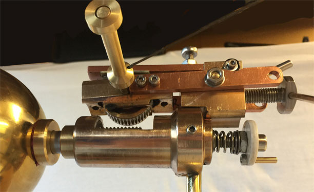

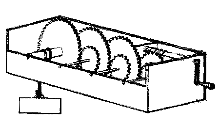

The worm drive gearbox
I made a worm gear that turns one time for every 44 turns of the input shaft. By reducing RPM by a factor of 44 we increase torque by a factor of 44 and this gives it enough torque to operate a crane and lift a weight (power stays the same).
The worm gear consists of a thread (20mm diameter with 1.5mm pitch) meshing with a gear wheel which has 44 teeth. For every turn of the thread it advances by one tooth, so it takes 44 turns of the shaft to make the gear wheel turn once. This type of gear reduction should produce relatively little friction.
This engine was built using a small engineers lathe and during its production a series of YouTube videos were produced, including a very simple method for making the worm drive gear (See YouTube.com/evanecent/playlists and find the playlist about lathes or use the embedded videos shown at the end of this page.)
Photo of attractive gear box for My Hero engines
Click to enlarge the photo
A gearbox was constructed using a worm drive similar to those described by Hero and others in the Ancient world. It is driven by a bronze thread 20mm diameter with 1.5mm pitch. This meshes with a gear wheel with 44 teeth, giving a gear reduction of 44:1. The construction method is remarkably simple and is shown in one of the short YouTube videos at the end of this page (Season 2 Episodes 1 and 2).

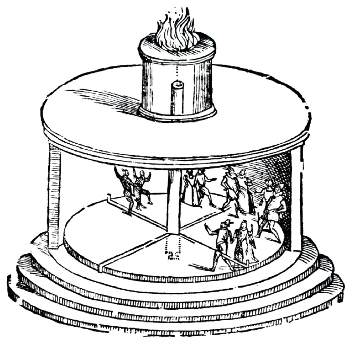

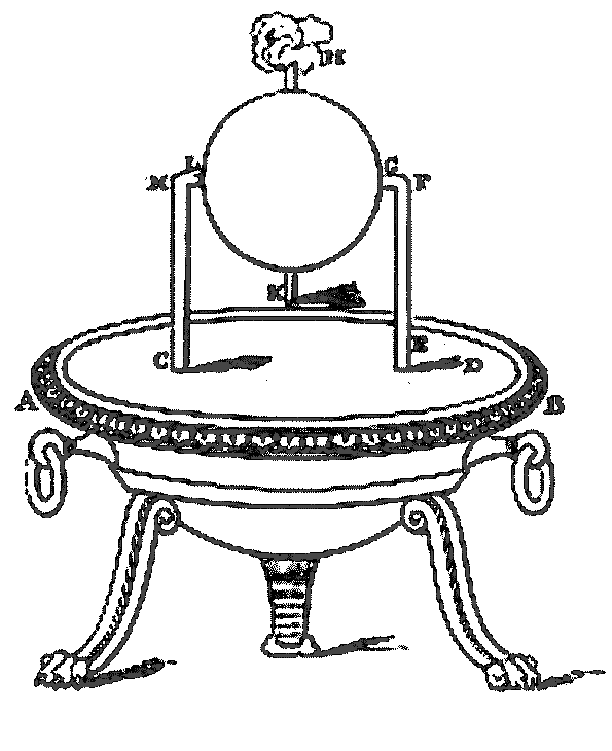

How did Hero’s steam engine work?
The moving part was a spinning sphere with jets placed on its equator pointing along the equator. Steam rushing out of the jets created a force that made the sphere spin. It wasn’t until 1690 AD that Sir Isaac Newton proposed the three laws of motion that we still use today. The third law states that “Every action produces a reaction equal in force and opposite in direction”. In this case the force that causes the steam to rush out of the jets causes an equal and opposite force on the jet itself and that makes the sphere turn. This is the same way that rockets, jet engines and other aircraft engines work.
Hero was the first to write about windmills and he may have thought that the escaping steam was pushing on its surroundings like wind pushing the sails on a windmill, causing the motion of the sphere relative to its surroundings. Hero also described a device with dancing figures on a stage that rotated using the same principal as his steam engine, except that it was driven by air which expanded when heated by a fire (below). Hero used this explanation: “the air, growing hot, will pass through … the smaller tubes [jets]; when, meeting with resistance from the sides of the altar, it will cause the tube and the dancing figures to revolve.”

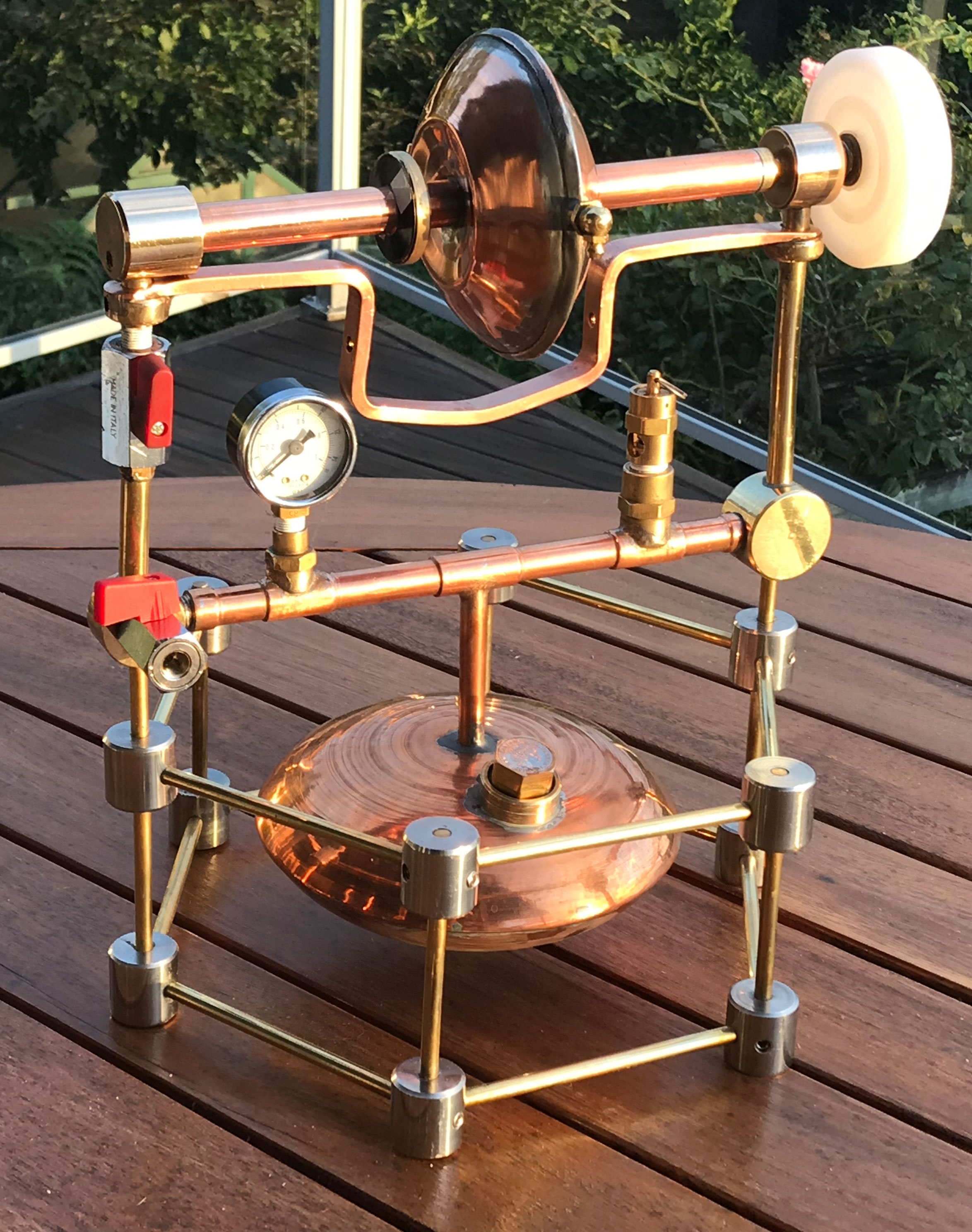

Size and design of the boiler
Versions 2 and 3 of my Hero Engine had a one liter boiler in the shape of a rotated ellipse which looked nice. So that I would not have to interfere with its integrity I suspended it inside a hexagonal brass cage with stainless steel nodes.
A shiney copper tank in the shape two desert bowls joined together.
A close-up photo of the elliptical boiler used in versions 2 and 3 of the Hero's engine.
One of the 12 stainless steel nodes used to create a hexaagonal cage where the boiler could be suspended. Grub screws have been placed in the underside to secure the horizontal rods.
The process of spinning copper from a flat sheet into the shape of a bowl resulted in some nice copper bowls as gifts, but even after softening the copper by annealing I could not form a pair of hemispheres that could be joined together to make a sphere. The copper buckled. I was using a wooden pattern and it probably would have been more successful with a steel pattern but that would have required a large chunk of steel.
Although this worked, the engine quickly ran out of steam pressure. It ran really well on compressed air. The elliptical boiler was one liter and my grandfather’s kettle boiler held 3.5 liters and was able to produce much more steam, capable of supplying large jets of 2mm.
I increased the surface area for conducting heat by passing 17 copper tubes vertically through the boiler. They were attached with Silfos brand rods containing 5% to 15% silver. Hot gases from the propane burner pass through these tubes heating the water rapidly. This produced steam faster than the old boiler without tubes. It also made the boiler very strong.
For safety reasons, rather than making a large boiler I decided to make a new small boiler with increased surface area to conduct heat more rapidly into the water and thus produce steam more rapidly. In Hero’s time the same could have been achieved just by making a slightly bigger boiler with an equally large surface area and using a large fire, but it may not have been as safe, especially with a flat top. This point must be emphasised because the use of the more modern idea of boiler tubes and a propane burner could be critized. The actual method used to produce the steam is felt to be of seconday importance to demonstrating the function and performance of the rotor. I'm sure the Greeks could produce as much steam as they needed, but probably could not handle high steam pressures which exceed 100 psi in modern boilers.
Increasing the diameter of a cylindrical boiler with a flat bottom from 200mm (8 inches) to 350mm (14 inches) is all that would be required (Appendix F) to give the same surface area as my 200mm boiler with tubes, but my lathe cannot handle that size. If the boiler was in the shape of half a sphere like the cauldron in the drawings, the diameter could be reduced even more. The area of a flat disc is Pi.r squared while the area of of half a sphere is 2.Pi.r squared. The radius or diameter can be cut in half by using the cauldron design instead of a flat bottom! Rather than 350mm, a diameter of 175mm (6.9 inches) would give the same surface area for heating the water. Surprisingly this is a smaller diameter than the almost flat bottomed boiler I used. If I build version 5, I might consider this option but I had problems trying to spin anealed copper into a hemisphere on a wooden pattern (see my Youtube videos on spinning copper below).
A boiler tank made of copper
The new boiler with 17 vertical copper tubes to increase the surface area without using a large tank. The dome in the center is a water trap to try to prevent water from entering the system along with the steam.

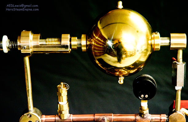

Hero's engine version 4
Hero's engine version 3 after the improved boiler and crane had been added.
Version 4 of Hero’s steam engine with a new spinner
I purchased a light 120mm diameter stainless steel ball from China and made a rigid shaft out of solid stainless steel. I bored 10mm holes from each end of the 16 mm shaft to conduct steam and reduce the weight. (The thinly gold plated inexpensive spheres are used by the Chinese to produce a calming effect and perhaps see the future.)
The gold plated sphere.
Version 4 with its gold plated sphere and improved boiler.
Speed calculated from the sound track
Version 4 ran very smoothly with two 1 mm jets and reached a speed of 3500 RPM while lifting a load of 300 grams to a height of 500mm in about 15 seconds producing 0.1 Watts of mechanical energy. Without any load the speed increased to 5400 RPM measured by analyzing the sound track which showed 10,800 cycles per second as the two jets passed by. This was the highest speed and highest power output recorded.
A graphical representation of a sound track.
This sound track extracted from a video recording shows very clear oscillations as each jet passes by, confirming that it was spinning at a record speed of 5400 RPM - a record breaking speed.
The boiler pressure was maintained so well that the pressure relief valve opened at 15 psi to release surplus steam pressure. This seems to be close to the upper limit of the speed that these machines can produce at this pressure, although bigger jets and even more steam production would, no doubt, produce more power.

Valves Levers and Gauges
My design includes a pressure gauge that shows 0-15 psi and a pressure relief valve which opens to release steam if the pressure goes over 15 psi. In this version I made a single 'stop-cock' valve that could direct the steam up to the rotor, out to an exhaust vent, or close it off completely. Unfortunately it bucked when heated for soldering and was replaced with two commercially available valves, one for the exhast vent and one to open the pipe to the spinning rotor.
How was the gearbox and crane operated?
The original gearbox was designed to rotate so that the output shaft could be tilted down to an angle of 45 degrees to drive an Archimedes screw intended to demonstrate pumping power (above). However, it was modified later to operate a small crane instead, as it would be easier to test varying loads. This required a mechanism for engaging and disengaging the gear by lowering the gear wheel into the thread or raising it out of the thread. This was achieved by mounting the gear carrier frame on a shaft so that it could be tilted by a cam on the back of the unit. Whenever the gear wheel was moved it could be locked into position by a long lever that clamped the shaft.
A strip of copper bar above the gear wheel has a brake pad on its under-side so that if the gear is raised up high it presses on the pad and prevents the spool from turning, and prevents the weight from dropping.
Under this mechanism there is a small white wheel with a brass handle on it. This is the right hand pivot that the main shaft rotates upon. The tip was originally cone shaped but changed to a spherical shape. It is threaded (actually a stainless steel screw) and can be screwed in and out by turning the white knob as seen in the photo with the operator turning the knob. The spring creates friction and stops it from unwinding on its own. The spool for winding the string on the crane has a circumference of 25 mm.
A close-up photo of the worm drive gear box mounted on Hero engine version 4-front view
A front view of the gearbox on version 4.
A close-up photo from above with the various levers labeled.
The plan view of the gearbox and gear engagement mechanism with parts labeled.
Photo of the crane lifting a bottle of water powered by the Hero engine as the operator adjusts the pivots. Pressure Gauge reads 8 psi.
The Hero engine with the crane actually lifting a bottle containing 100 grams of water. The small winch spool has a circumference of 25mm.
The gear engagement mechanism after removal from the Hero's engine.
The gear engagement mechanism removed from the Hero's engine. The blue lever is mounted on the head of a screw which clamps against the shaft, locking the gear engagement into any position.
Underside of the gear engagement mechanism removed from the Hero's engine. The cam at the bottom right is operated by the silver lever and raises the arm by pressing against the copper bar.
The thread of the worm drive after removal of the gear engagement mechanism from the Hero's engine.
Back view of the rotor mechanism. The white knob is for adjusting the pressure applied to the pivots.
The gear mechanism with the gear engaged in the screw thread. The shaft through the gear wheel turns the winch spool to wind in the string and lift the weight.
The worm gear in this image is disengaged and in the braking position.
How did Hero describe his steam engine or aeolipile?
From the English translation by Woodcroft (a).
PLACE a cauldron over a fire: a ball shall revolve on a pivot. A fire is lighted under a cauldron, A B, (fig. 50), containing water, and covered at the mouth by the lid C D; with this the bent tube E F G communicates, the extremity of the tube being fitted into a hollow ball, H K. Opposite to the extremity G place a pivot, L M, resting on the lid C D; and let the ball contain two bent pipes, communicating with it at the opposite extremities of a diameter, and bent in opposite directions, the bends being at right angles and across the lines F G, L M. As the cauldron gets hot it will be found that the steam, entering the ball through E F G, passes out through the bent tubes towards the lid, and causes the ball to revolve, as in the case of the dancing figures.
An old etching of Hero's steam engine
This etching of Hero's steam engine is not from his original manuscript which has been lost. It was probably produced in the middle ages. It shows steam forced out of the jets causing the sphere to rotate. It is heated by a fire. Letters on the diagram match those in Hero's written description.
Another etching of Hero's steam engine.
Another etching of Hero's steam engine also probably dates back to the middle ages.
A third etching of Heros steam engine. It is heated by a fire and in this case there is an image of a man holding the fire under the cauldron which is supported by pedistals in the image of lions.
A third, more elaborate, etching of Hero's steam engine. The shape of the pivot is clearly shown. It is heated by a fire and in this case there is an image of a man holding the fire under the cauldron which is supported by pedistals in the image of lions.
What were Hero’s dancing figures?
Number 70 in Hero’s list of designs in Pneumatica was called “Figures made to dance by fire on an alter”. This worked on the same principal as Hero’s steam engine, but instead of using steam he used air escaping from a chamber as it heated up and expanded. The jets were mounted on the floor of a rotating stage with figures of people dancing mounted on it. Unfortunately in this drawing, most likely from a later manuscript, the jets appear to be pointing straight up or straight down. They should remain in the same plane as the stage floor and tangential to the edge of the floor. Here is Hero's description taken from the English translation (a,o).
WHEN a fire is kindled on an altar, figures shall be seen to dance: for the altars must be transparent, either of glass or horn. Through the hearth of the altar (fig. 70), a tube is let down turning on a pivot towards the base of the altar, and, above, on a small pipe which is attached to the hearth. Communicating with, and attached to, this tube are smaller tubes lying at right angles to each other, and bent at the extremities in opposite directions. A wheel or platform on which the dancing figures stand, is also fastened to the tube. When the sacrifice is kindled, the air, growing hot, will pass through the pipe into the tube, and be forced out of this into the smaller tubes; when, meeting with resistance from the sides of the altar, it will cause the tube and the dancing figures to revolve.
A woodcut etching of Hero's dancing figures.
A woodcut etching of Hero's dancing figures. This works on the same principal as Hero's steam engine but uses heated air (instead of steam) escaping from jets at the edges of the dance floor to make it rotate. The jets appear to be drawn at the wrong angles.They should be in the same plane as the dance floor at a tangent to the floor. (From Wikipedia.)

Another device called the Baroulkos (q) designed for lifting heavy weights was described by Hero and has been reviewed in an article in Scientific American (p). It was operated by a crank which turned a worm gear, which then turned a series of four pairs of gear wheels to reduce the speed of rotation and this increase torque. The last gear was connected to a spool and rope to lift the weight. This, or a similar device, could have easily been connected to a Hero’s steam engine. In fact, my design with a worm gear parallels the design of the Baroulkos and odometers.
A drawing of a winch using gears.
A mechanical gear reduction winch known as a Baroulkos with 4 sets of gears with two gear wheels in each stage and driven by a worm gear. (From Lahanas(n)).
