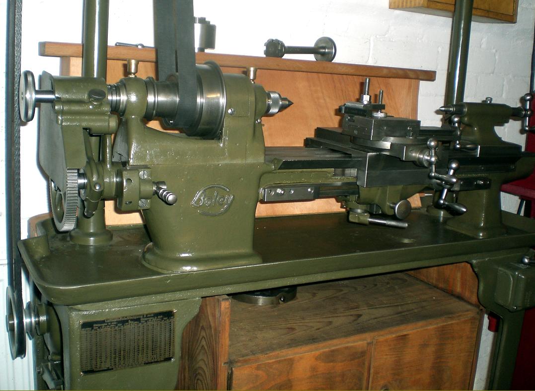

One of G.Boley's most popular and enduring models was built as the Series 3 and 4 - both very similar in construction but with the No. 3 lathe being of 90 mm (3.5") centre height and the No. 4 120 mm (4.7"). Illustrated below (with a photographic essay here of the later, more highly-developed models) these were enormously heavy, cleverly designed, beautifully made and elegant machine tools produced in a wide variety of models and with suffixes such as L, C, L, H, R, CR, BJ, HL, HM, etc. - the designation reflecting a precise specification and level of standard equipment. Production began in the early 1920s - as a plain-turning model with an open-drive headstock and a variety of countershafts for bench or stand mounting drive - and extended to at least the mid 1970s by which time, in backgeared and screwcutting form, it was fitted to a very heavy cast-iron self-contained stand with built-in motor drive. While many 3L and 4L models were produced as plain-turning precision lathes, or set up with lever-action collet closers, capstan heads and cut-off slides for mass-production and second-operation work on small, close-tolerance components used in the watch, clock and instrument industries, large numbers were also manufactured, from the late 1920s, as backgeared and screwcutting models for use in toolrooms and repair shops. On the latter type the leadscrew ran in a fully-shielded housing beneath the bed while the twin "aprons" (they reached down both in front of and behind the saddle to form a particularly rigid housing) were joined together by a casting that supported the clasp nut in a perfect position directly beneath the centre line of the carriage and almost underneath the toolpost. Neatly enclosed within the headstock casting directly behind the chuck the backgear and its engagement system (when fitted) was a masterpiece of compact engineering, if a little awkward to engage on early versions--and a complete mystery if you don't know how. The secret lies in a small pressed-steel lever on the face of the headstock beneath the chuck (used to engage and disengage the gears) and a difficult-to-locate small screw marked (in tiny lettering) "AUS" and "EIN" (in and out) on the side step of the middle pulley. If the screw is turned through 180 degrees, whilst simultaneously oscillating the pulley, a slight "clunk" will be heard as a small spring-loaded pin engages (or disengages) the pulley from the inner (bronze) backgear. With the pin out of engagement the pulley is free to turn on the spindle (together with its gear) and so engage the backgear assembly to give slow speeds. The pushing force for the pulley-to-gear engagement pin was provided by a powerful spring, contained in a housing bored down through the depth of the largest diameter pulley. The tapping was capped by a large, slot-head screw that should be removed only if necessary - and if it is be sure to cap the assembly with a rag to contain the bits as they attempt to fly out. The saddle drive was fitted with an automatic, pre-set disengage to both left and right travel - a most useful facility when taking a long, fine-finishing cut. On some versions of this lathe the headstock pulley ran in its own bearings (concentric to the main spindle bearings) and drove the spindle though a peg - thus relieving the spindle of any loads from the driving belt. The "tumble-reverse" mechanism (to reverse the direction of the carriage feed) was unusual (and very economically engineered) in that the whole of the banjo arm carrying the changewheels was swung through an arc to pick up the respective drive gear. A knurled-finished handle below the left-hand headstock bearing operated the mechanism. The lathe was available in several other short-bed versions - the H, a simple repetition lathe, the PA for polishing, PS for finishing and the G for finishing and re-cutting threads. Several different stands were available, all of simple design with cast-iron legs and either wooden or metal tops. Models from the mid 1930s were offered with the option of a neat under-drive cast-iron stand with the flat-belt final drive coming from a V-belt countershaft unit built into the lower part of the headstock-end leg (illustrated below). The plain turning precision lathes used a very much simpler form of bed than the screwcutting models, although parts of the compound slide and tailstock - as well as a number of accessories - were common to all types and could be easily interchanged. One example of the 3 Series - it might be unique - has been found with a spindle clutch Although the G.Boley company no longer exists their machine tools remain in widespread use through industry, especially in repair shops. A typical example is the Swiss Rhaetische Bahn's locomotive shops at Landquart where a number of late-production, larger Boley machines, including a CNC affair, are in full-time use. Boley vices are everywhere in the spotless shop and, once a year they have a TdOT or open-house day (in case you are ever in the country at the time). RhB manufactures all the parts need to keep their narrow-gauge (1m) engines and rolling stock in perfect working order. Some G.Boley models, both precision pain turning and screwcutting, were re-badged using the name "Swisten" for distribution in the UK while other were copied and sold as the Excel..
Boley Model 3L/4L precision screwcutting and backgeared lathe as first manufactured in the 1920s (photographs here). Tumble reverse was operated by rocking the whole of the changewheel quadrant arm. In later years the 4L was made even more rugged and useful by boxing in the headstock casting to improve its rigidity, modifying the bed, extending the saddle wings forwards and mounting the lathe on a very heavy stand with an underdrive countershaft. Many of the other Boley lathes shown below, the 3C, 3R, 4R, 3BJ, 3H, 3HK, 3HL and 3HM were also gradually improved and strengthened during the 1930s and 1940s. The Boley 4L formed the basis for the post-war English Smart & Brown Model M

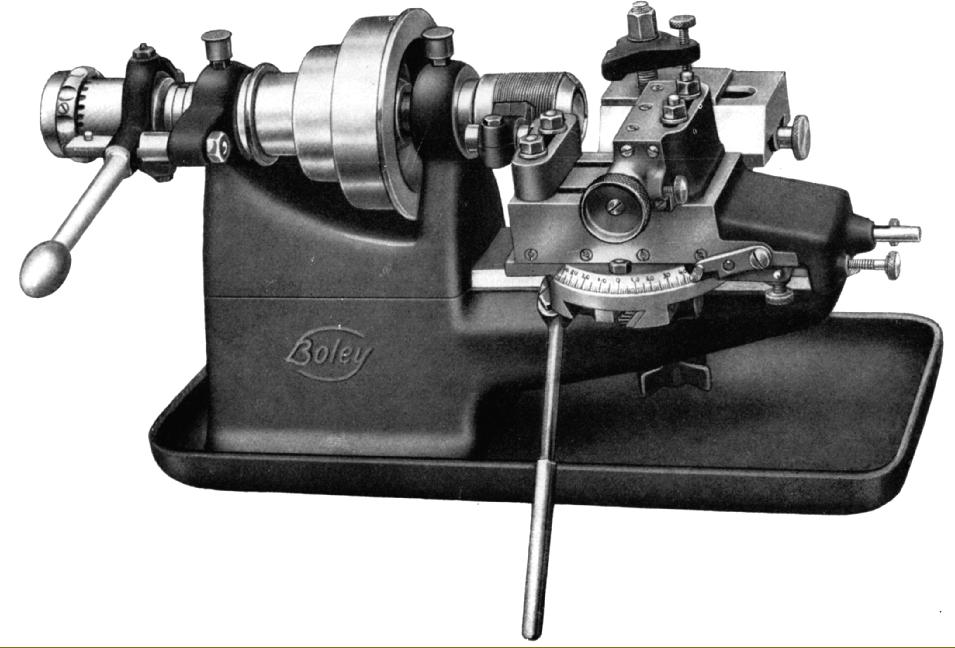

Boley 2HN lathe with lever-operated collet closer and an unusual 6-position turret head on the hand-like tool rest.
Plain-turning Boley 3BJ lathe with lever-action collet closer and a standard compound slide rest

Boley 3L from 1925 complete with the now seldom-found "overhead"
Spindle and bearings from the headstock of the 1925 Boley 3L Backgear was arranged in a manner not dissimilar to that employed on many much cheaper lathes such as the Myford ML2, ML7 and ML10, with the gearing clustered together just inboard of the front spindle bearing - the lower pair of gears being carried on an eccentric shaft below the spindle line. The flat-belt drive pulley was fitted with an inserted bronze gear and could be locked and unlocked to a large "bull gear" keyed to the spindle. However, on the Boley, the details of the mechanism were very much more sophisticated with a spring applying a load to the long, square-headed joining bolt that passed through the whole assembly. Although the mechanism was quick and easy to lock and unlock, the force applied was sufficient to eliminate any play between the parts, an angled flange enabling a snug-fitting joint to be achieved.
