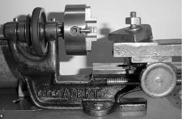

Details of the American company are obscure - but having adopted the English name one must assume that they were set up to either import the lathes and accessories or build them locally under licence (with the possibility that, to aid manufacture, copies of the casting patterns were shipped out). The American model, identical to the Super Adept, was offered with a wider range of accessories than the UK model including collets, a milling slide, 4-jaw independent chuck, faceplate, drive dogs, a hand T-rest, an extended headstock spindle to take a 6-inch diameter speed-reducing pulley, tailstock chuck, cutting and milling tools, a 2-step replica of the headstock pulley, angle plate, Morse centres and a headstock thread mounted on a taper for use in the tailstock. Missing from the collection (but available the UK version, was a countershaft unit. In addition a simple drill press was available - this being shown mounted on a board together with the lathe as a "complete workshop" with each sharing the same neat countershaft drive system. The American seller certainly went to considerably more trouble than the English maker to make the lathe appear an attractive proposition to the home-workshop enthusiast, the 12-page sales catalogue containing an illustrated list of accessories, photographs of typical job set-ups and a suggestion for how the Adept-based workstation might be constructed. Adept USA also listed the same hand-operated shaper as sold in the UK.

Accessories for the USA Adept included collets, a milling slide, 4-jaw independent chuck, faceplate, drive dogs, a hand T-rest, an extended headstock spindle to take a 6-inch diameter speed-reducing pulley, tailstock chuck, cutting and milling tools, a 2-step replica of the headstock pulley, angle plate, wrench, Morse centres and a headstock thread mounted on a taper for use in the tailstock. Missing from the collection (but available the UK version) was a countershaft unit.
