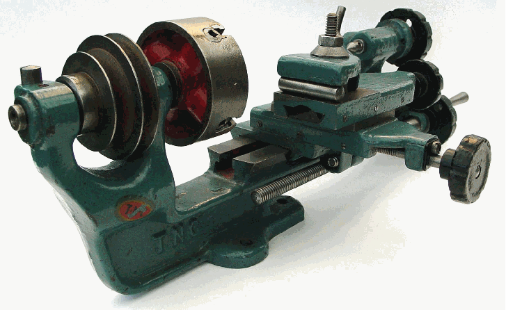

Almost identical to the English "Super Adept" - the Australian-made T.N.C.

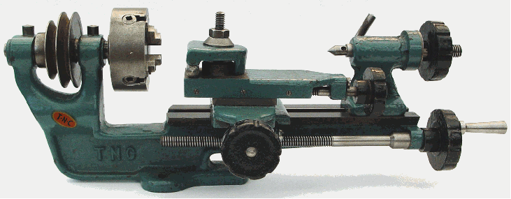

A T.N.C. with a quite different bed, braced at the back with ribbing

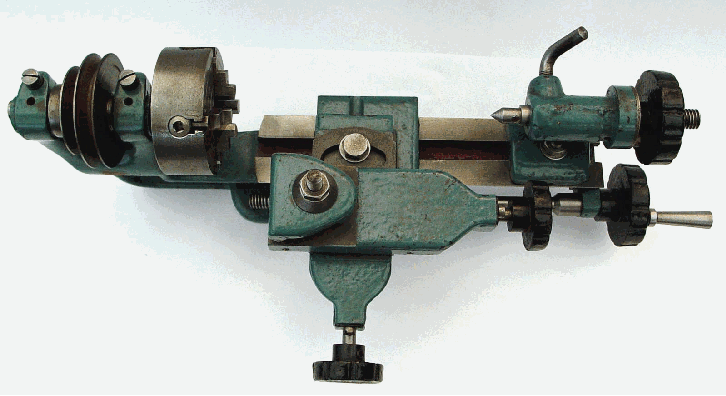

Rear view of the Australian T.N.C. lathe
