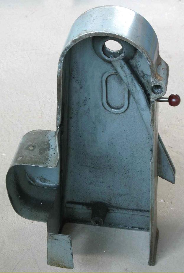

Attention to detail: The changewheel and drive-belt cover included an intricate cast-in drain pipe to catch coolant spilling from the back of the headstock spindle and lead it down to the sump
