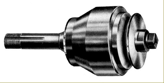

 This design of chuck can take several forms: where the section beneath the nut is plain it can be fitted with a circular saw blade and known as an "arbor" or, obviously, a "circular saw chuck". In addition, the type also lends itself to be fitted with an emery wheel for grinding or cutting-off purposes.  If the section below the nut is conical it will be intended to hold a wheel (a gear in layman's terms) - the conical section automatically aligning the wheel centrally. In this case the chuck would be known as a "wheel chuck".

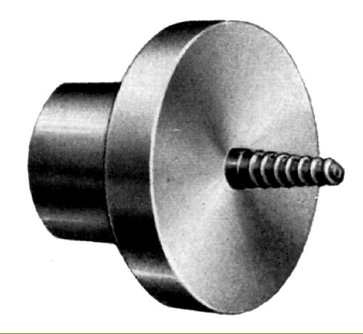

 A "wood-screw" chuck for the gripping of wood or similar soft materials. This type would have either screwed onto the spindle nose or have  been held in some sort of collet adapter/ versions were also made with an integral collet  fitting.

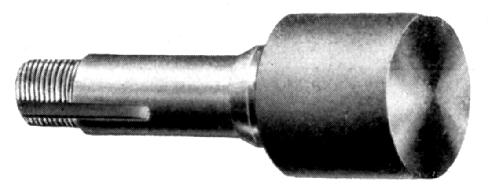

 A "wood-screw" chuck  with an integrals collet shank

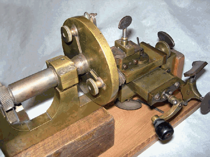

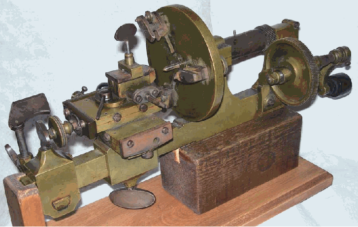

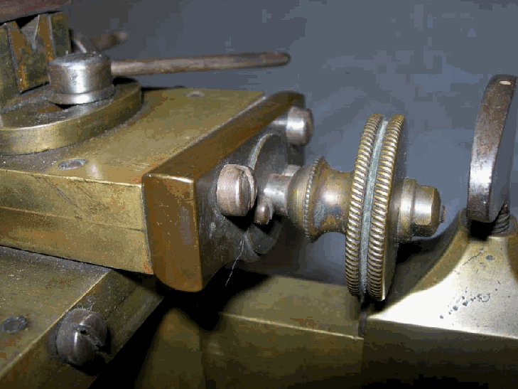

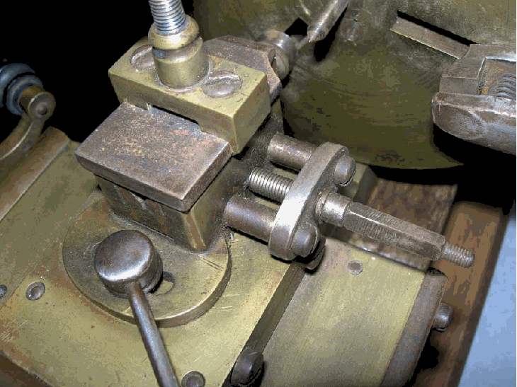

 As can be seen from the fact that type appeared as an engraving in 19th century catalogues, the compound slide rest assembly has long been a desirable accessory to accompany any watchmaker's lathe. This model is designed to fit the bed of a WW lathe
 Even the lighter round-bed Geneva-pattern lathes could be fitted with a compound slide rest - through this fitting on that type of lathe is rather less common

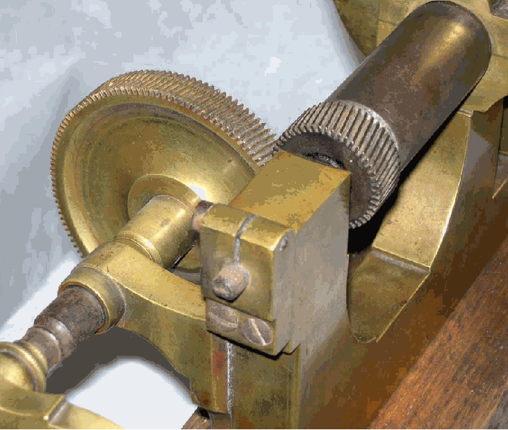

 Another long-established watch lathe accessory - a faceplate with integral, finely-adjustable clamps (arrowed) to hold work. Faceplates came in two forms: one that could be removed from lathe and another built as part of the spindle and supplied complete with a headstock - this arrangement ensuring the greatest possible accuracy.

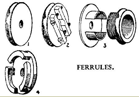

 "Ferrules" - these are pulleys adapted to hold and turn work in the lathe. The basic type is a simple brass plate (No.1) to which a job can be glued. No. 2 carries a clamp on its face closed by two screws. To hold balances, the screw type No. 3 is used while No. 4 is a special spring type to hold a balance.

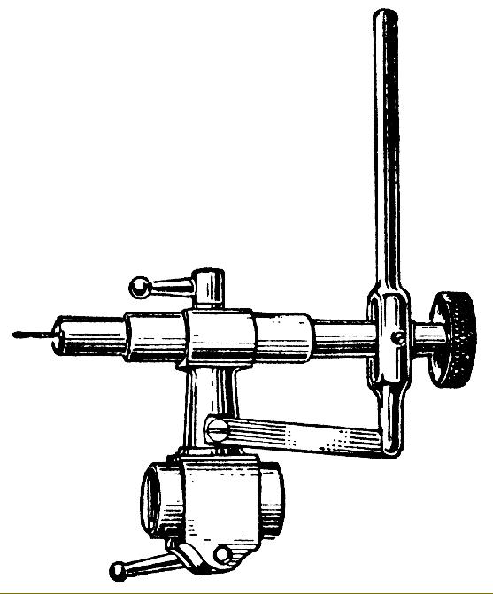

 Tailstock with lever action - this provides a better feel on small drill bits than with a screw-feed mechanism
 Miniature versions of tailstock fittings used on larger lathes. Top: a V-pad against which round components can be held while machined or drilled from a headstock held drill or cutter.
  Middle: a plain drill pad
  Bottom: a miniature drill chuck to hold very tiny drill bits

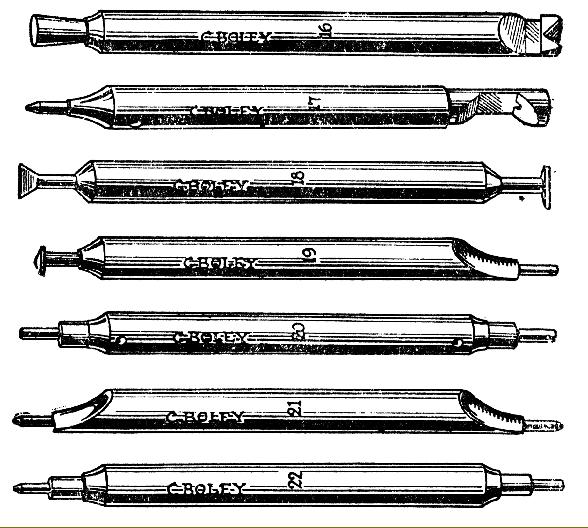

 "Gravers" - used for simple hand turning using a graving rest - often a flat surface along which the tool could be slid and otherwise manipulated. The cutters are usually attached to wooden handles - for obvious reasons - and do require considerable skill to use effectively. Many watchmakers and repairs prefer to use a very fine-feed slide rest to control the cutting tools but many still persist with the ancient  craft of hand turning.
