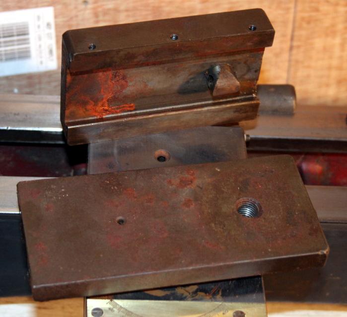

The top slide as found. Note the crisp thread for the toolpost clamp and lack of damage around it, further evidence that this is a lightly-used machine
