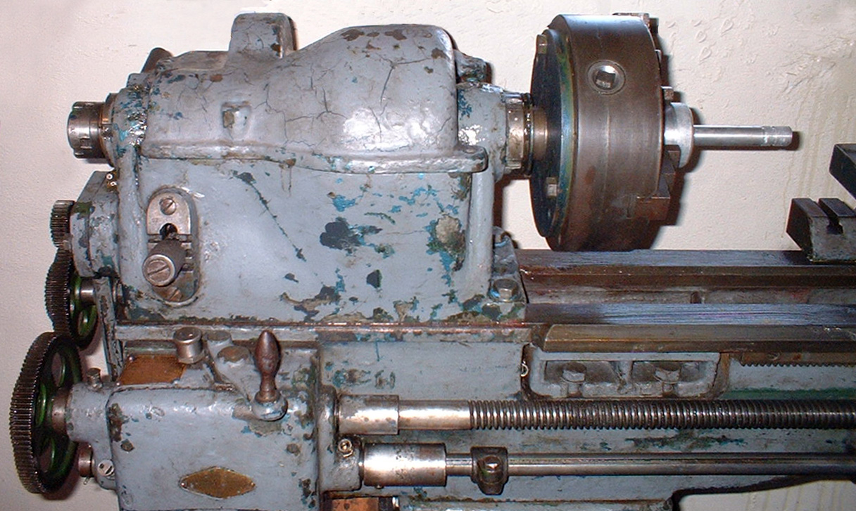

Although not fitted with a full screwcutting gearbox the Trident had a 3-speed box that provided 3 pitches and 3 rates of sliding and surfacing feed for each setting of the changewheels.

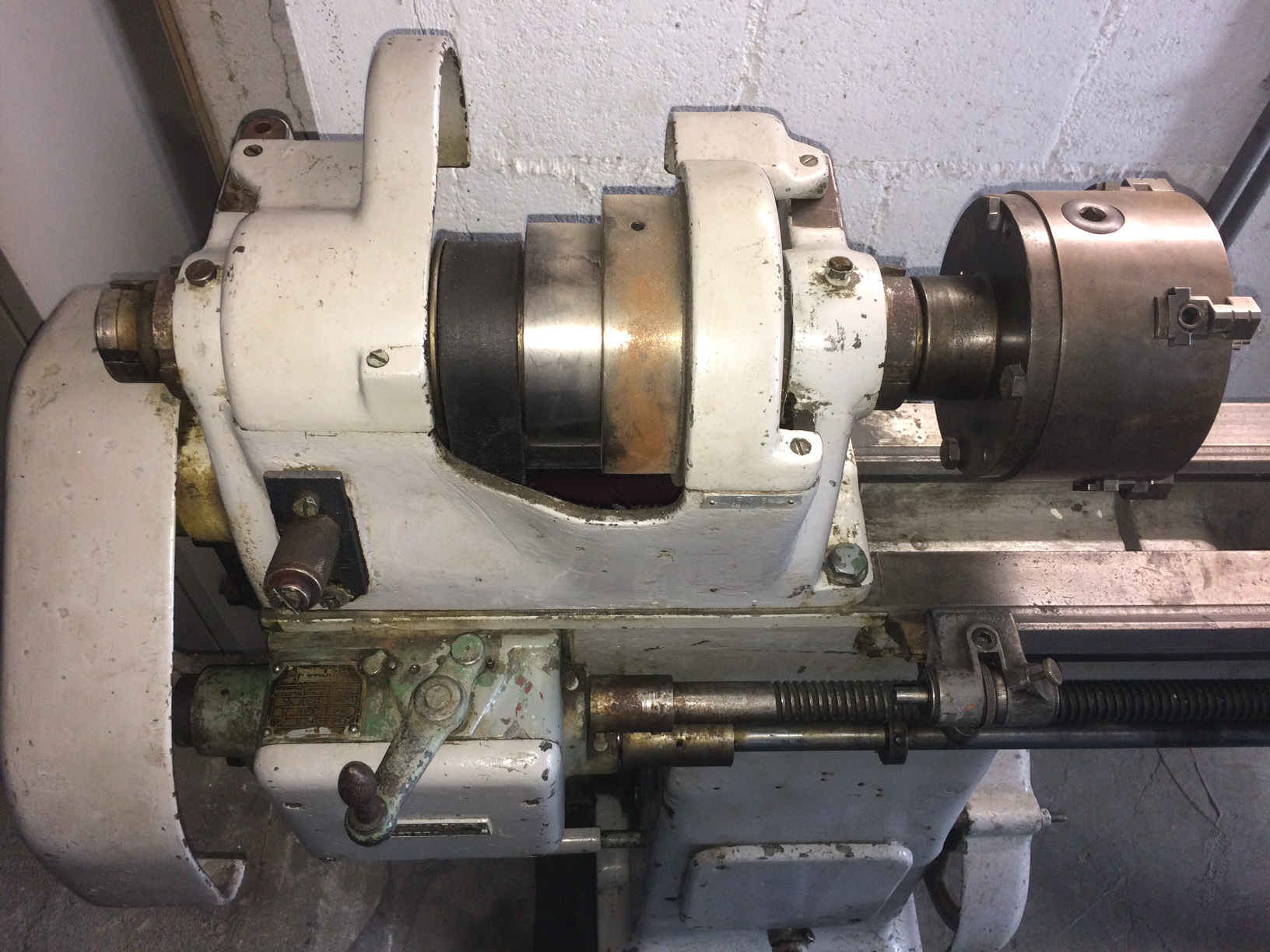

Helical backgears - pointing to a machine of better-than-usual quality - with adjustable, draw-in bronze spindle bearings. Note the designer's choice of a 1-step pulley (that to the left is not used) reducing the number of spindle speeds but allowing the use of an unusually-wide flat belt.

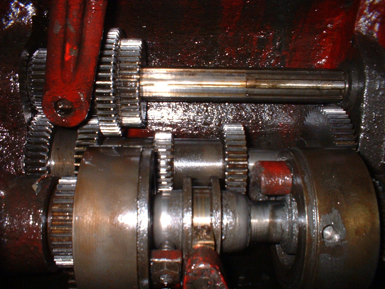

Inside the 3-speed spindle-speed change gearbox showing (foreground) the forward-reverse clutch mechanism
