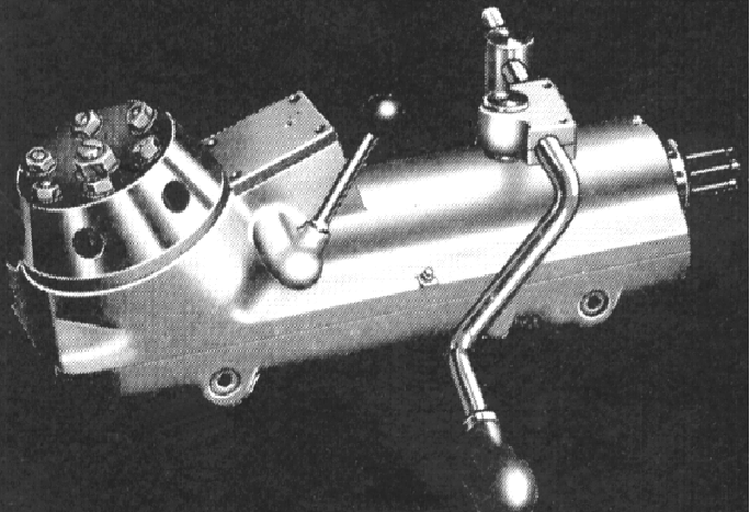

6-station bed-mounted capstan unit for 3/4-inch stem tools
