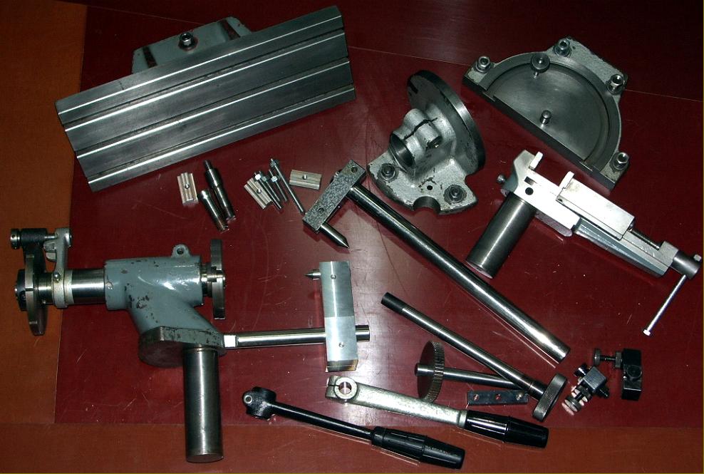

Sixis 101 fitted with a very rare indexing attachment. This unit was originally indexed by an external gear wheel but the owner has added a 40 : 1 worm-and-wheel gearing together with suitable degree and minute dials. The work took a not inconsiderable ten hours to complete.
Note the very large dial on the end of the dividing unit's rotating spindle
