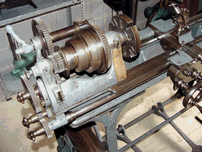

Part of the magnificent Dennis Turk collection in the U.S.A., this particularly fine and original Seneca Falls "Star" can be easily distinguished from later models by the bulges at each side of the apron. Happily a number of accessories have survived with the machine including the dangerous slotted faceplate-cum-driveplate and an unusual combination of steady rest and toolpost designed to support slender work whish allowing the operator to apply a cut by using a screw-feed from the rear.

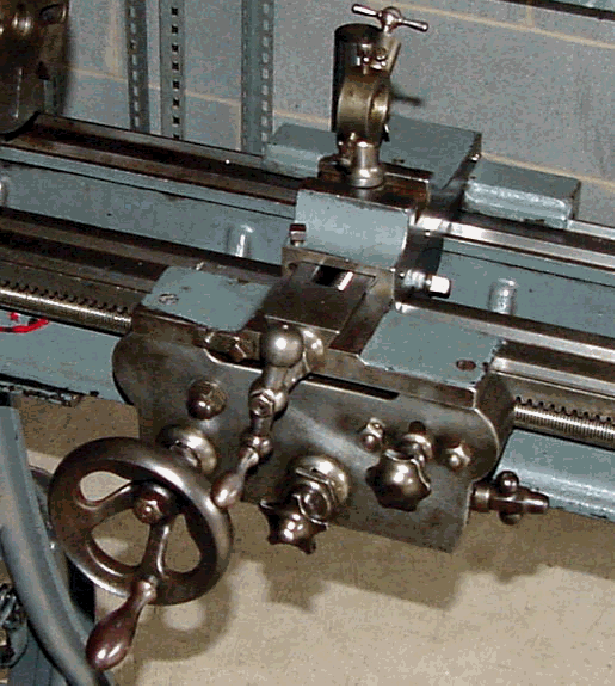

This well-preserved machine retains its original full set of changewheels, faceplate, centers, drive dogs and chucks (although the original and now rare 3-jaw, non-geared scroll chuck that came with this lathe was donated to the Museum). Still in good shape and regular use, the lathe is fitted with an antique Skinner 4-jaw chuck (with very dangerous, protruding adjusting screws), that bears a patent date of November 17th , 1891 together with a Cushman tailstock chuck patented December 24th , 1872.
Fitted originally with a difficult-to-disengage, positive-drive, toothed-type power-feed clutch on the apron (the awkwardness of the arrangement being compounded by having turn the control knob in the same direction that it was rotating to release it) the owner replaced this with a quick-release lever..
