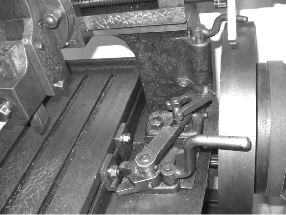

Above: table drive in neutral
Adjustable stops running in a T slot along the edge of the table engaged with a tumbler mechanism that was tripped by stops fastened to the edge of the table; a handle was provided to give manual override and independent operation where a job was nearing a critical phase. The cutter head was indexed along the beam by a ratchet driven by, and interconnected with, the table feed controls.
Two parallel shafts and dog clutches provided the table reverse mechanism - and this was arranged to provide a gradual, shock-free take up.. Note, on the nearer ratchet, just below the Hass "Eureka" patent  stampings, a large cut-out, Into this is fitted an enormously powerful, C-shaped spring - pinned into position at one end -  that slowed down the engagement motion.

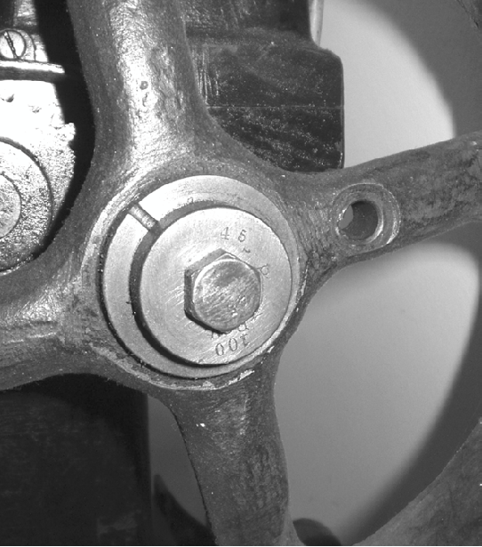

The stamping near the centre of the pulley wheel indicates a maximum speed of 100 rpm.
